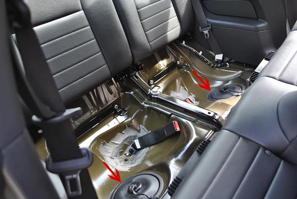

Does anybody know what the plastic things under the rear seat are?
I'm about to dynamat the area, and am wondering whether or not these should be covered up?
Attached Thumbnails What are the plastic things under the rear seat?-underseat.jpg

Your fuel pumps are under those covers. I would cut the dynamat around them just in case you need to access them in the future.

I cut a circle pattern out and put Dynamat over them. I was able to install the GT500 fuel system a year later with no issues from the Dynamat.

Excellent, thanks guys.
It definitely didn't look like something which should've been sealed over with dynamat.
