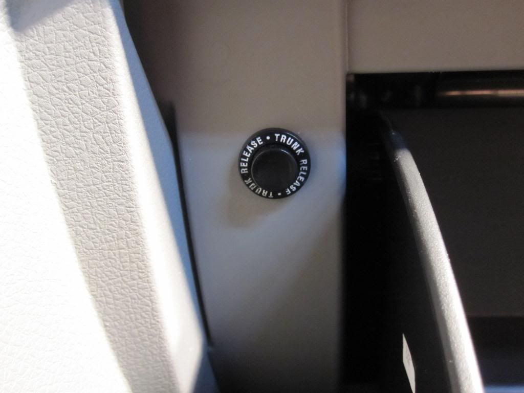

I just installed Ford switch D3AY-19C542-A last week. It is a pretty neat and simple mod:
21
