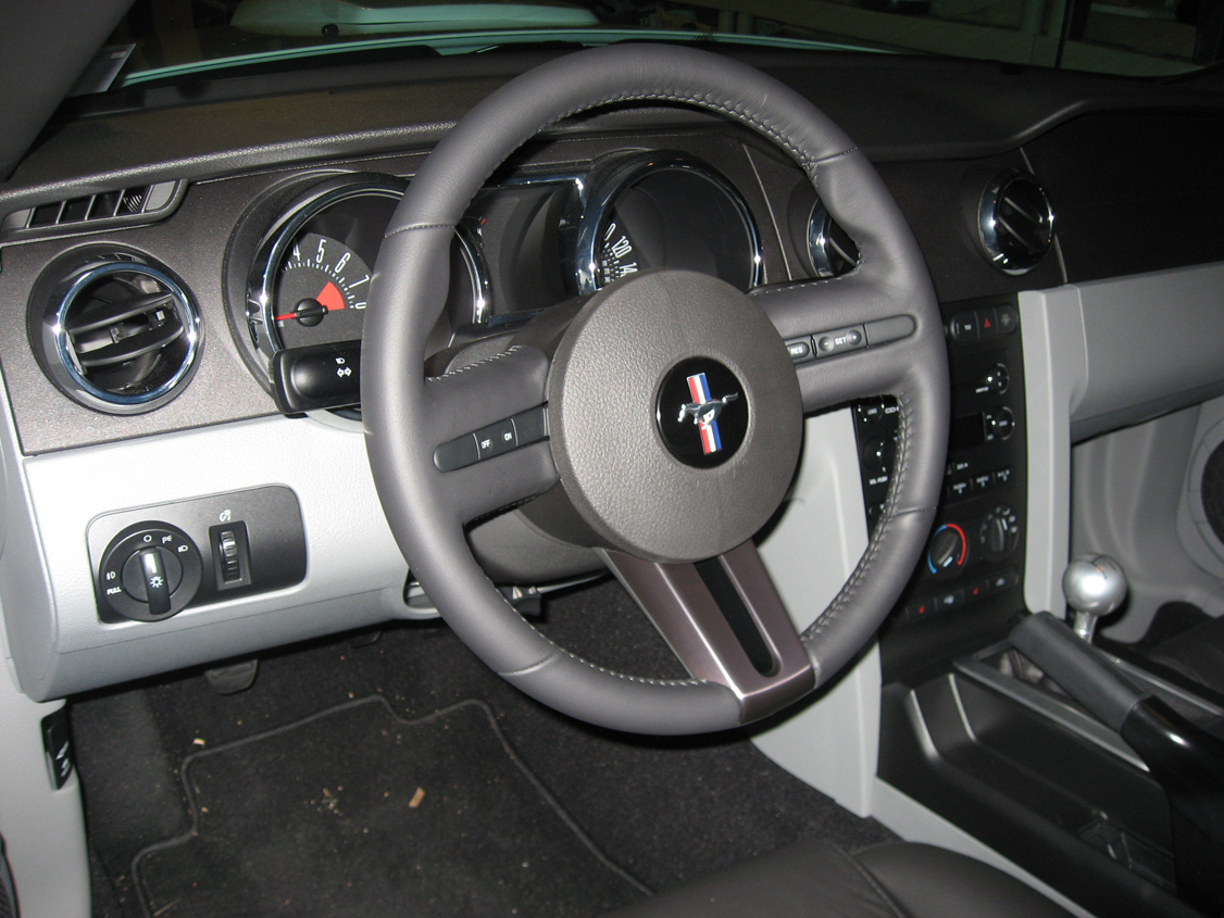

Well got the Bullitt Steering Wheel Installed today, not as difficult I thought it would be.
It looks great and feels great too and goes really well with the bullitt shifter and boot.
Thanks to TMS and the great instructions posted from members, nearly anything is possible to Mod!
Thanks everyone !!
