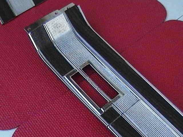

I find the quality of your work very high, and your to market attitude exceptional. Having seen what you're doing with interior and exterior pieces, I'd like to throw an idea to you... a lot of us Mustang owners had 60s and & 70s Mustangs, and one of the things I liked about my 65 hatchback was the console. The new 06 console is lacking in any type of design element. For those of us who show our car at shows, having something more similar to:
Would be awesome. I know that it would not be a cheap product, but I'd like to add a more old school feel to my interior, and some sort of piece that I can 3M onto my current console that has styling queues from this would be the cat's meow.

Danny,
Are you looking for a combo woodgrain / aluminum type applique? Woodgrain is not a problem, I can get the B&I or Woodview kits. If you want a mix though like the one pictured, with depth in the aluminum part, that's a pretty tall order.
Those things were normally die-cast metal, which was then plated, and then the woodgrain decals were applied over top to hide the metal you didn't want shown. To do something similar nowadays in the US would be difficult and expensive given the size of the part, shape, etc. I'm not saying we couldn't do it, just that I don't know how many people would want to pay for it. It might become a project "down the road" when we have some working capital to play with though.
FWIW, I do like the idea. (even if my 73 doesn't have anything like it, I did like some of the interior bits on the older ones)

Not looking for a woodgrain as my interior is the charcoal/red two tone. I think that even doing a plated plastic piece that looks like the IUP with ribbing like that and the insets charcoal or black, that might work nicely. I wonder how much having a 'one off' done would run me????
