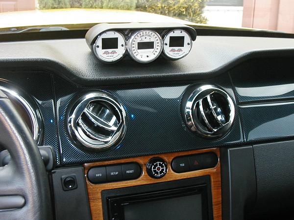

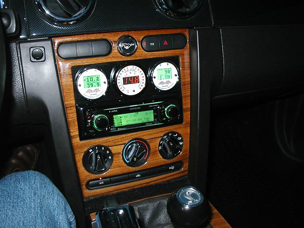

Here's a couple of pictures. The first one is an old one when I had the CDC on the dash and the vent pods , the CDC overlaps the A/C vent so the wires go through there and there is no drilling. The second picture is the current one I have and is the SOS panel , you can get the gauges on either the top or bottom ...

I liked your old setup better. Why do you have a volt gauge?

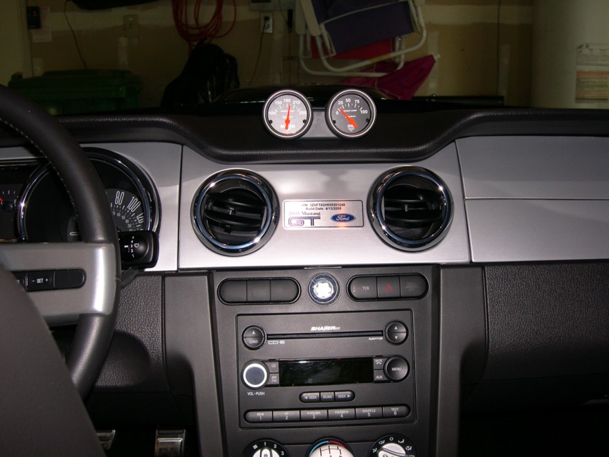

Saleen pod with old school Autometer gauges.

Hey guys
Did you do the installs yourselves? I'm leery of drilling into the dash and heard it's a pain to get the Saleen in correctly. It also doesn't seem deep enough for my Ford Racing Auto Meter gauges.
Any advice??

I did my install myself. Doing the Saleen pod is not difficult *IF* you have one tool: A small 90 degree drill. You can't use a standard drill because the windshield gets in the way. I picked up a cheapie 90 degree air powered drill for about $20 at Harbor Freight
My Nexus gauges were too long for the Saleen pod. I simply made a paper template and carefully trimmed a recess with a dremel under the Saleen pod on each side so the rear of each gauge can nestle below the dash surface (hey, once you start drilling holes, what's a couple more )
I REALLY like the Saleen setup because once it's in, it looks totally factory, not like an add-on.

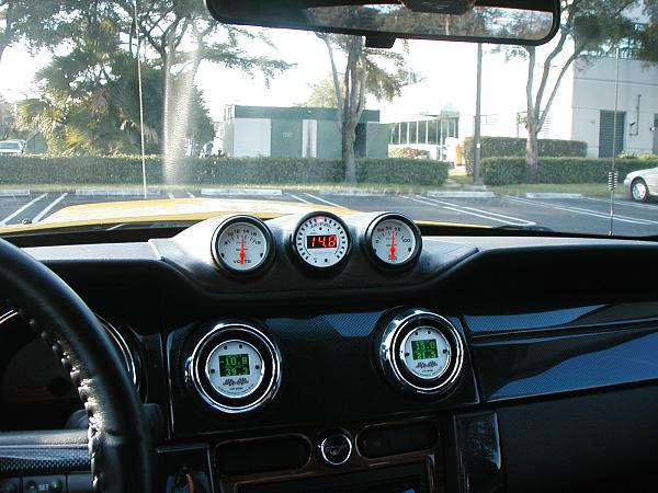

I recently put the BOSS 302 gauge pod in ...
