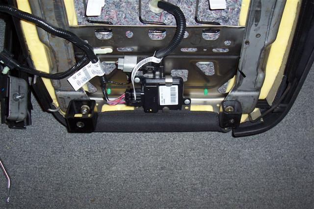

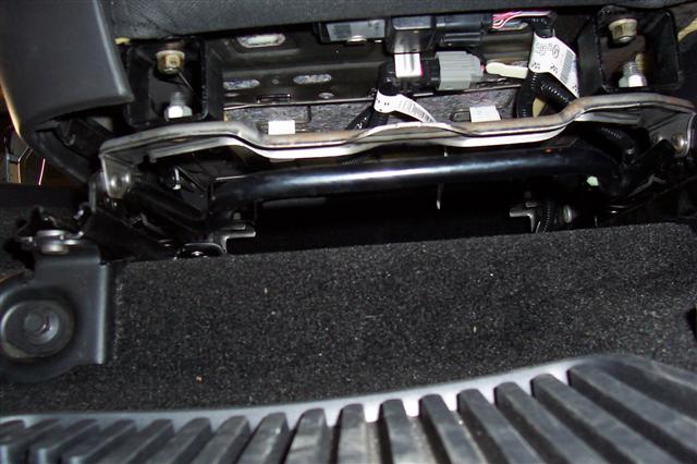

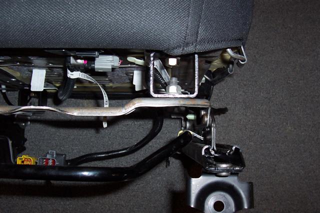

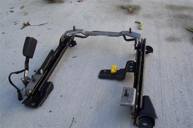

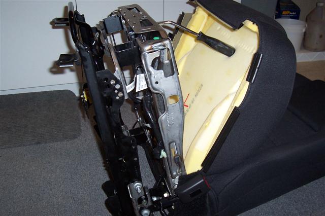

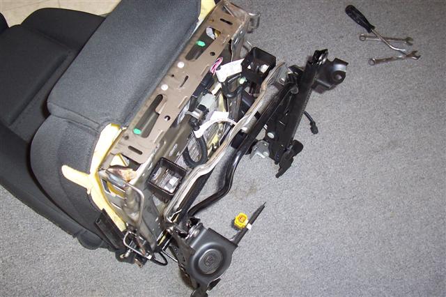

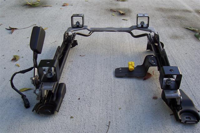

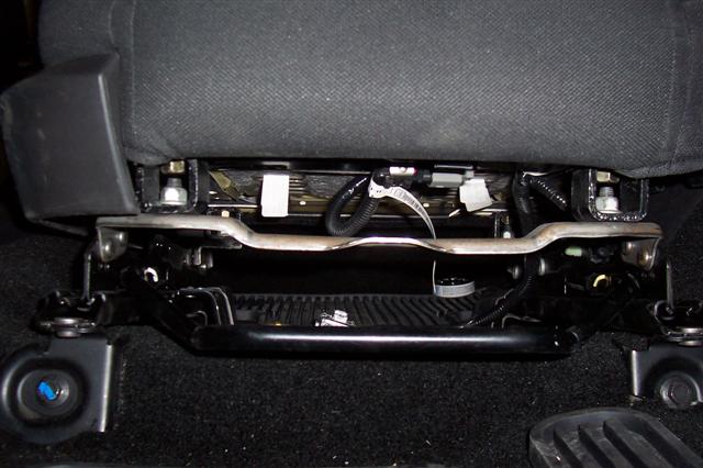

Think mine looks better, and did not have to ruin my seat...can put it back like it was....here are some pics
Attached Thumbnails S-197 Mustang Options For Raising Passenger Seat-100_0821-small-.jpg   S-197 Mustang Options For Raising Passenger Seat-100_0826-small-.jpg   S-197 Mustang Options For Raising Passenger Seat-100_0829-small-.jpg   S-197 Mustang Options For Raising Passenger Seat-100_0836-small-.jpg   S-197 Mustang Options For Raising Passenger Seat-100_0850-small-.jpg

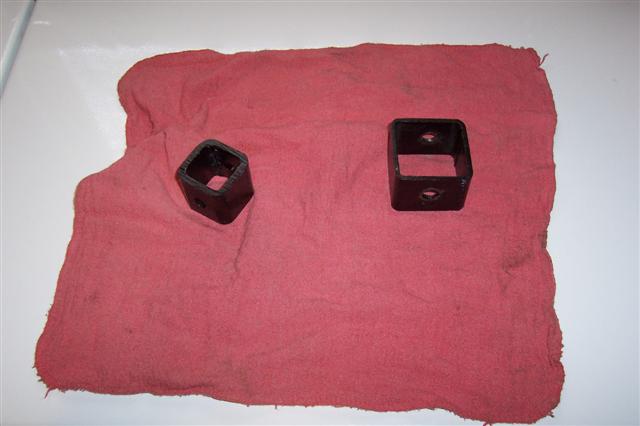

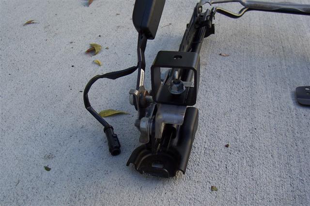

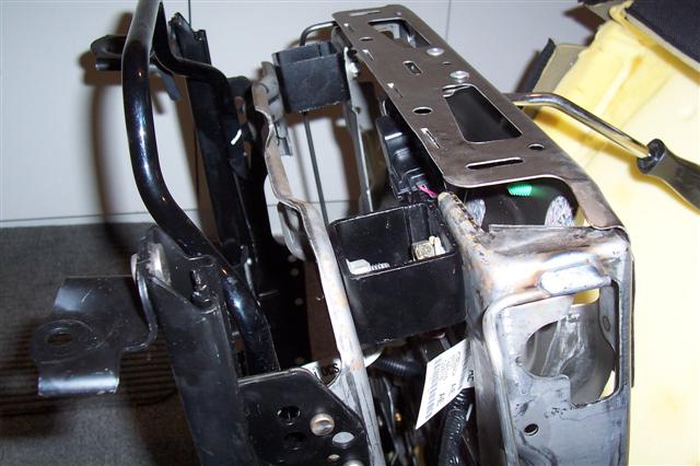

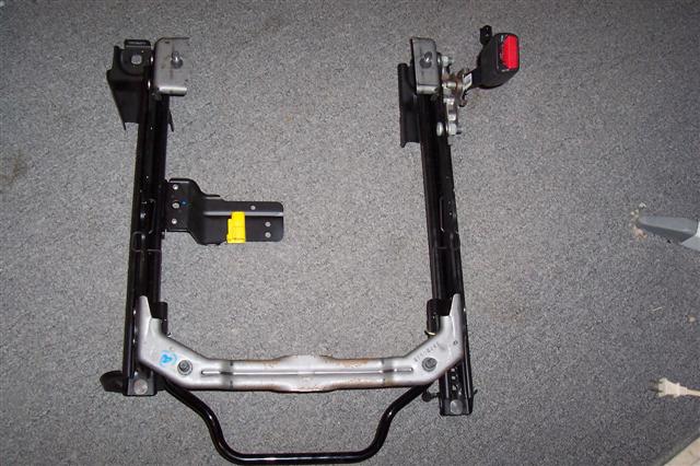

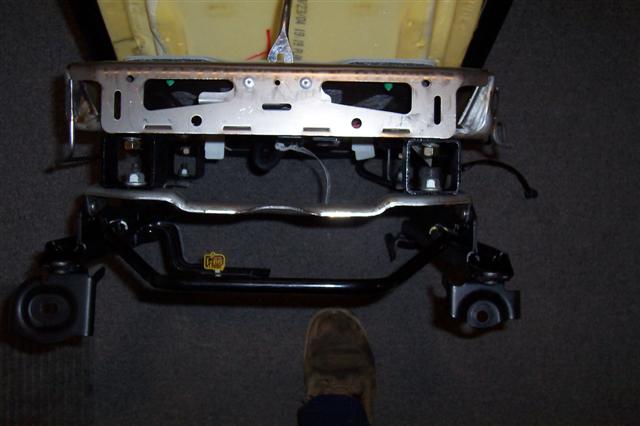

oooops
Attached Thumbnails S-197 Mustang Options For Raising Passenger Seat-100_0830-small-.jpg   S-197 Mustang Options For Raising Passenger Seat-100_0828-small-.jpg   S-197 Mustang Options For Raising Passenger Seat-100_0804-small-.jpg   S-197 Mustang Options For Raising Passenger Seat-100_0827-small-.jpg

I'm not engineer by any means, but aren't you guys worried about the structural integrity of those brackets under a full impact accident? Especially when you have airbags deploying? I don't know...just seems like it wouldn't be very safe.

That's exactly why I'm just going to retrofit an actual power seat. All of the other part numbers for the '07 are the same... the seat frames, cuision, etc.... it's just the seat base that's different.
Looking at the material being used-I would think there should be no problem-especially the way Fake has his box channel oriented. The material is of a thicker gauge and having the box oriented north-south should allow for more than adequate shear strength.
Old Nov 3, 2006 | 04:39 PM
fake68's Avatar
Joined: October 27, 2006
Posts: 11
Thank you...I used 3/8 grade 8 bolts up top and same seat bolts on bottom..any engineers out there? Seems ok to me
What if he got T-Boned? Wouldn't those brackets bend? I'm not trying to knock the mod, hell, I'd do it myself if I felt it was safe...it's just not giving me a warm fuzzy.

Old Nov 8, 2006 | 04:12 PM
fake68's Avatar
Posts: 11
1/8th inch thick 2 inch square tubing...cut 4 sections 1-1/2 inches wide...drill 3/8 hole on top and bottom of each piece...bolt each square section to bottom seat frame with the nuts that used to hold the seat down...then bolt seat to square tubing with 3/8 grade 8 bolts and nuts..leave every thing loose untill all bolts and nuts are on.then tighten seat first then frame...
Attached Thumbnails S-197 Mustang Options For Raising Passenger Seat-100_0825-small-2-.jpg   S-197 Mustang Options For Raising Passenger Seat-100_0816-small-.jpg
Old Nov 14, 2006 | 12:01 AM
snkysnake's Avatar
Joined: August 21, 2005
Posts: 10
Good job fake68... I guess I gotta ask tho , how did I ruin my seat? To restore it to "normal, remove box tube , Install grade eight bolts in original holes. I thought of doing it like you did, but I thought (in a wierd way) that if there was a "sheer strenght" problem, two points of potential failure would be better than four. I had a brief conversation with a navy engineer, and he said that with thick wall tubing and grade eight bolts he thought the seat would survive all but the guys with the jaws of life. I guess if you really wanted to commit to this mod, and were really worried about it letting go in a really bad wreck.. do the mod , with either two or four tubes, and then weld the sucker. I did my mod as a permanent fix, when I trade this one in, I'm sure not gonna ask if the dealership wants the seat lowered ! LOL Bottom line Fake68 , you fixed a problem that lots of folks have complained about, and your passenger appreciates it. !

Hey Snake, (ruined my seat) bad choice of words The 2 extra inches sure makes a difference though don't it.

yep world of difference , wife is as tall as me now , dang it.. BTW if anyone finds that two inchs is too much (pun intended) try using inch and a half by inch and a half. I kinda wish I had , then the wife wouldn't be looking me in the eye.
