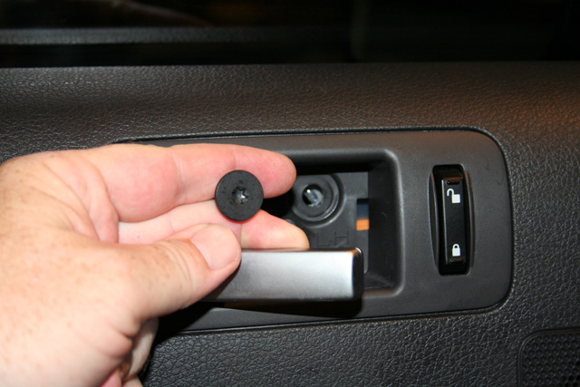

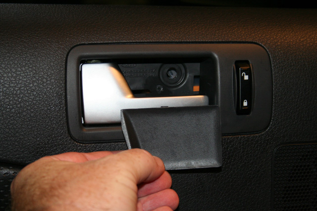

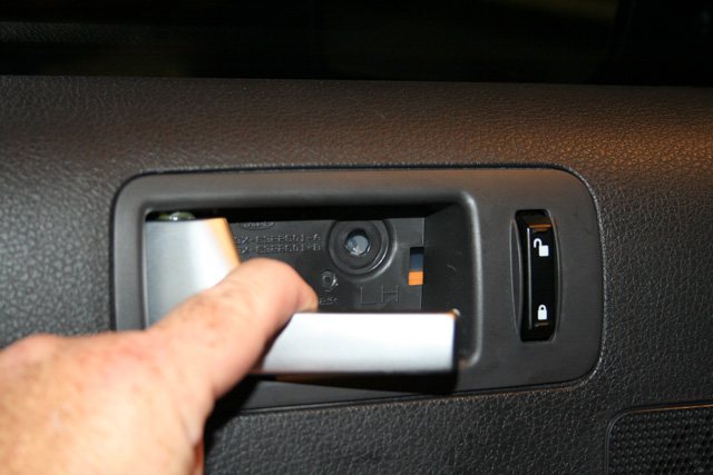

Can someone explain this in more detail for us? What is the Door lever plate?
Also does the 06 have this same screw?

Yes.. right behind the handle on the door pannel (not the lever to open the door, but in the center) there is a panel that you have to take a flat screw driver and pry it out. It comes out pretty easy. I'll see if I can put up a pic for you.
pic is gonna have to wait... so if anyone else can get it done quicker.... feel free.

Pics of the bolt I was talkin about, after you remove this one & all the ones arount the door panel, you can then lift & pull the top of the door panel away to remove the wiper channel assy.

Thank you VERY much for the pictures. I checked the Door Panel removal and installation diagram I include in the kit and it shows the bolt behind the door panel as shown above.
I will make sure it is clear in the main instructions before you come to the diagram.
