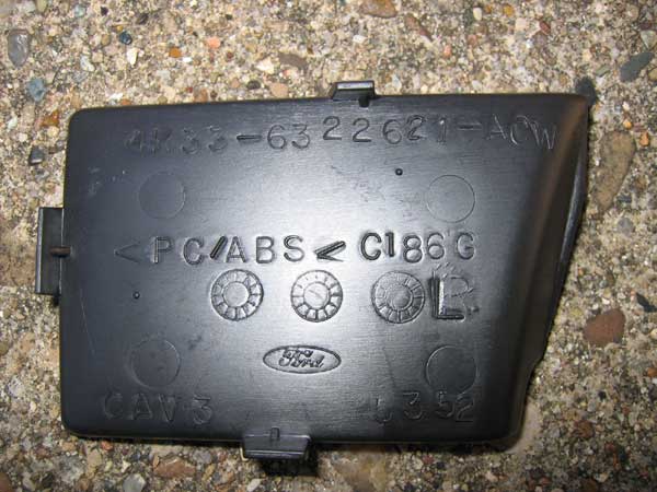

1. Remove the cover from behind the interior door handle.
This was the most frustrating part of the process. Using a small flathead you need to pull up/off the plastic cover. I found that starting from the top back worked reasonably well. I’ve included a picture of the back of the cover for reference on how it’s attached.

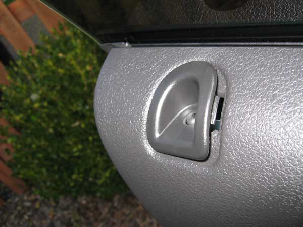

5. Remove the plastic cover over the door lock.
This piece comes off easy, just use the flathead to push in the plastic connector.

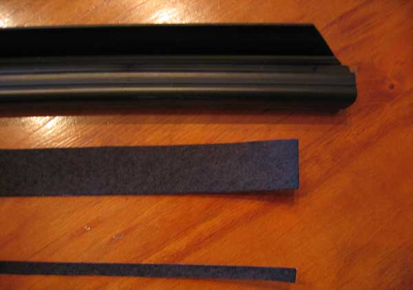

8. Cut the mole skin to size.
The mole skin comes in one long strip that you will need to cut to the right length for the track. Just lay the strip over the track to measure. I also noticed that the height of the mole skin was taller than the track. I used a ruler to mark off about a ¼ inch of the strip and cut that off.
