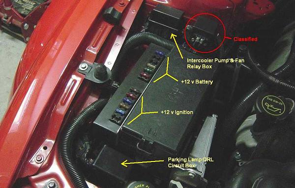

Now onto the S197 gauge pod.... I needed a blank panel for my switches / ***** / momentary pushbuttons / LEDs, etc. but could not find any place where it would look built-in. With FIVE switches and FOUR indicator LEDs already installed in the upper "console", I needed more room.
I removed the face from the upper lid. They are glued together. I formed my own gauge face. There is room for four 2-1/16" gauges. Instead, I incorporated three dual digital gauges and a myriad of switches, etc. In my opinion, it looks totally killer and UNIQUE.
"Dual digital gauges". Like I have already stated, I won't follow trends. That means I will not use a three-gauge SOS pillar pod with Autometer gauges -- like everyone else. Instead, I have a one-gauge SOS pillar pod that Alan was so nice to make for me. This pod is used for a digital WB gauge. As for the three dual digital gauges in my center console, I use:
1) Fuel Pressure / Voltage
2) Boost / Temp (Engine)
3) Temp (Intercooler In) / Temp (Intercooler Out)
These gauges are programmable with over/under temp, pressure, etc. warning LEDs and external device triggers. These are the most accurate gauges I've EVER seen. For example, can you guys read your engine temperature to the tenths or even hundredths? I can. I can also set the units (Fahrenheit / Celsius), sampling rate, display blacklight intensity, and so on.....
Fuel Pressure
I set the flashing warning LED at 25-psig and the external trigger to kill my engine at 22.5-psig.
Voltage
The warning LED is set to 11.7 volts. External trigger not connected.
Boost
No need to set anything here.... this gauge is only informational.
Temp (Engine)
With a 160 t-stat, my engine runs between 167 - 179, even on the hottest days with A/C. The warning LED is set to 185.
The warning LED is set at 125 degrees. The external trigger is set to 120 degrees and automatically turns on my two heat exchanger fans.
A fully informational gauge. Comparing the readout of this with the Intercooler In temp tells me how much heat is being removed from the medium (water).
The gauges themselves have also been modified cosmetically. They do not look like the units I bought. More custom work here. Let's just say that at night, not only do both readouts illuminate in blue but I get a nice blue ring around each gauge....
As long as I'm at this, here's more. The five switches / four LEDs on my upper console:
Switches with built-in LEDs:
1) Low Fan (Engine)
2) Hi Fan (Engine)
3) Intercooler Pump
4) Intercooler Fans
5) Not connected.
LEDs:
1) Low Fan (Engine)
2) Hi Fan (Engine)
3) Intercooler Pump
4) Intercooler Fans
So why would I need LEDs if I already have switches with LED's? Simple. When the PCM commands low speed fan operation, for example, my low fan LED lights up. My switch is off so its LED is not lit. The same holds true for the high fan and intercooler fans (controlled by my digital dual gauge).
Hope all this makes sense. And yes, I am an engineer. Please don't ask for pics. I don't have any -- really. I do have pics of my power distribution fuse box in the engine compartment though.... My friends can tell you I'm kind of querky when it comes to this kind of stuff. In fact, I hesitated sharing this info. You just caught me at exactly the right time....
