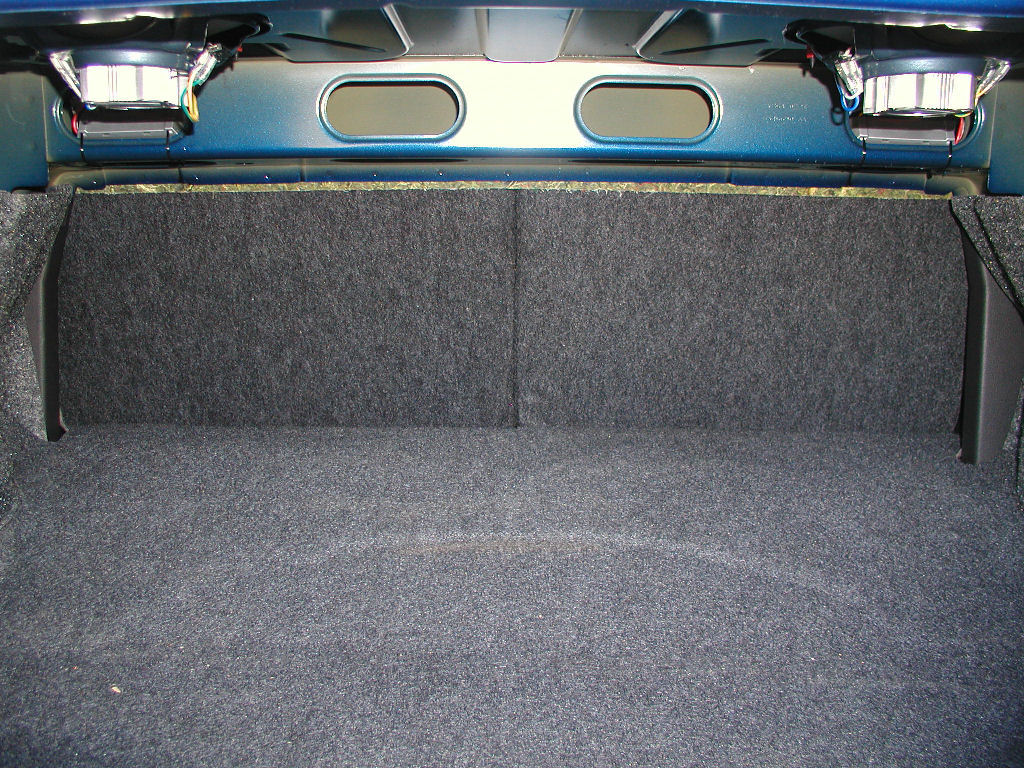

Well, I'm finally making some progress on the install. I installed a Scosche subwoofer, later will be changing it to a JL Audio 12w6. I built a wall behind the rear seat and installed the subwoofer amp. I still have to install the 4-channel amp for the MB Quart mids/tweeters, the Audio Control electronic crossover and the head unit.

That looks VERY good!! It could almost pass as stock, but I'm sure it sounds a lot better. Good job!

Nice job. Looks very neat and doesn't take up the whole trunk. Looks like it belongs there and I bet it sounds great!

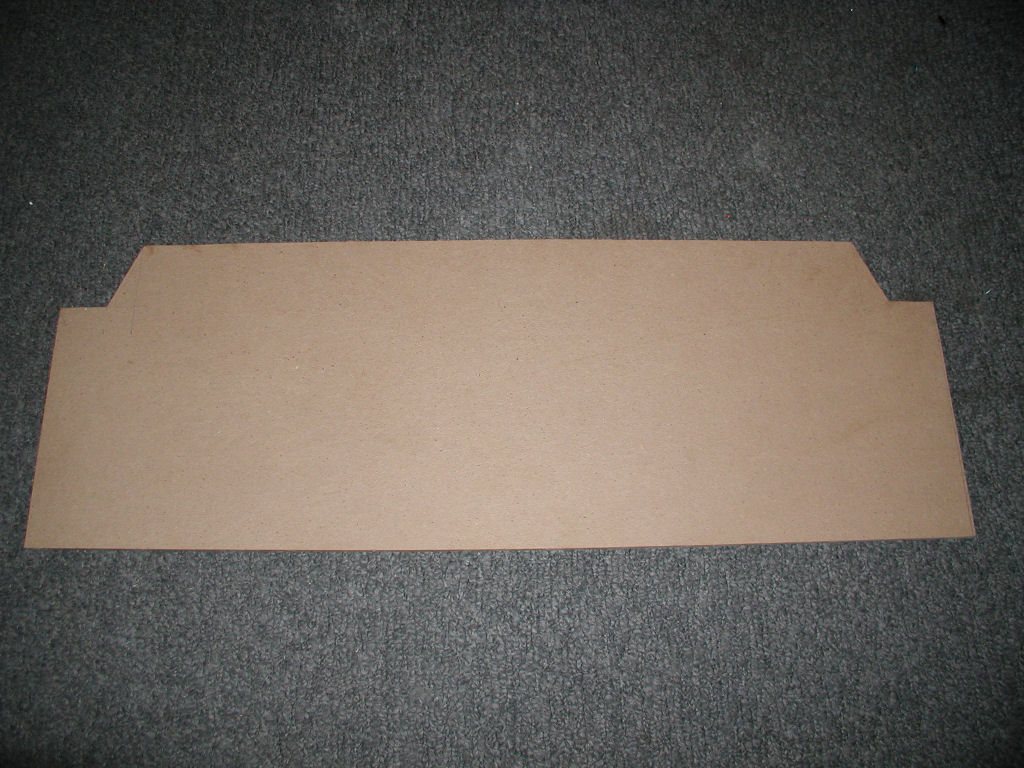

I cut out the pattern you posted and just need to cover it in some carpet and she will be ready to install.

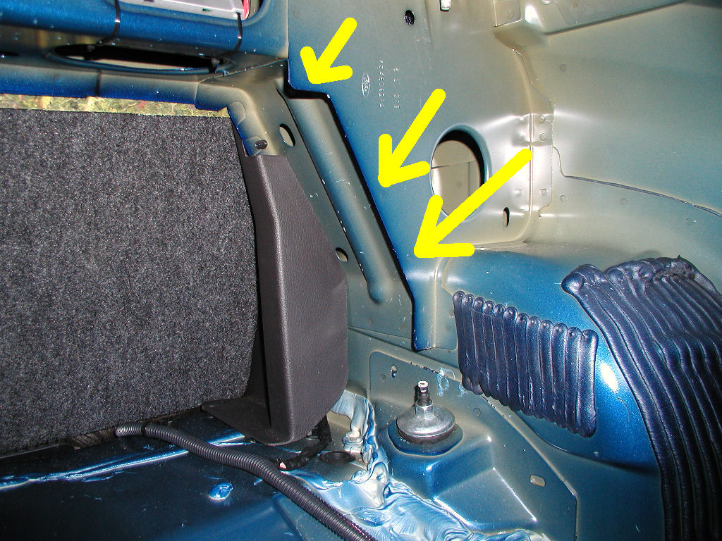

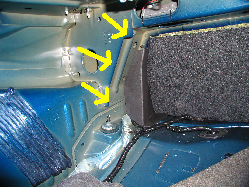

Where & how did you attach the wall to the car? I am guessing self tapping screws to the marked areas. Use any rubber grommets to reduce vibration ?
Attachment 7778Attachment 7779
The orientation is the notches down correct? I am having trouble getting mine to fit past the shock nut area. I have to actually pull the carpeting back (shown in the pictures)on the sides before it will fit, then I can't get the carpet back around the edges.
Do you have any more pictures of the trunk from different angles? Hopefully showing a view from inside the car with the seats down ?

The notches are on the bottom to clear the shock bolts. I had to pull back the liner. I put three self tapping screws in the top, one between each hole in the rear deck support. I then drilled a hold through the metal on the sides from inside the car and ran a self tapping screw through the metal into the wood pulling it tight agains the frame. I used no grommets. The board is carpeted on both sides to provide isolation from any vibration. I folded the liner at the board to make a clean line and used a interior fastener to attach it to the board and hold it flush to it.

Thanks ! That explains the troubles I was having. That was the only way I could see it working for me, but wanted to get some reassurance
