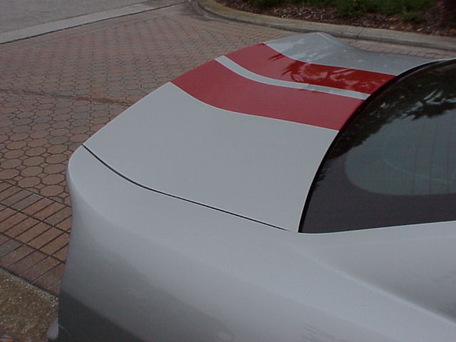

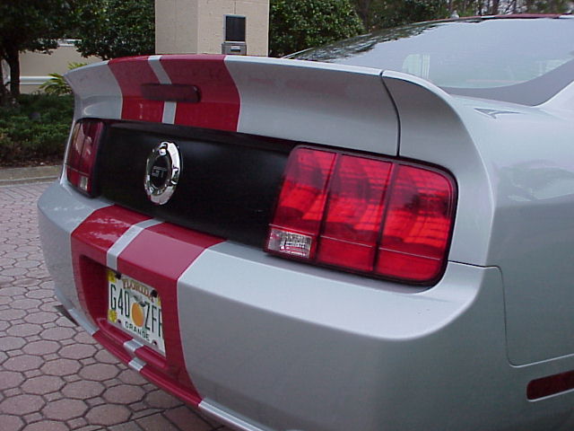

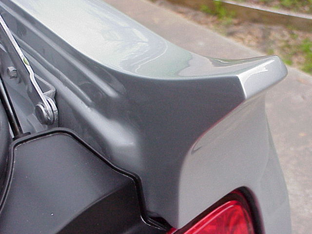

Old Jan 7, 2009 | 10:26 AM
red454's Avatar
Joined: October 10, 2004
Posts: 1,627
From: Location: Indy
Nicely integrated ducktail...
