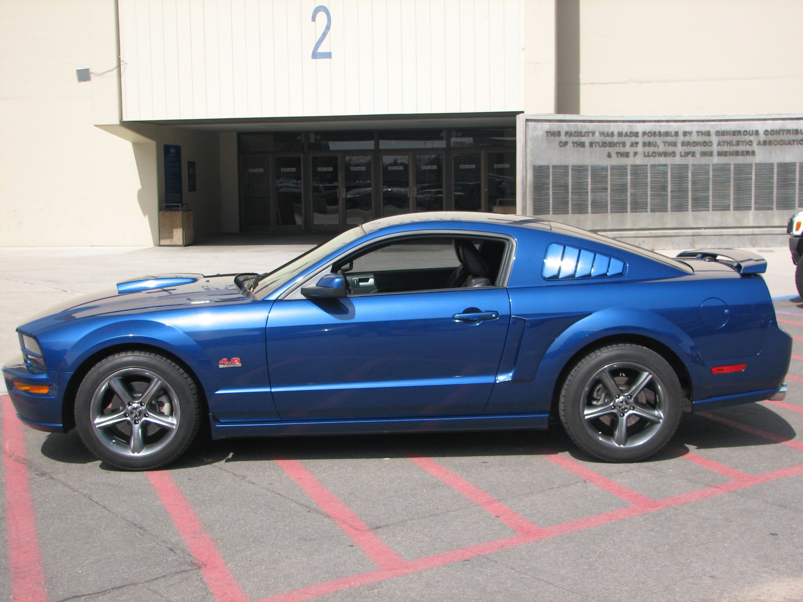

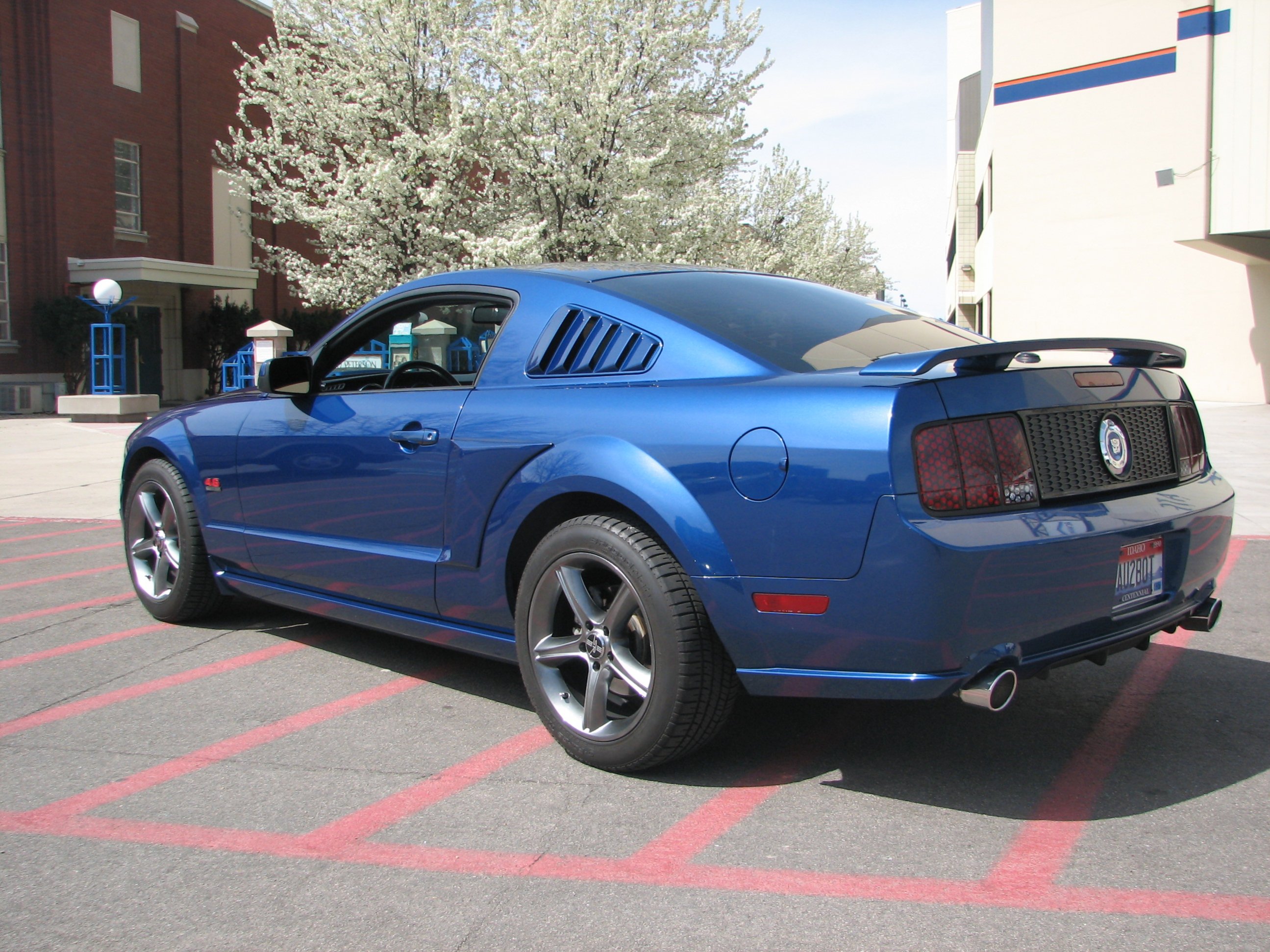

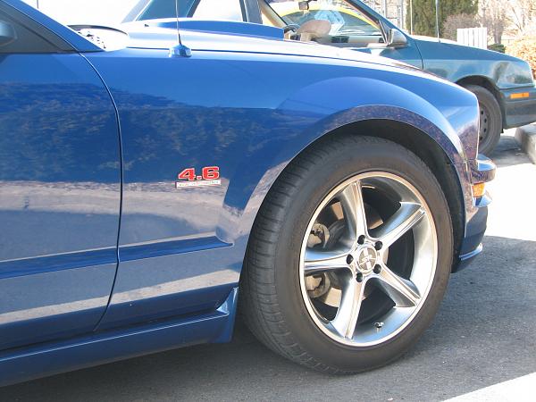

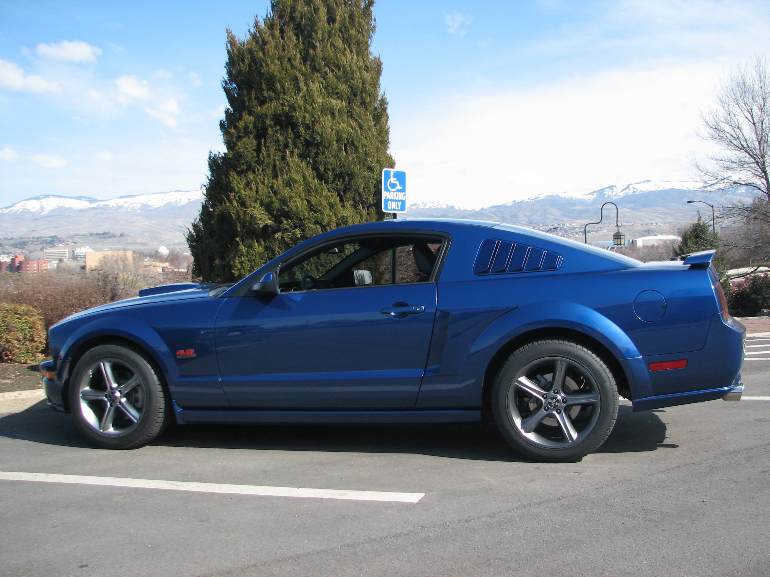

American Muscle has these 2010 GT style Wheels in Anthracite which is a great color, IMO, I like them alot of course I am biased !
Attached Thumbnails wheels!-img_0258.jpg   wheels!-img_0253.jpg   wheels!-img_0210.jpg   wheels!-img_0217.jpg

Another reference point is the RTR 19x9.5 rims with a 33mm offset. See this thread for pics and details.
Because of the 1-1/2" - 2" offset, it will be a challenge to get much of a dish on the rims. With a 2" offset on a 10" wide rim, you only have 3" between the wheel flange and the outer edge of the rim. In that 3" there needs to be space for the spokes to clear the brake calipers. The style of rim that will do that and still have some decent dish will need to have spokes that curve inward by a fair bit. Neither of the rims pictured in the post just above do that. The one in the first post is better, but it likely won't be enough.
