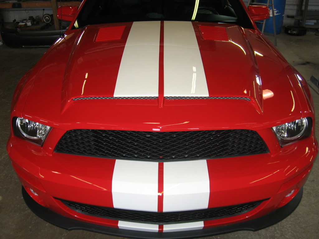

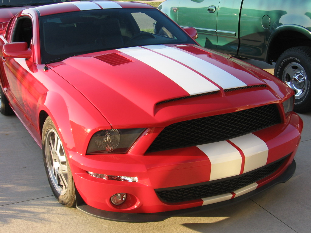

SORRY,I haven't been on in awhile..Here are some of mine...Not the greatest pics( in the body shop with the motor out) because 4 days after getting it back my motor blew ..

Thanks so much for the pics.. I am very sorry to hear about the whole motor thing... Hopefully you will be back up and running very soon... One quick question when they painted your hood did they have to blend in your fenders or was it pretty much a match. Thanks again..

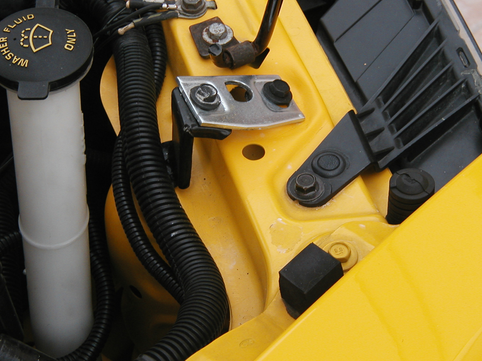

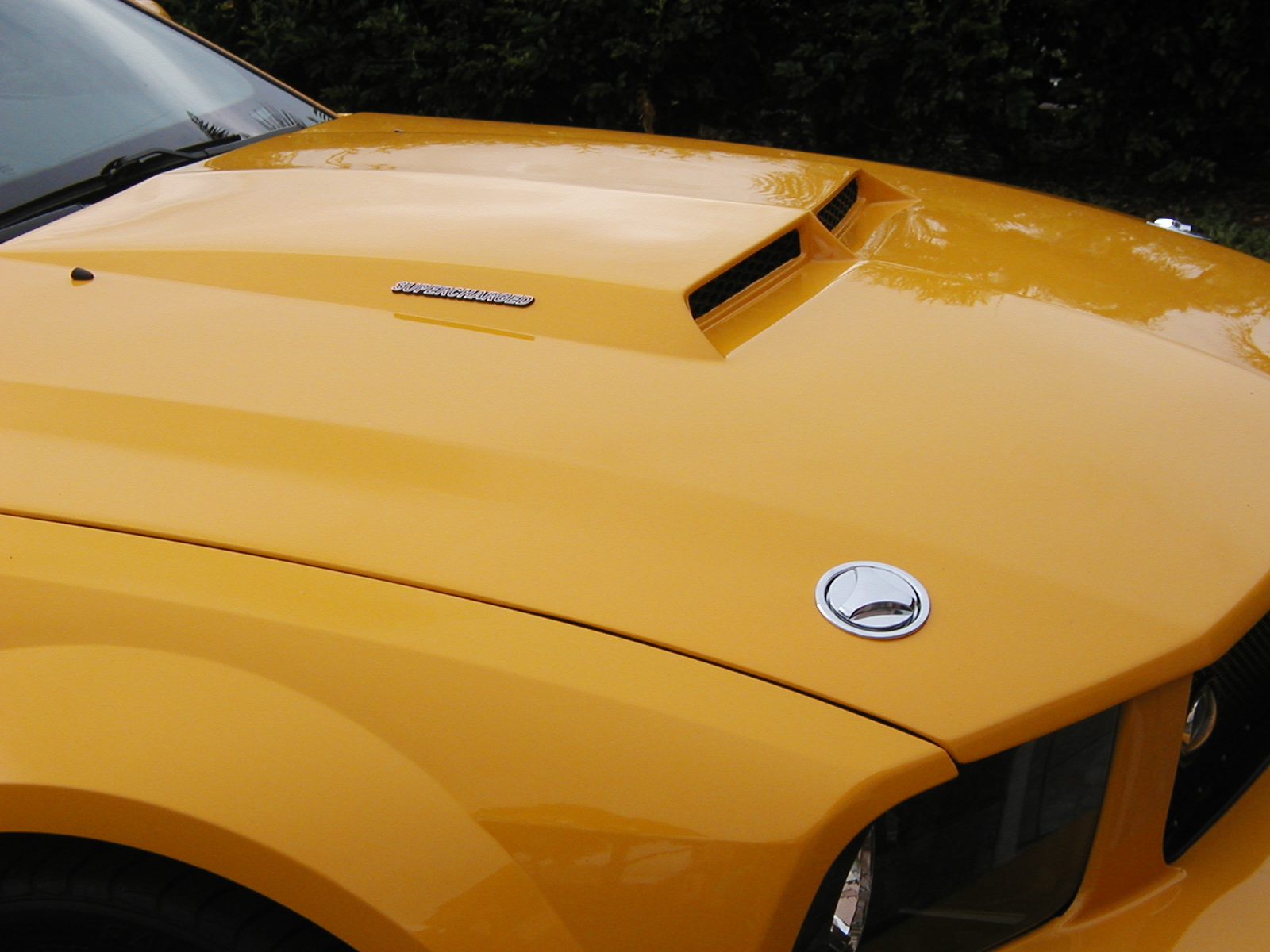

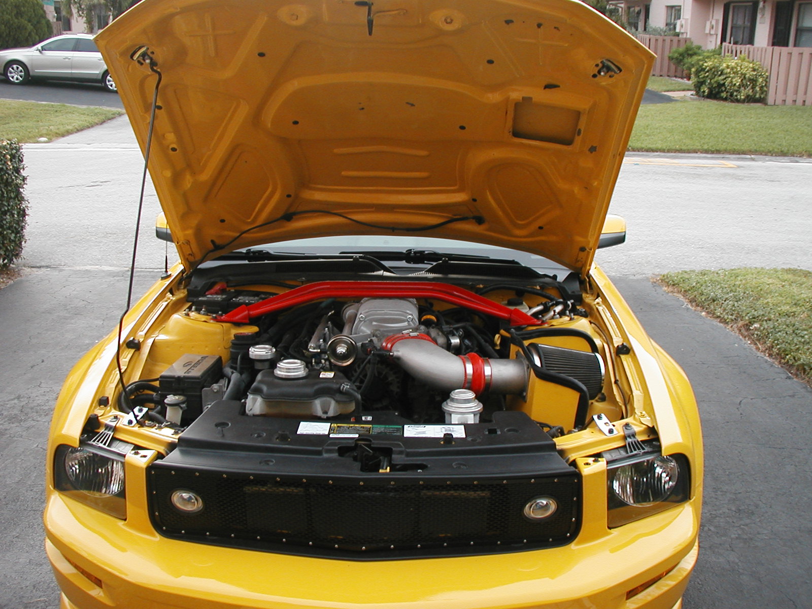

Here's a couple of pictures of a set of twist lock pins for a 71' MACH1 which I bought several years ago and had them installed at a local shop. They don't require a recess in the hood, only a hole in the area where the outside stop would be , so you can use them on most any hood. The supports were made from the bare metal piece which came with the pins and the shop fabricated the black metal piece. Just an FYI incase someone would like the pins without needing a new hood ...
