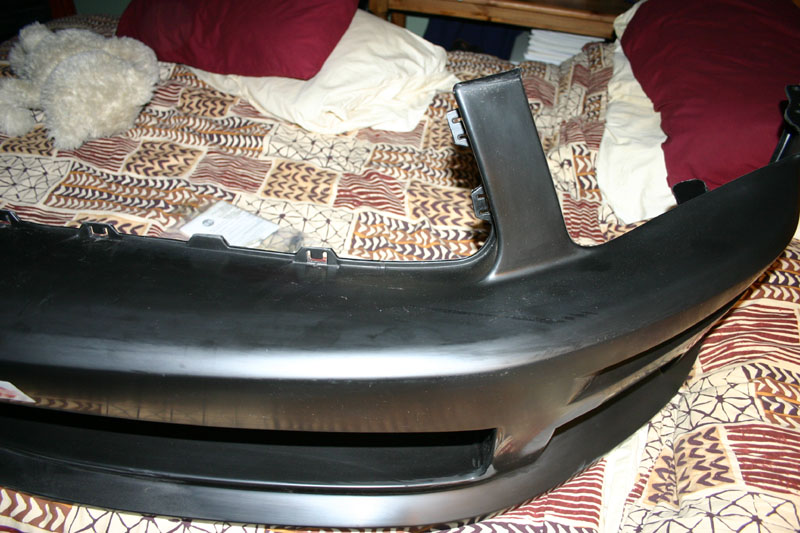

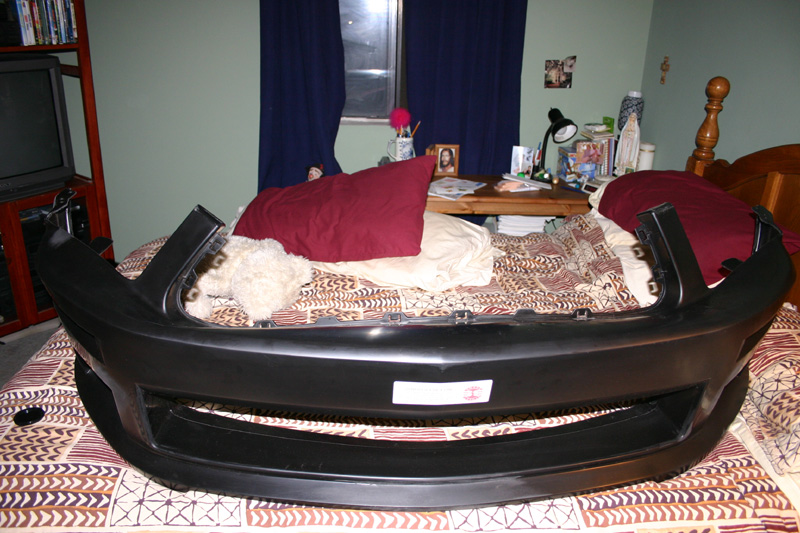

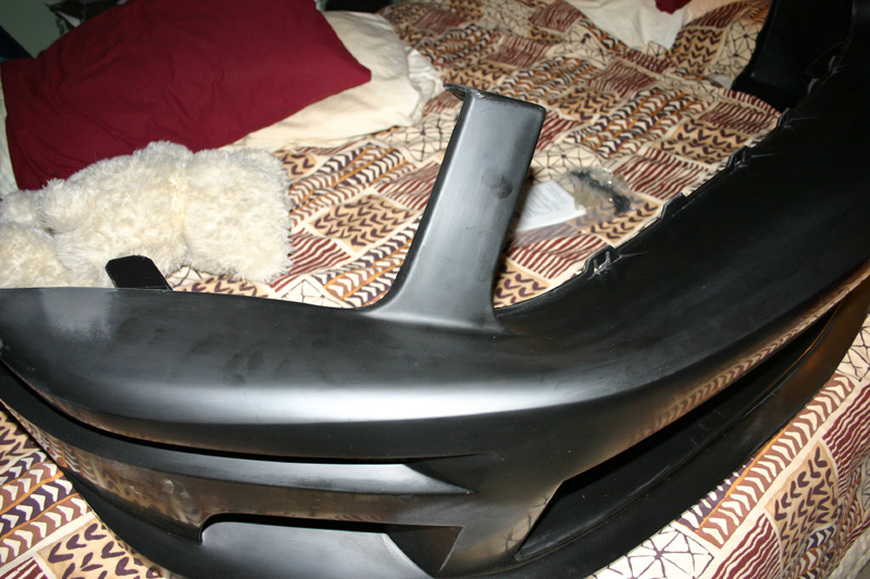

Thanks for the reply John
Here are some pictures.
Basically it's at the top where it's bent more than the other side... but there was tape that was wrapped on the area and I just cut it off tonight, so I know that's why it's misshapen right there... but I figure it will come back... I don't know.

its going to look bent like that till you put it on the car, when everything is bolted or snapped into place it will all straighten out, go somewhere else and have someone who knows what the heck there working with do it for ya

It will form better once on the car, you can also put it out in the sun for a little while and it will soften a little and go back into shape. It should be fine... try to find a good body shop that knows how to paint urethane. There are some tricks to urethane and if its not done right, it will peel, cause "fish eyes" or pin holes....

Thanks very much for the replies everyone... my mind has been put at ease
