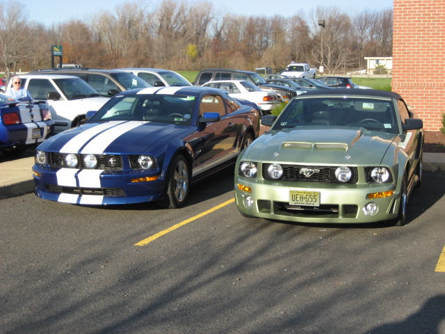

Hey Mark, its real easy to put that grill in. Since I already had done the KSR install, this grill was cake to put in. My tip, do not use the bigger screws to keep the fog lights in. Use the smaller ones (I forget if they were the silver ones or the black ones, its been so long). I started to use the bigger screws, and I saw that there were white stress marks in the screw holes. NOT GOOD. I backed the few out, and switched to the smaller ones (factory ones I believe). Yes, the radiator cover has to come off, and you may have to level the lights out once you install them. Had to do it to one side of my car. Once you have that grill in, you will love it, especially with your stripes!! I love the look of mine. See the pic below. Good luck with the install.
