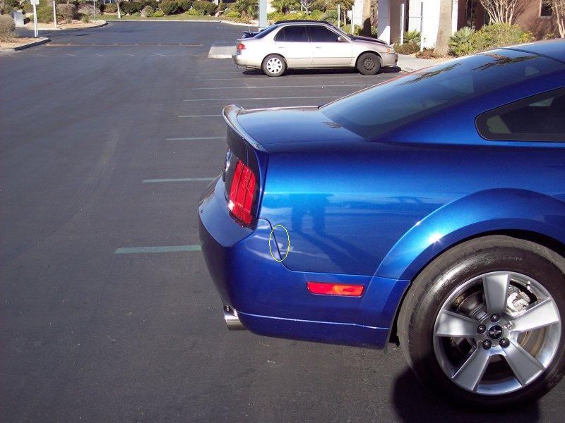

Both sides snap off right behind the wheel well, then it has to be pulled straight back. There are 4 bolts into the trunk, and a plastic alignment pin on each side just in front of the lights. I broke one of those off when I took the stock bumper off, and need to pull it all off so I can fix it some day. The side sticks out just a little, not really enough for most car owners to bother with, just enough to bother me.
The pin is in the area circled in this pic, so be careful when you get up there.
***OMG, this is my 1000'th post!***
Thanks so much for the tips jayguy. One last question. Which direction is the alignment pin orientated in? Is it connected to the the fascia or to the car? Does it run length wise in the circled location or width wise? ie am I pulling straight back at the circled location or straight out away from the tires?

The pin points forward from the facia, just like the 4 bolts do. They're on the ends of the plastic bracket that goes the whole length of the rear facia, that needs to be transfered to the new one.
In fact there are 2 rivets on each end, above and below the pin, that need to be removed and replaced on the new facia. There's also some foam padding there, once you get the facia off, that I moved over, even though it wasn't sticky any more. Probably just there to prevent rubbing or squeaks, I guess.

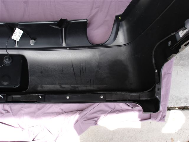

I added the GT/CS rear bumper cover to my 05 GT last July. I installed the bumper cover myself. The install was not difficult. The only PITA was transfering a wiring gizmo that feeds the side parking lights and light for the license, from the old bumper cover to the new one. There are about eight rivets that you have to drill out, then re-rivet. The whole install takes a couple hours the first time you do it. The OE rivets were about 1/4", which I couldn't find anywhere. Instead, I used 1/8" rivets with rivet washers, two washers per rivet, one on each side. Worked perfectly. Below is a picture of the wiring assembly/gizmo securely riveted to the new bumper cover.
