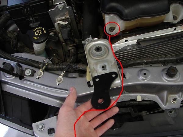

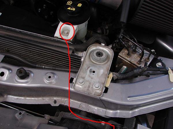

I had to slightly drill out the holes on the lanyards, but I mounted one of the lanyards in the screw for the power steering reservoir, and the other for the passenger side screw on the coolant overflow tank.
For running the cables, I then ran the cables under the radiator cover, around the front of the posts for the hood pins, then out the sie of the radiator cover so that they fall into the groove between the grille and the section that is between the grille and the headlight.
My apologies for the lack of better pictures but this is all I have on this computer.
Attached Thumbnails Shelby hood pin (Drake) cable install location?-driversside.jpg   Shelby hood pin (Drake) cable install location?-passside.jpg

Picture of the lanyards coming out from under the hood (copies Shelby GT lanyard placement):
Attached Thumbnails Shelby hood pin (Drake) cable install location?-img_6852.jpg
