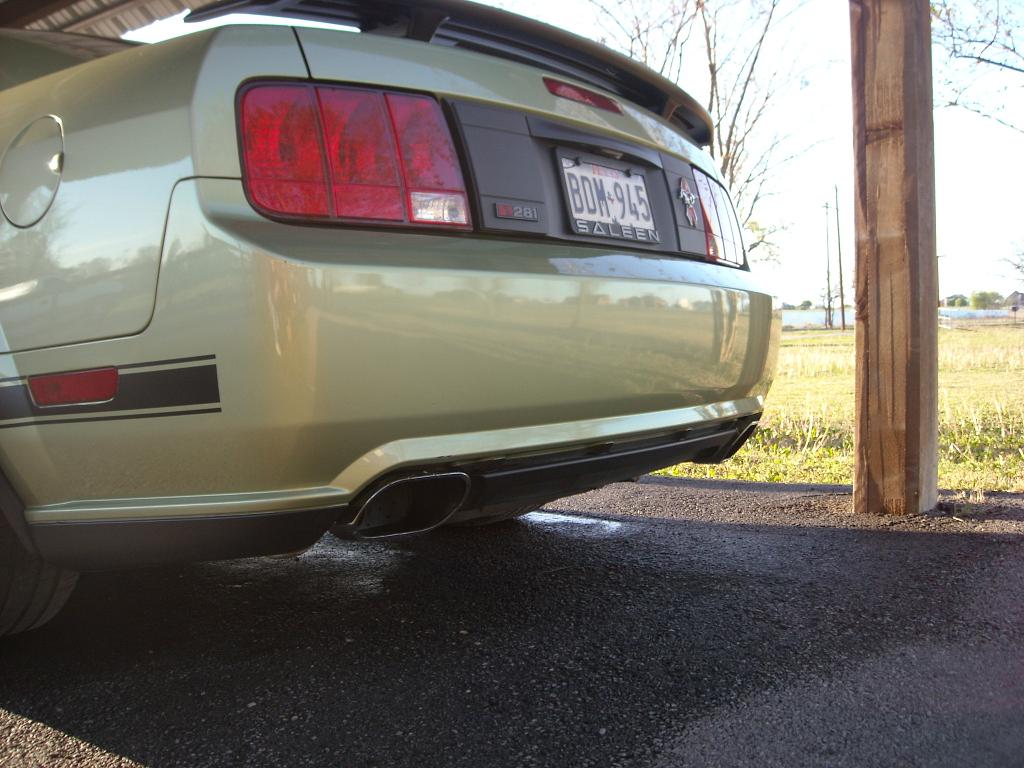

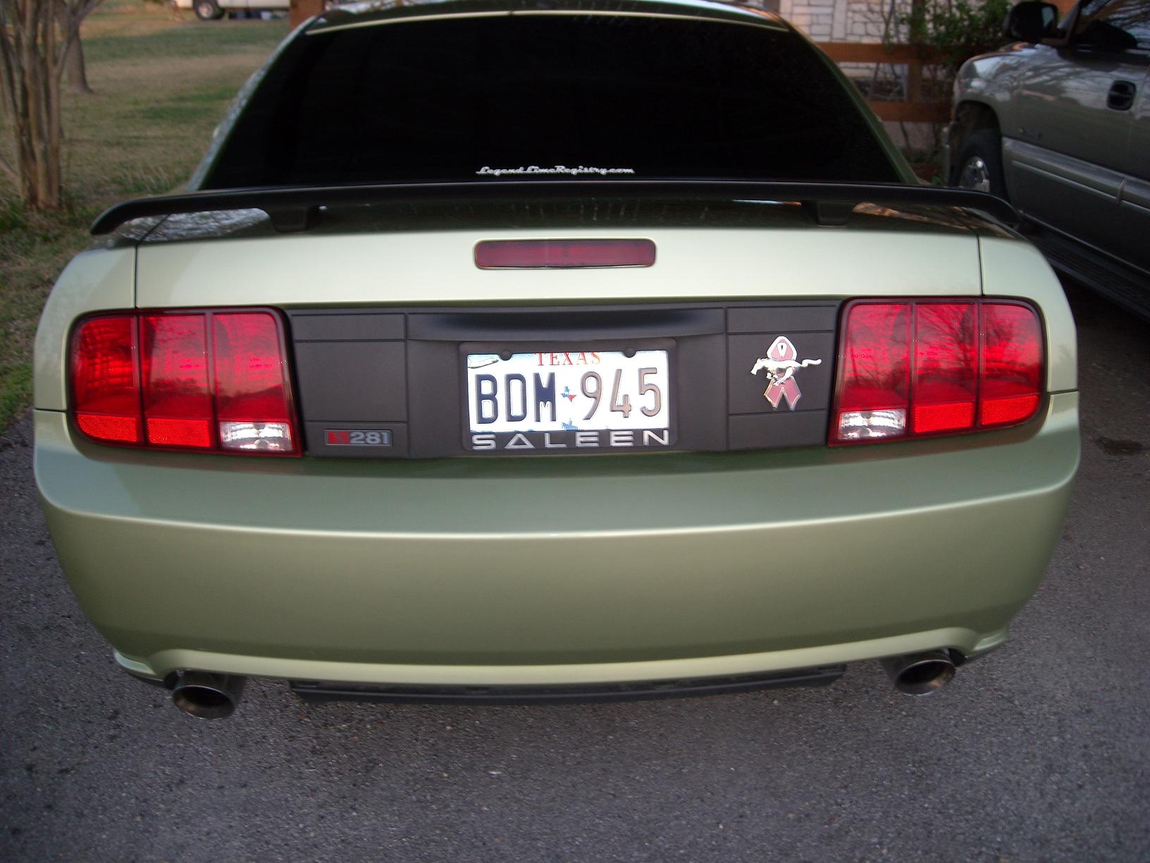

I have that bumper, these are Saleen parts bought during the sell off. All parts go on just like factory and yes you have to add the bumper reinforcements, just like factory parts, bumper skins all require them.
I would advise you find the trunk parts before buying the bumper.You wont have a place to mount your license plate if not. Call Saleen for what you need.
The exhaust will have a larger opening than the factory exhaust can fill. PJ tips are available on ebay as well. Hope this helps.
