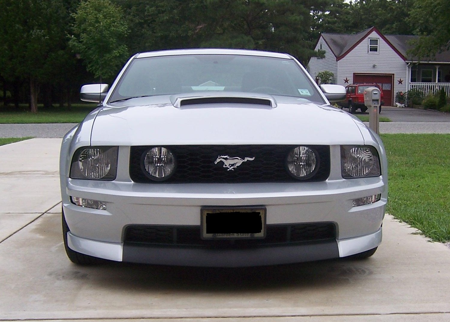

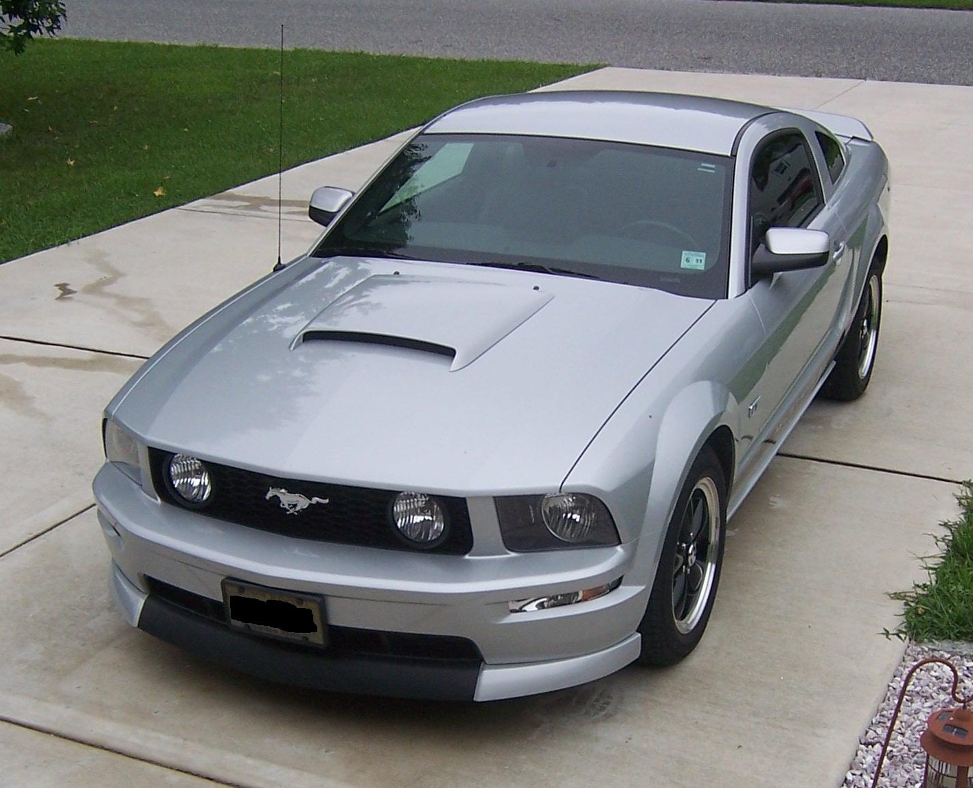

Here ya go Craigger325i. I cropped two of my photos so that I could post higher resolution pics....keeping my fingers crossed
Oh, almost forgot. The classic spoiler that I bought was the textured black painted one. I had the paint shop wet sand the outer areas smooth so that the silver would tie in better with the rest of the facia and not look so out of place. The black portion is the original paint/finish of the spoiler.
