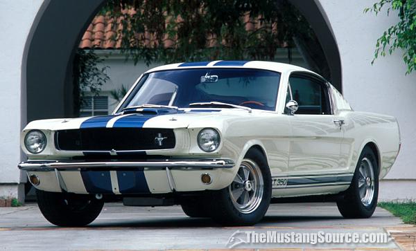

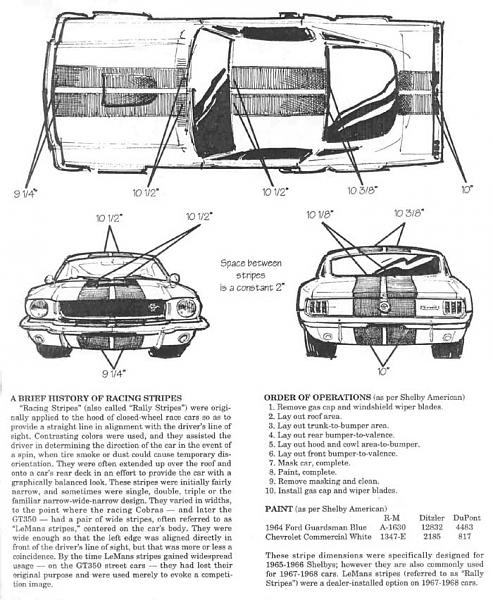

If you have them painted, you can make them whichever looks best to you.
IMO, the curves of the new Mustang, especially the hood, make the tapered stripes look really bad. The stripes that are consistantly the same width from front to back look better.

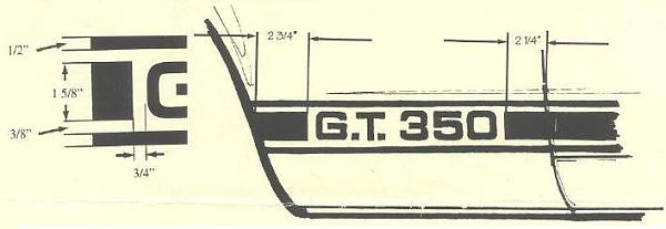

However, if you want the original '65 Shelby dimensions, then yes, THOSE were tapered. (see pics below) For my taste, though the best looking measurements on an '05+ Mustang are 10.5" stripes with a 1.5" gap.

Well I went through the stripes thread and found this car with the actual Shelby measurements from 65/66 and it looks pretty darn good IMO!

You'd have to find a picture that shows the hood from a little higher view. One that looks like you're standing in front of the car. (since that's the way most people will be looking at your stripes anyway)

When I decided to get the car, I wanted to get Lemans stripes, maybe 12" with 1.5" or 2" gap. However, I found the Kaenen hood and had to have it. I saw a car with the RKSport hood (similar to mine) with wider stripes and it looked awful...the stripes didn't line up with the scoops at all! I found the very same picture that Stangnut posted (BTW, the 1967-1968 Shelbys did not have uniform stripe dimensions - most dealers used the 1965-1966 dimensions). I taped those dimensions out on the hood to see if it looked good. I liked the look and gave that same picture to the body guy when he painted the stripes. Let me tell you, with that hood, they look perfect! The reason behind the taper is to make the stripe "appear" to be uniform all the way back when looking from the front.
I can't say for sure that the tapered stripes would look good on the stock hood, but they look sharp with the Kaenen hood. Check out the spreadsheet as I believe someone else used the tapered dimensions on the stock hood. I any event, take the time to tape out all options on the car before you make a decision.

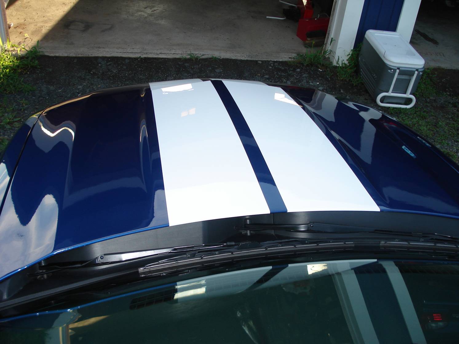

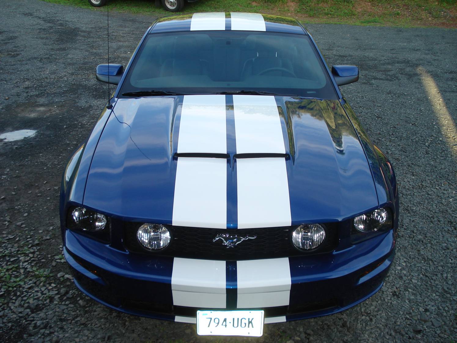

Here are some more pics that show the tapered stripes. Note that the stripes are 9.25" wide at the front of the hood and 10.5" wide at the back of the hood. The spacing is a constant 2".

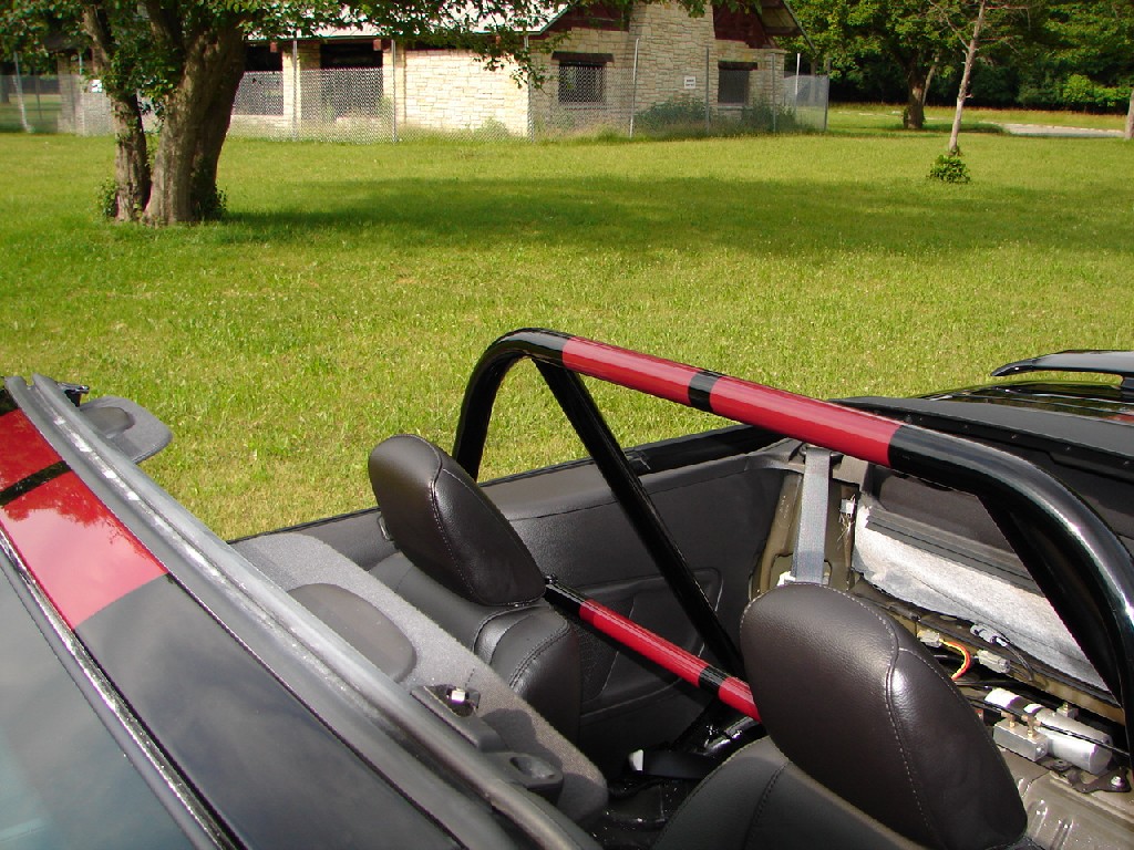

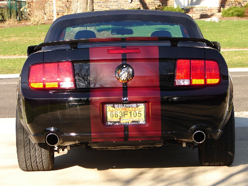

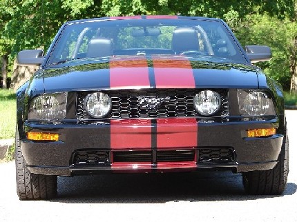

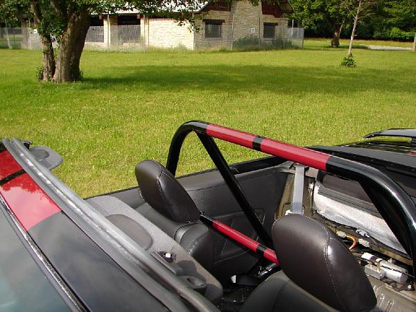

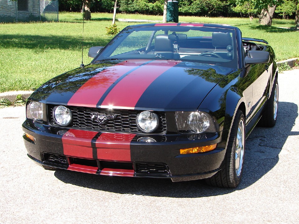

10" painted stripes 1.5" gap
stripes are 10" from end to end incuding the roll bar
