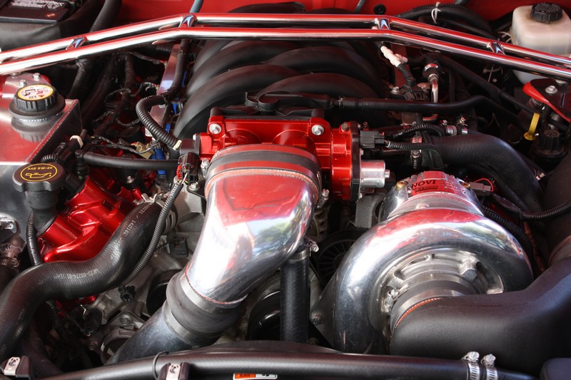

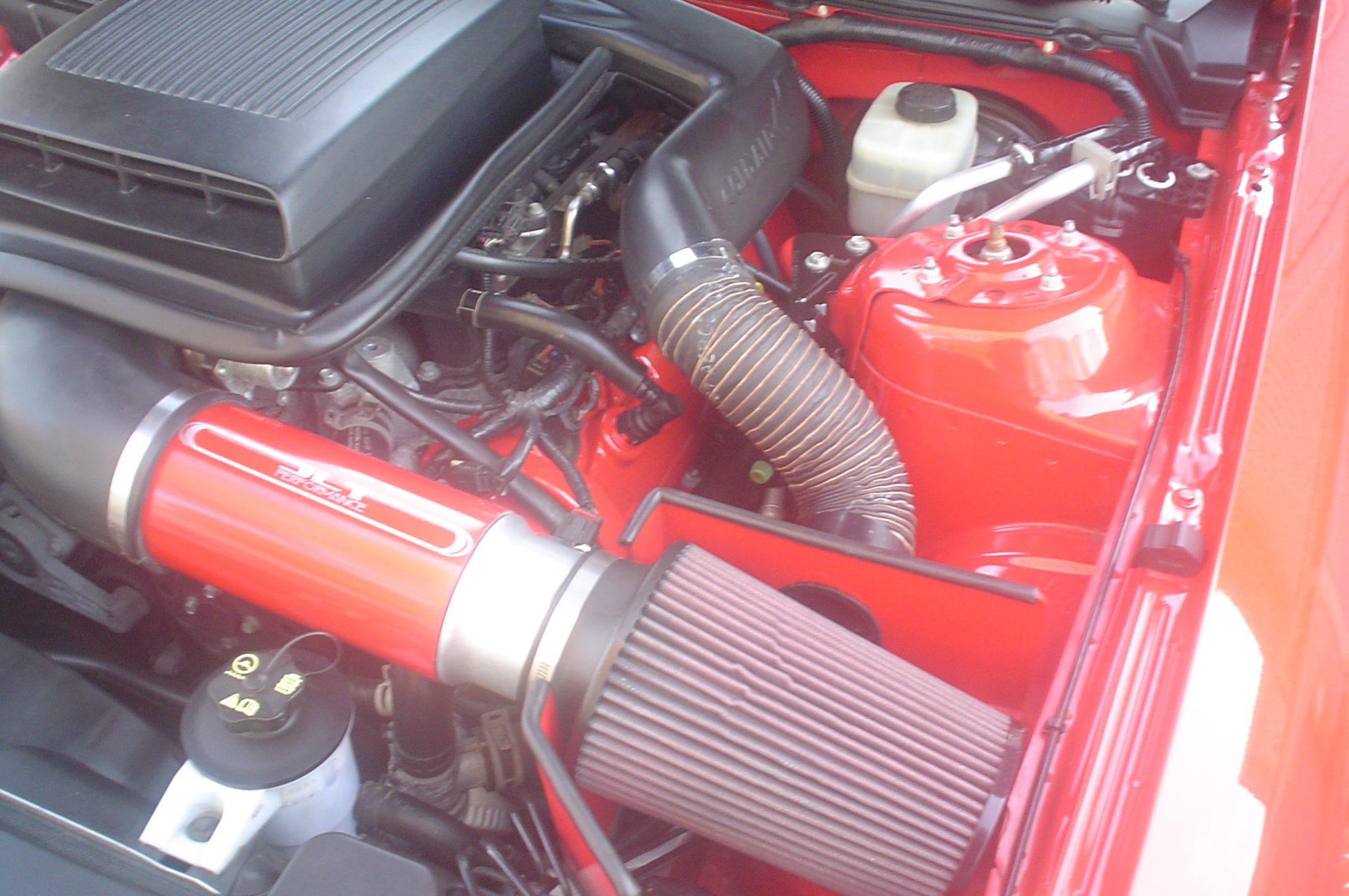

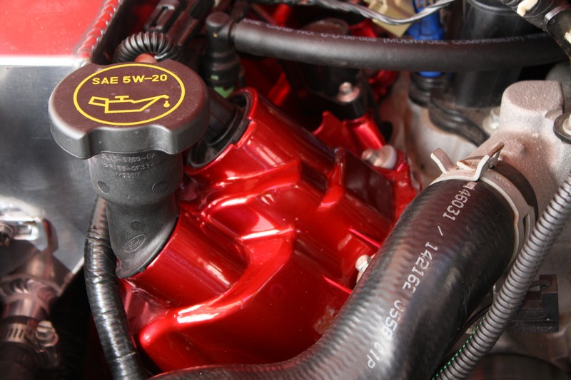

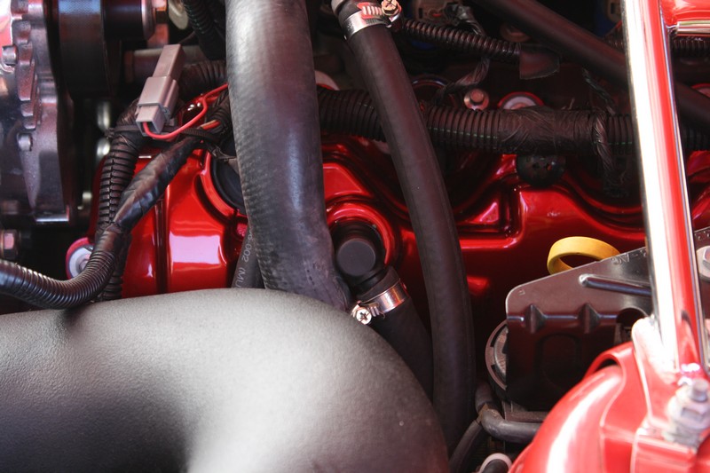

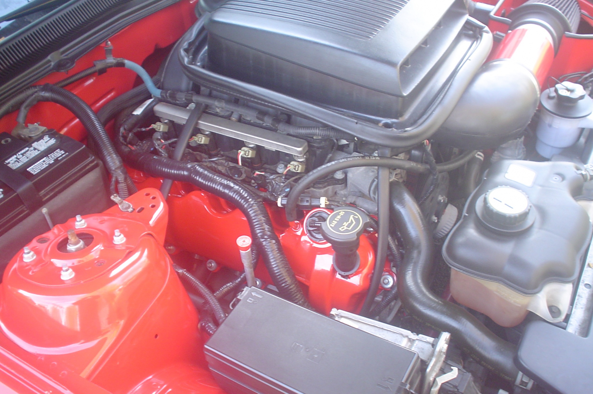

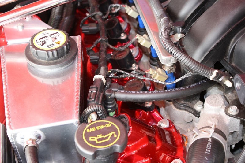

Finally finished mine today, it took basically a full day to complete. What took so long for mine was the 3 diffrent coats of powder. 1st was the primer coat, then a chrome coat and last the red translucent top coat. They may not be perfect but heck I dont think their too bad for the 1st try at cam covers and this style of coating.
Is that Translucent Red Top Coat pretty durable?
I had something similar done on mine and the Translucent coat scratches a lot easier than a 'solid' powdercoat.
Old Oct 18, 2010 | 11:46 AM
  #46
killbee's Avatar
Joined: July 20, 2007
Posts: 72
It seems to be pretty tough, no scratches getting them installed. I could have put a clear top coat for more protection but it seems to dull the shine down a touch. Now that I've done this color if it does scratch I'll just coat them again.

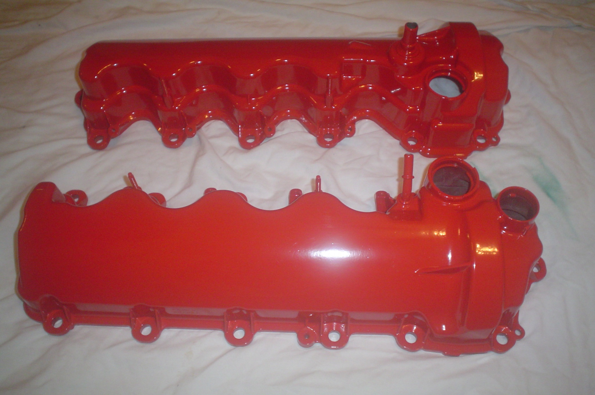

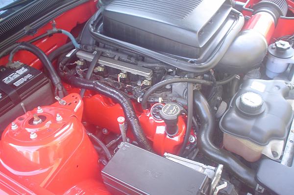

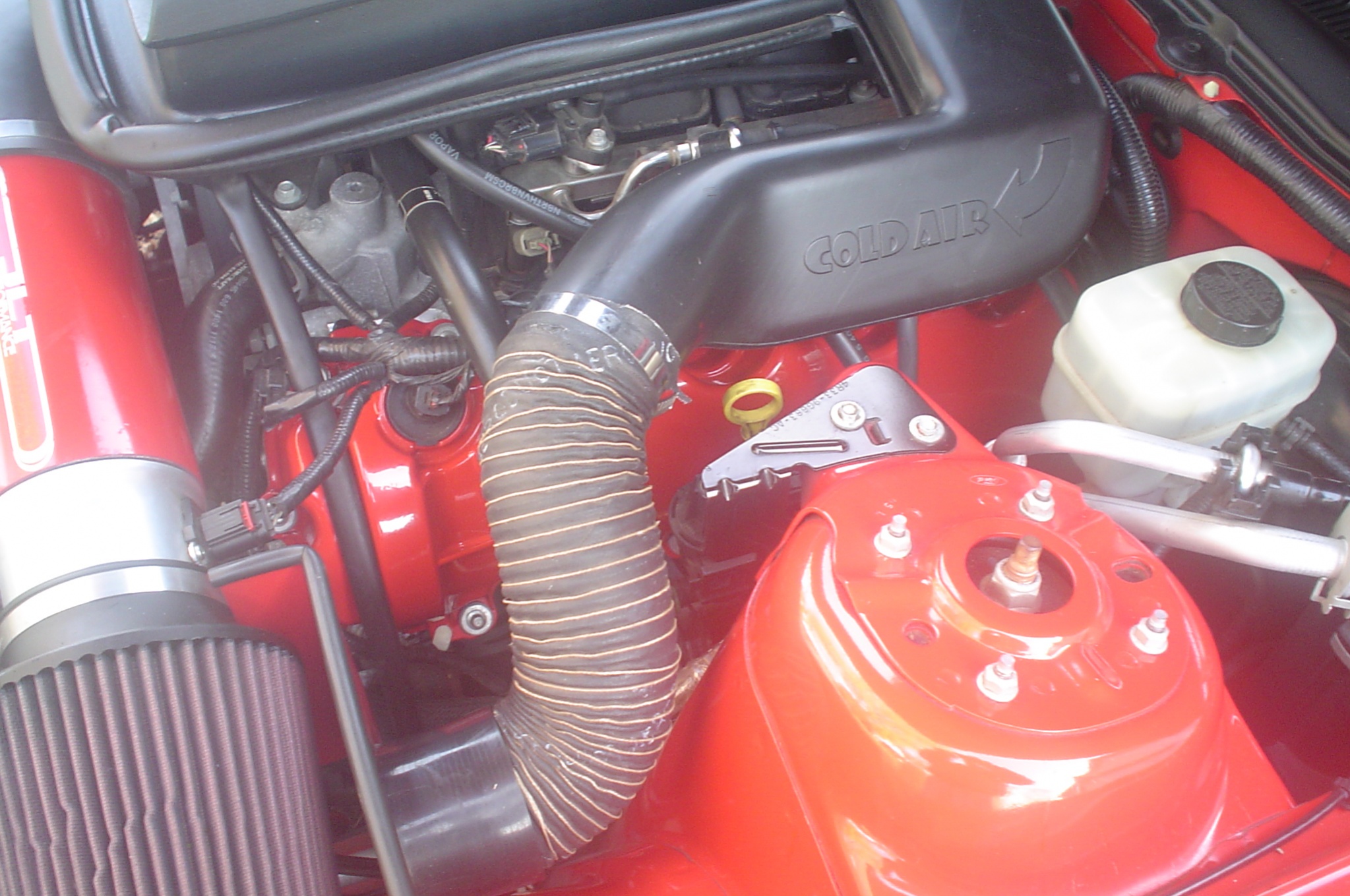

Just got mine coated & installed this past Friday. Co-worker bought a powder coat kit. Bead blasted prior to coating. Cost me $14.00 for the powder & 2 afternoons of labor. I baked the covers prior to coating, did not mask off the studs or tubes, just capped the openings.

Pass side, did not upload w/rest of pics

Aircare84 your covers look great! What did you cap the metal tubes with? Are they still functional with them powder coated as well?
Old Nov 3, 2010 | 07:24 PM
  #57
aircare84's Avatar
Joined: October 1, 2006
Posts: 1,153
From: Central OH
Thanks 5pointoh.
I used aluminum tape to cap the tubes & yes they are still functional. The powder coat is very thin, doesn't affect sealing with the tubes at all.
