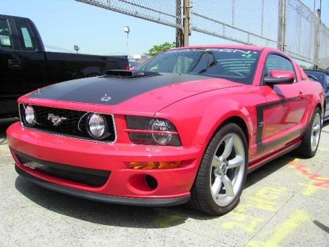

I am looking to get this bumper in the spring and wanted to know what fog lights could fit in the holes the Roush or the gt500?

I've got one, got it from Stage3.
I'm wondering the same thing, and have the 4" fogs from the Escape/GT500 waiting to go in, but haven't yet done so. It's about 4th on my install list right now, unfortunately
Unfortunately it's not a simple or straightforward process, they weren't designed for this. They're supposed to be brake duct holes.
The 4" ones I have (http://www.amazon.com/ESCAPE-PASSENG.../dp/B000E4M1QI, ) do not fit flush due to the inner lip, which I'll have to pare back with an exacto/utility knife. Then it's a matter of securing them, I think I'm going to epoxy the front, and maybe metal straps, but it's a good question...
There are a few on another forum that have put ones in their's, but I can't find the sites/links at the moment...

So hopefully will get to these later this spring. I'll try to snap some photos of what I have when I'm under there this weekend, show you what the thing looks like. It's basically just a truncated cone on the backside, with a bit of a flat section going inward around the hole itself. Nothing on the cone to help connect it, and of course drilling into that area isn't helpful.
I bought these Roush pieces thinking they'd help, they do fit the Escape/GT500 fogs (where I got the idea, the Roush instruction manual), but again no way that's easy to attach them to the bumper itself:
http://www.cjponyparts.com/product.a...paign=shopping
I was thinking of getting the Roush, but there's so many of them. Very few of the Heritage/PJ front fascia. And I like the lower grille. I put some JLT bezels in them for routing a brake duct kit. Just have to hook it up.

The Escape fogs exactly fit the Roush brackets, that's what they're designed to use, have mounting holes and all. Problem is the Roush brackets don't fit the Heritage/PJ holes, at least without some modification.

That's what I'm trying to figure as well, but it's a smooth 'cone' on the backside of the bumper, with nothing obvious to attach to. Looking at the Roush one (wish I could see a GT500 one as well, but never have) they have little tabs/screw holes where that bracket above connects, but the Heritage one doesn't. I'm thinking maybe epoxy down a tether type attachment on the outboard side, and screwing it in on the other side where the lower grille is, and having a strap run across the backside of the light itself.
Other thought was a velcro piece on the plastic cone, and then a velcro strap across the backside.
Ideal would be a couple of angle brackets attached to some nearby structure, but I think that'd be difficult.
