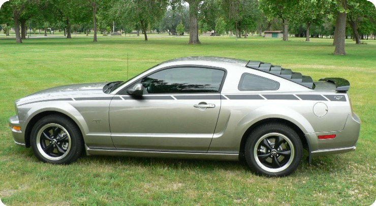

A friend painted mine, but I wanted the machine lip. He also painted spoiler. It can work out great!!

That turned out looking really good. Our cars look very similar.
Since this pic I have added a GT500 spoiler and a CDC classic chin spoiler painted silver.
