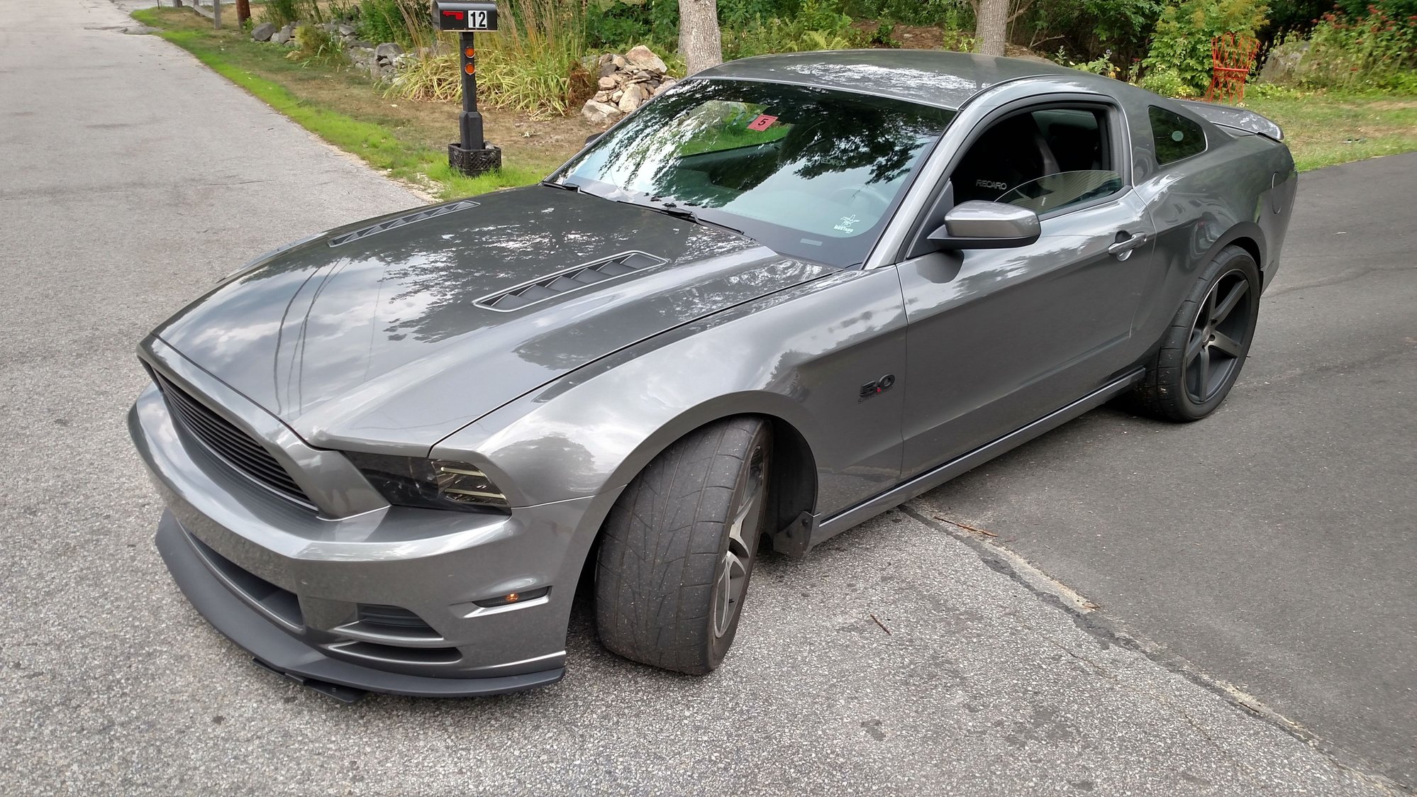

Old Nov 25, 2024 | 09:01 PM
Gabe's Avatar
Joined: August 7, 2011
Posts: 5,246
Likes: 567
From: NC

That will of course depend on which tire you'd go with. Some tires will surprise you with their sidewall stiffness, like my 305/40 drag radials did.
I ran that size on the front of my car for years with no issues. It fits very well on the 9.5"-wide wheel. A 275 definitely fits more square-shouldered, and I would recommend 275/40/18 as the perfect size for an 18x9.5 wheel, especially if looking to go with the same size all around.
