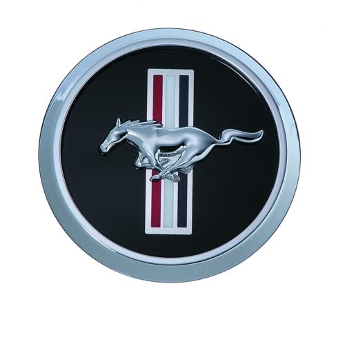

Has anyone figured out how to match up the center caps when running the factory bullits on the front (which use the small caps) while running the American Muscle bullits on the rear (which use the large caps)? The tires I have on the front wheels are almost new and I don't see any reason to change the front wheels just to run wider tires out back. Well, other than being able to get the stupid center caps to match. I understand I'm not the first person to run into this. Any ideas?

You can get a running pony caps for the stock Bullit wheels and also get a pair for the American Muscle wheels. One cap fits on the outside (front) and other will fit on the inside (rear).

It looks like the Ford one has a silver ring around the outside, but they're close

I modified the crappy center caps that came with my American Muscle /Mustang Performance 18x10 back wheels to match my stock fronts. I bought an extra pair of Ford center caps, cut the plastic tangs off and sanded the backs flat with sandpaper on my kitchen table. I roughed up and sanded the plexiglass face of the larger caps and simply two-part-epoxied the ford caps on top, leaving a little space.
It's not like the Ford caps are anything special, but I like them and wanted the rears to match. Since the Ford caps sit on the face of the stock wheels, it was easy to match on the aftermarket wheels.
They match perfectly, and it's been several thousand miles [and a few 1/4 mile runs] and they are fine... A guy asked me at the track where I got them...
There's an older thread about this too...
Mike E

Hey Mike, I remember that thread. Glad to hear your idea worked! Looks like that's what I'll be doing. Thanks for the post. Btw, I like the way the stock caps match my satin silver. I think they look good too.

The diameter isn't the same and you'd ruin the edge of the [high quality, yeah right] plastic finish. And there's no need: They sit perfectly on the plexiglass face and it looks right. Personally, I think the flush look isn't as nice anyway, but that's just personal preference.

Yep, I finally got around to doing it, and it came out perfectly. And being the single guy lets me use my kitchen table for various car things for days at a time... I just bought some fresh sandpaper, laid it on the table and sanded away to my heart's content until the fit looked right. I picked up the epoxy at Lowes, and made up a good sized batch [coated the whole face of the plexi] and pushed it together. Easy. LOL
