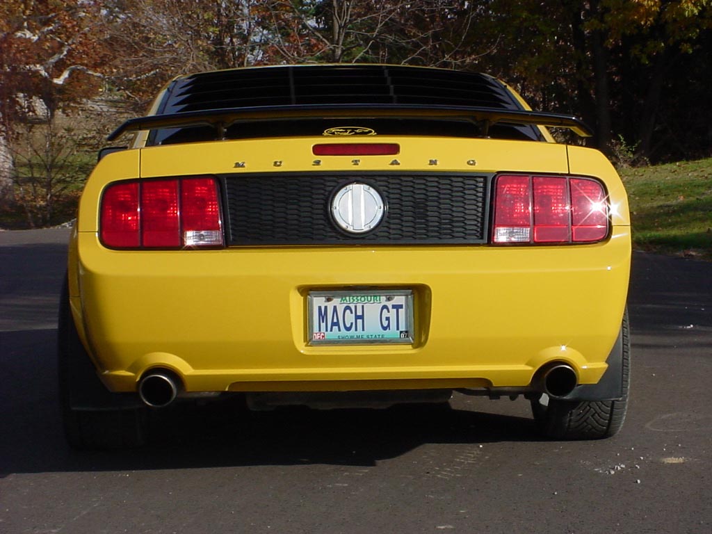

I still like my Silverhorse solution but was pricy...
Attached Thumbnails I installed a 1969 gas cap on my rear panel (with pics)-dsc00058fv.jpg
