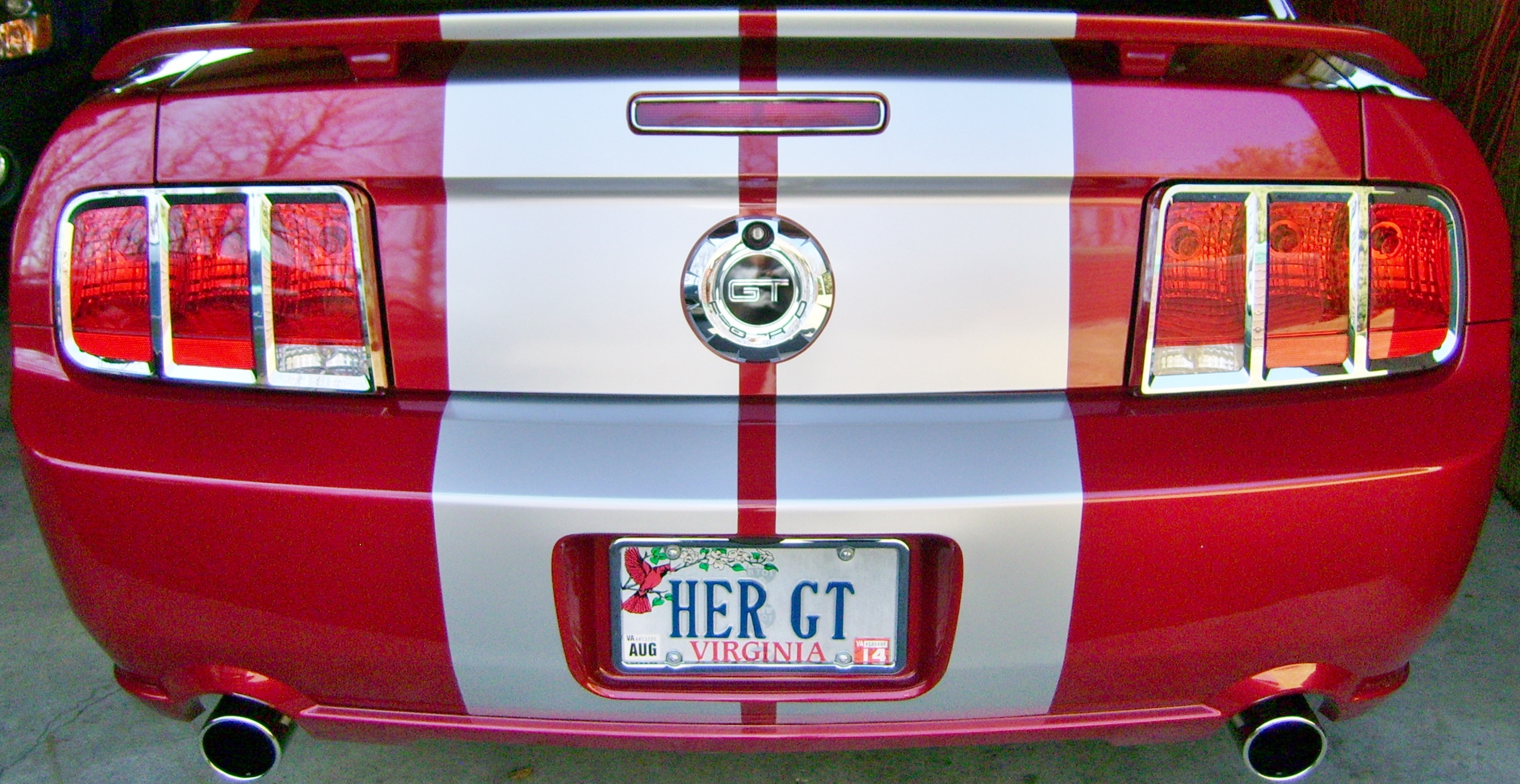

My '08 GT's trunk was a little low over on the pass side and it showed above the tail light and along top edge against fender. There is no adjustment except at the latch and the lid is small and pretty rigid.
I fixed it by measuring the distance between the two bolts holding the right side of trunk to hinge. Got a piece of 1/8" thick aluminum, about same size, drilled two holes, inserted it and scribed around edge of hinge, removed it and further fine tuned my cuts on the bandsaw, then clean up edges and reinstalled. Looks factory, painted edge with touch up paint .... and it raised my trunk lid for a "as near perfect" match to the fender top and above the tail light.
