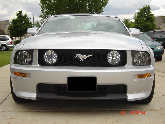

Very easy to do with simple hand tools. You can do the install without lifting the front end up and putting it on jack stands, but lifting it will make it easier to reach under there to access the bolts. Get the Ford Accessories kit, it will have all the hardware you need to do the install, and make sure you have a rivet gun available. Here's a few photos of my car with the GT/CS front and rear bumpers.
Attached Thumbnails GT/California Special Front Fascia Switcharoo-bumper-1sm.jpg   GT/California Special Front Fascia Switcharoo-bumper-8sm.jpg
