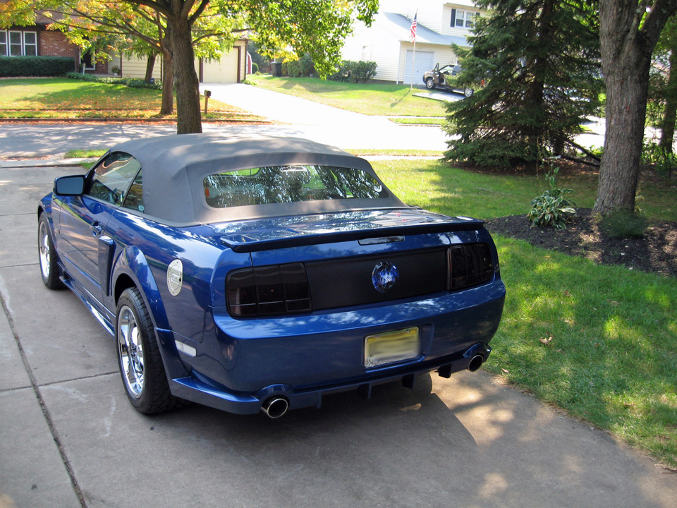

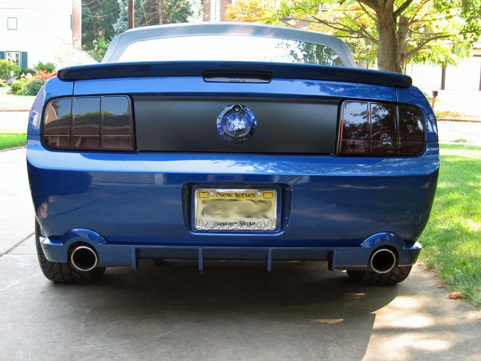

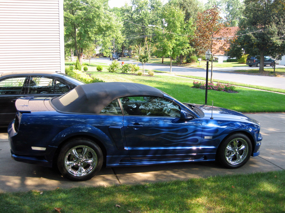

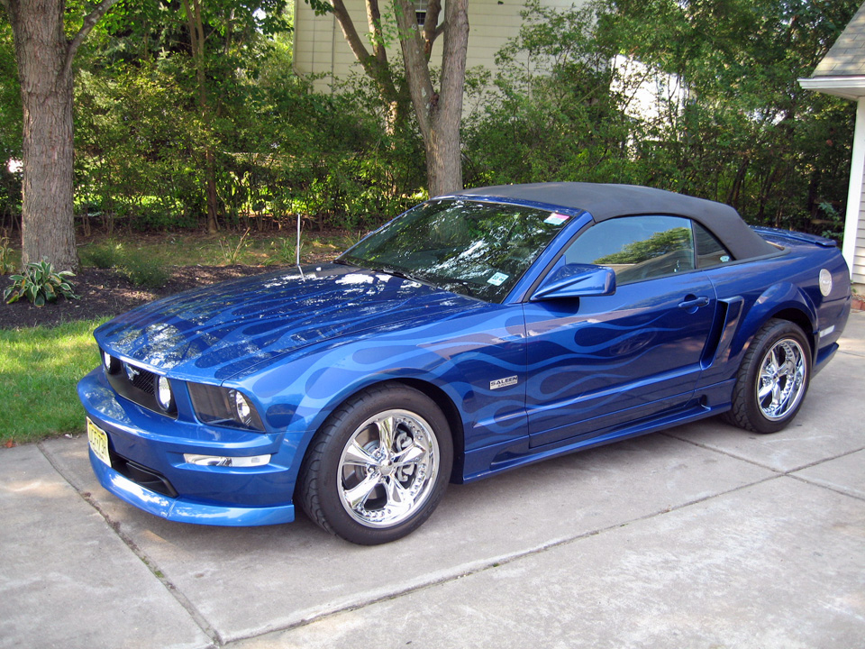

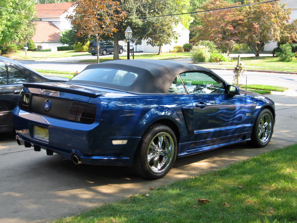

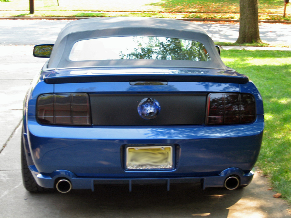

Here's The Pics......
here ya go....was pretty easy... I should have taken pics during the install, but I had my 80 year old neighbor helping me. I had to keep an eye on him... You definitely need another set of hands to get this thing on right.
The only hard part about the install is getting the tape to adhere properly. Use a wax/adhesive remover to get all wax, dirt, and crap off behind the wheel well and valence. Then use the adhesion promotor and wipe the contact area. Wait 3-5 minutes and put it on! I bought different screws for the wheel well opening. I got black trim screws with the built in washer. It looks like a clean install that way. Dont just use the tape. The screws really are needed to help the valence stay attached to the wheel well opening. I also used a right angle drill attachment so I didn't have to pull my wheels off . There is 1 screw needed for each side. It's holding for now. I can always add another one later if I need to.

Looks real good!
I like that spoiler too, what kind is it?
Looks real clean!

Ford V6 Spoiler. I was looking for more pictures of it in another thread. And here they are. Haha

Are you sure? I thought the V6 one had pillars? Or is it a different type of V6 spolier?

Heres a link to a thread I made yesterday. Its a V6 spoiler.
http://forums.bradbarnett.net/showthread.php?t=71540

heres my original thread when i mounted it.
http://forums.bradbarnett.net/showthread.php?t=64853

Oh I see! It's the Pony package spoiler! That's why I didn't know what it is!
Does it mount with the factory GT spoiler bolt holes?
I guess I'll wait untill they get some Dark Candy Apple ones in stock, then maybe get of them to replace my GT spoiler!

Hi roller,how big are the tips on the flowmasters? I have 4" ones w/ the FRPP's. I'm afraid that they will melt the valence..Yours looks real good..I would straighten the tips though

They won't. One of my Cervini's tips just barely touches my side skirts and it hasn't melted the skirt or hurt the paint, and I have fully straight thru exhaust.

the flows have 4" tips. I'm not gonna waste my time straightening them though. I'm thinking about swapping them out for Corsa's or the FRPP Stingers anyway.

HiRoller, what did you use to blackout your trunk? Is that paint? Vinyl?

Believe it or not........its magnetic. You can find them on e-bay for under $50. The guys name is NYYANKEE.

HiRoller, the rear valance looks amazing. Excellent job dude!!!
