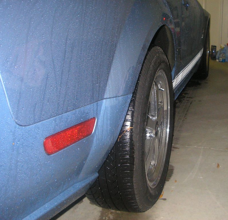

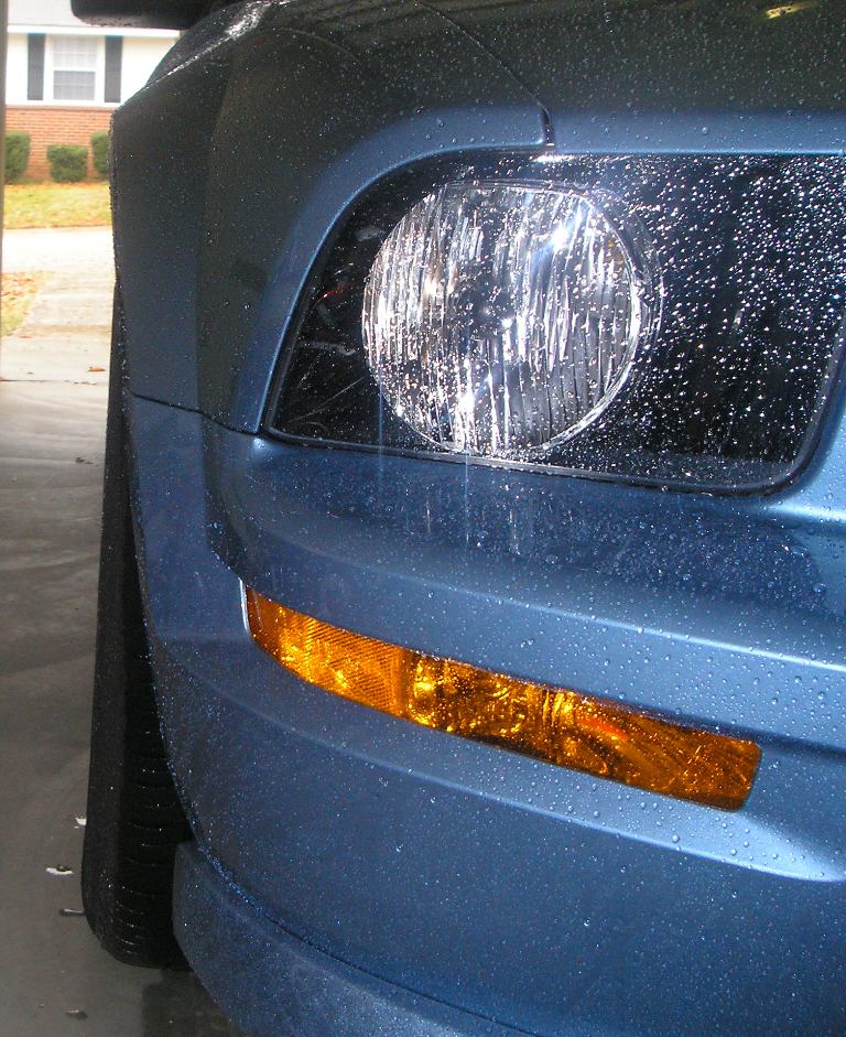

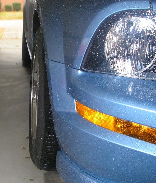

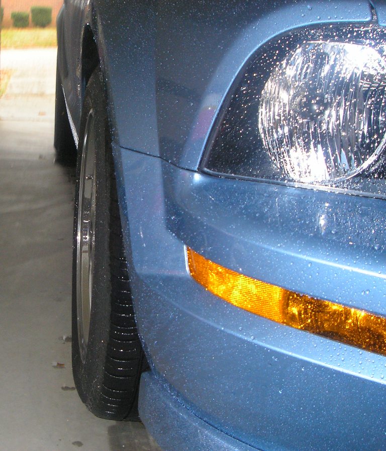

Here are some pics of my FRPP Chrome Mach 1 Wheels that are listed as being for 1994 to 2004 Mustangs. They do stick out a little more but I like the look.
Attachment 13396
Attachment 13397
Attached Thumbnails Do 94-04 wheels fit on the 05-07?-wheels.jpg   Do 94-04 wheels fit on the 05-07?-mustang8.jpg

Those look pretty good to me 1SG. Yes, it would be nice to see a shot looking down the side of the car. You have the OEM Pirelli's on there don't you?

I don't have any more pics but I will take some tomorrow and yes those are the stock Pirelli's. Figured I'd let them wear out before I get some wider tires.

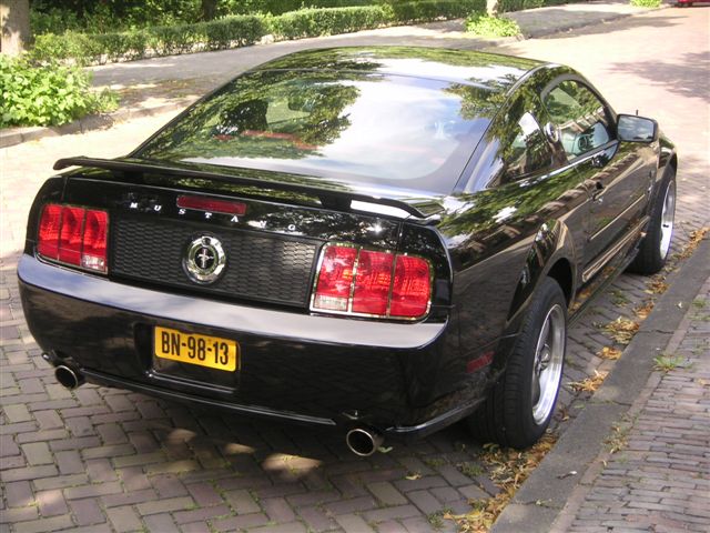

Yes, they will fit. The offset difference is not that big, but be careful at how wide the rims/tires are!
I have 17x9" 99-04 Bullitts with the stock '05 Pirellis and they're right at the limit under the fender (maybe 1/8" inside the fenders).

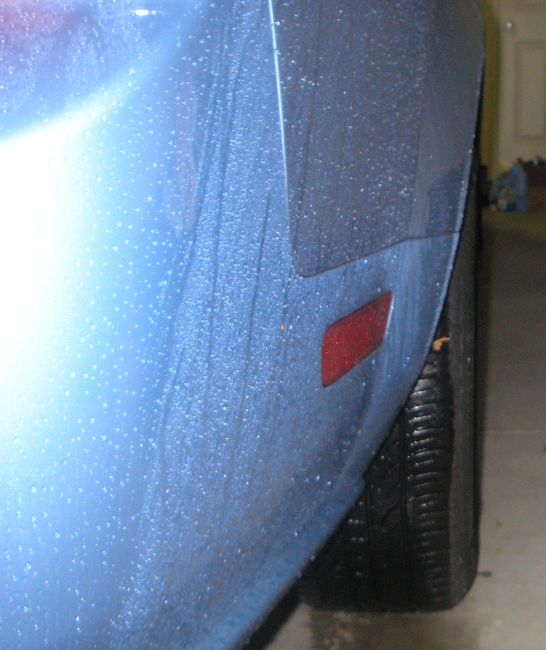

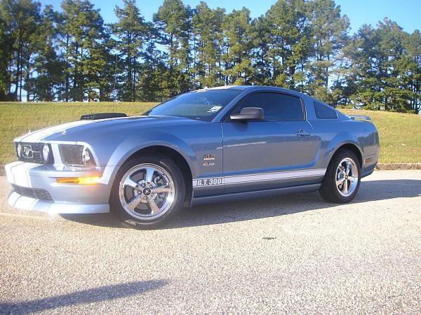

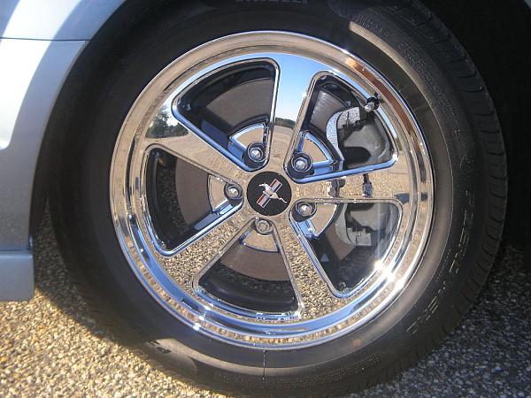

Here are the pics of mine. They are FRPP 17x8.

Since it has a different offset is the handling any different, any noticeable differences in ride quality or anything like that? They don't look like they are sticking out at all.

I haven't noticed any difference in ride quaity or handling. I think they stick out about 1/4 to 1/2 inch more than stock.
