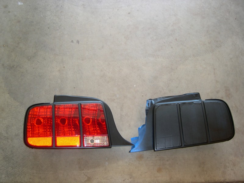

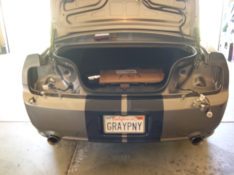

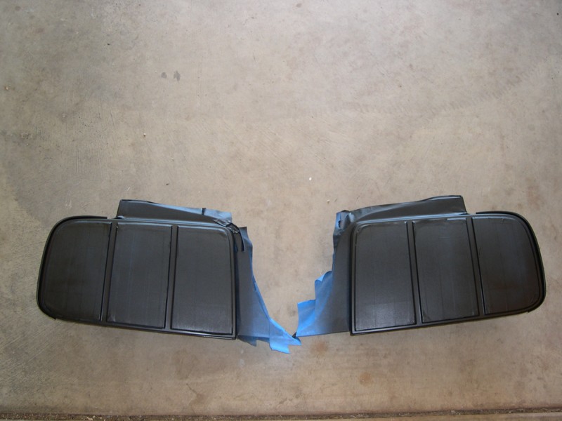

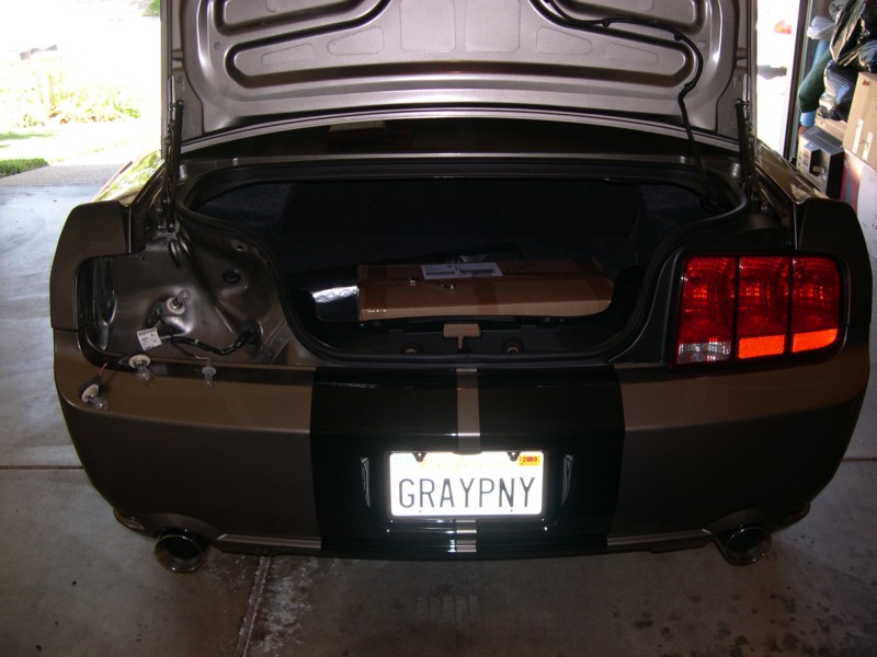

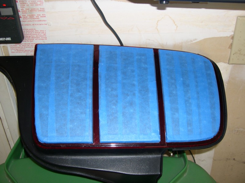

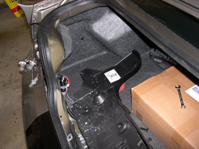

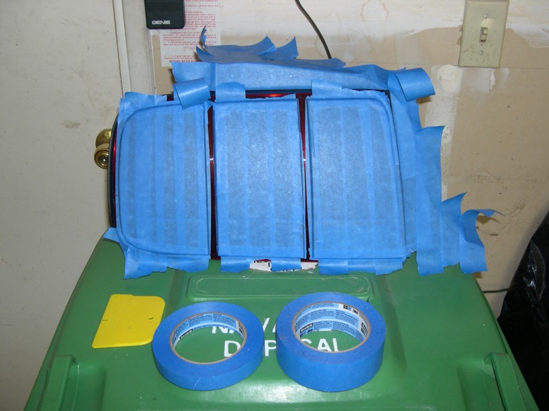

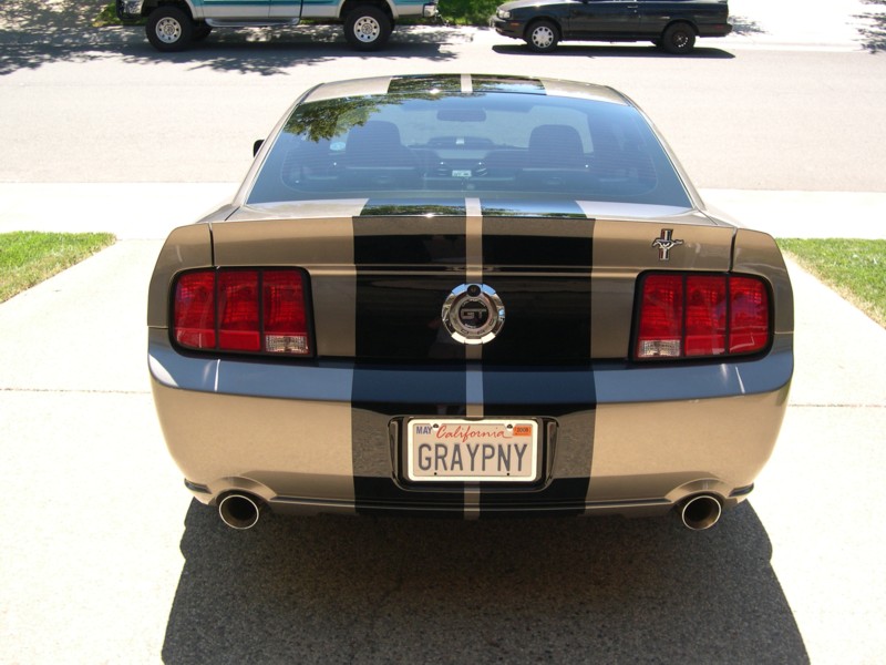

I did this quite some time ago and I know that there are alot of new S197 owners here so I thought I would post it again.
I removed the the tail lights taped them off and sprayed them with flat black paint. I always thought that there should be something to seperate the lenses alittle. Anyway here's the process and after 2 years of painting them they still look like they did that day. BTW, the most time consuming part is taping off the lenses.
Attached Thumbnails Cheap tail light mod-picture-004.jpg   Cheap tail light mod-picture-005.jpg   Cheap tail light mod-picture-006.jpg   Cheap tail light mod-picture-007.jpg   Cheap tail light mod-picture-008.jpg

Yep, I recall the original post. Still a really nice and very nearly free mod

What kind of paint did you use? I was thinking this would be a good time to use the Krylon Fusion for plastic, I wonder?

This a great mod. I finally did this last week. Got a compliment from my neighbor as I was reinstalling them, but not what you think. Said "Wow I couldn't tell you even did anything, it looks factory". Taping it up is a pain in the *** though.

Do you cut the tape at the base of each light? Or just on the top surface of the light?

I cut the tape at the base of each lense. More work on the masking but I wanted the whole lense to show, not just the top. I can't remember what brand of paint I used but it was flat black. I didn't want the black glossy.

I cut the tape just like GRAYPNY did in the pics (towards the base of each lens, about halfway down the bevel (where it curves into the base). I used Krylon indoor/outdoor satin black. prepped with rubbing alcohol but soap and water would do just fine. No sanding involved.

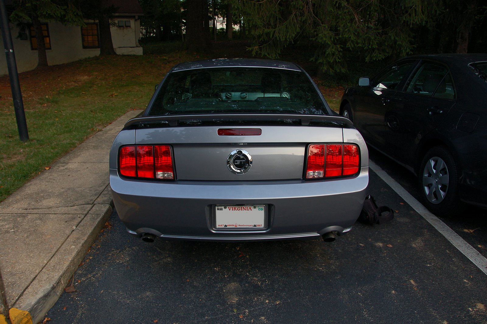

Pic of satin finish if anyone's interested:
