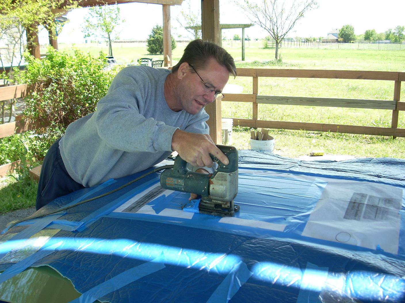

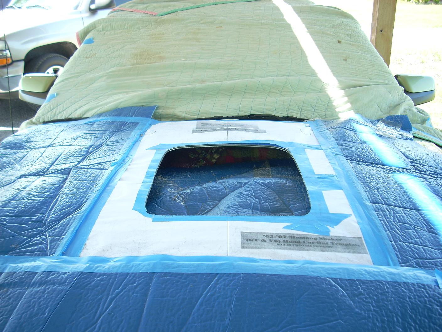

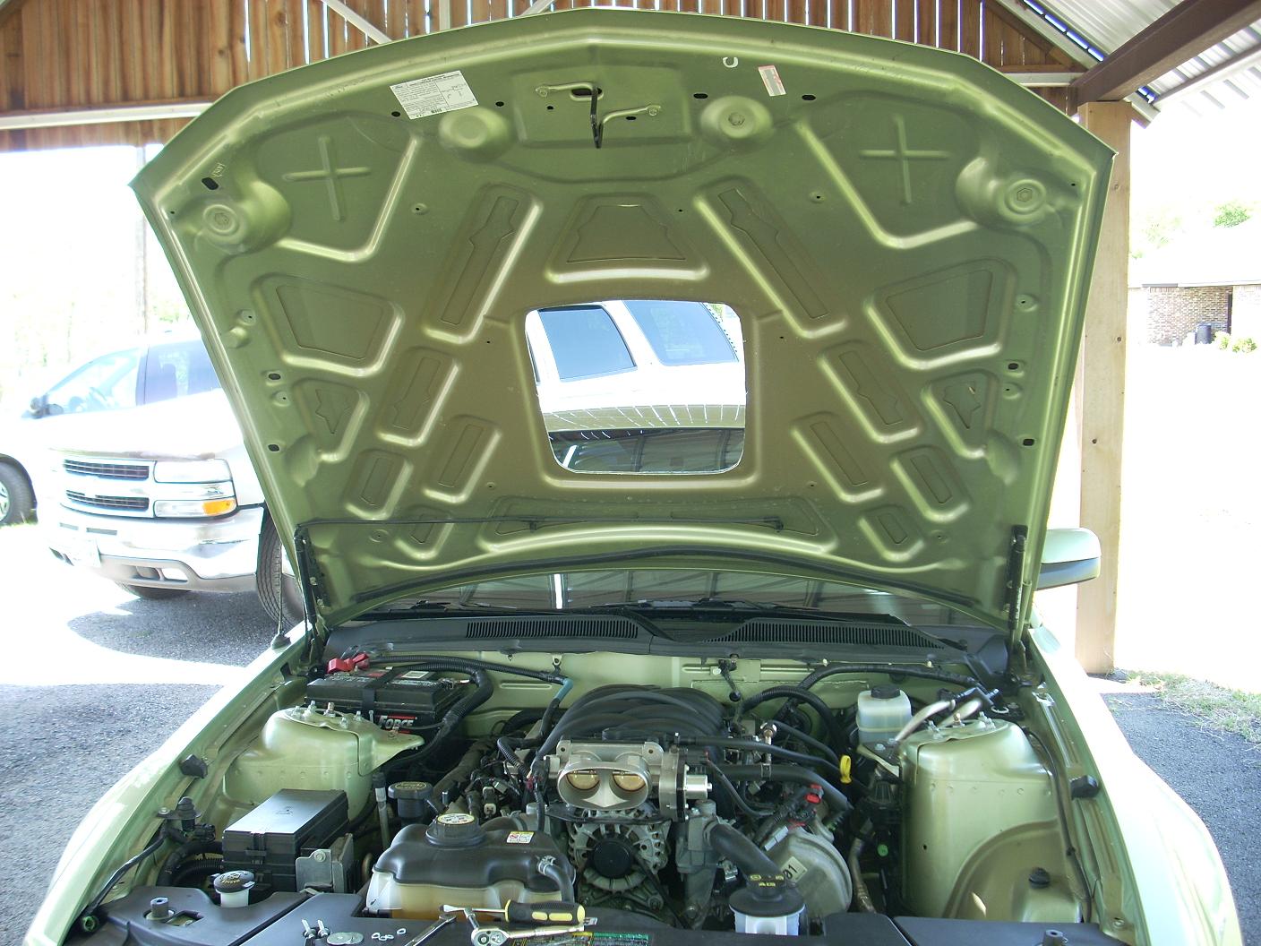

[/IMG]
Man up and make the cut! LOL
seriously, it takes a bit, but its not hard. Install the templet, check you measurments and check em again. You can do it, not 6 hours. Hoods aluminum, so no rust, but seal the edges anyway.
