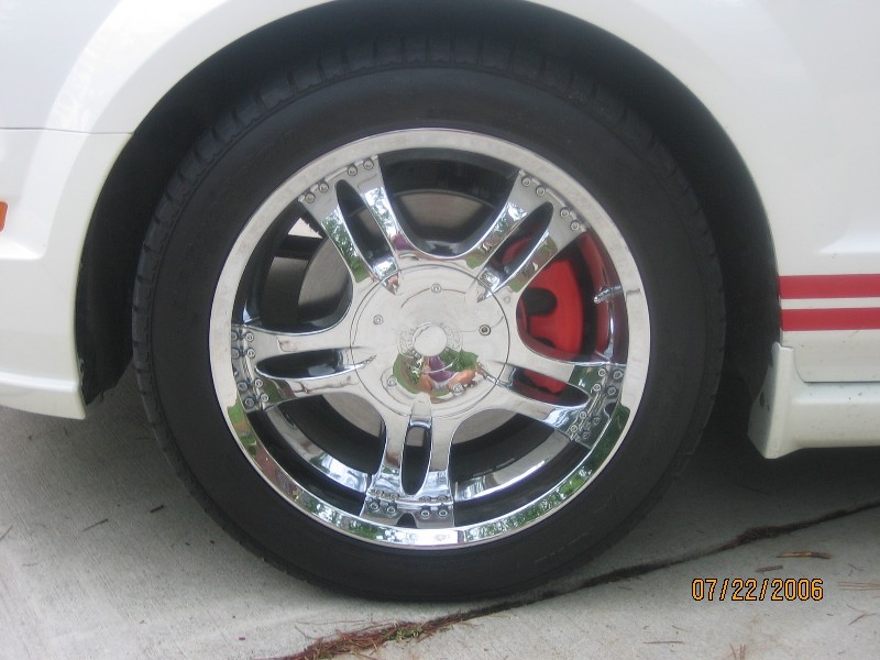

You really don't need to buy a caliper paint kit. Last July I painted mine with Apple Red Rust-oleum Painter's Touch multi-purpose latex. After thoroughly cleaning the calipers with rubbing alcohol, I put two coats on each caliper using a sponge brush. After almost a year, they still look great (other than a little brake dust). I think an 8 oz. can was only about $4 or $5.
It is kind of tedious to do......took me about four hours from start to finish.
