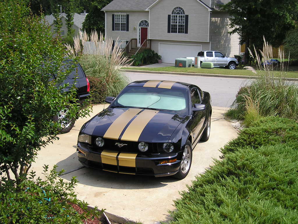

Oh and here is a pic of the stripes.
Cheers
Old Jun 25, 2006 | 09:55 PM
Looks great!
Thanks for the tips, Oh well though for waiting two days to get the stripes wet. been raining for the last 4 hrs. Think I will wax it a little later this week, as many bugs as there are around here I am sure to get stains.
Cheers
That looks OUSTANDING! (I love '66 GT350H's)
What are the measurements?
Old Jul 8, 2006 | 10:22 AM
65 A code's Avatar
Joined: October 20, 2004
Posts: 115
They are 10'" stripes with 2" gap.
