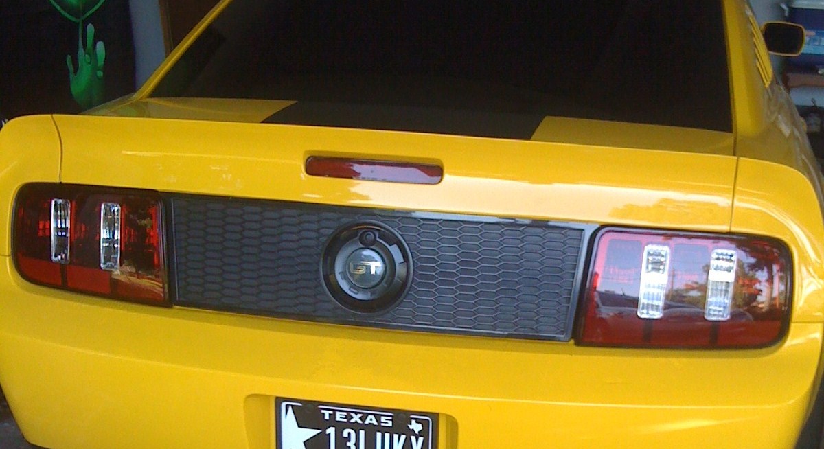

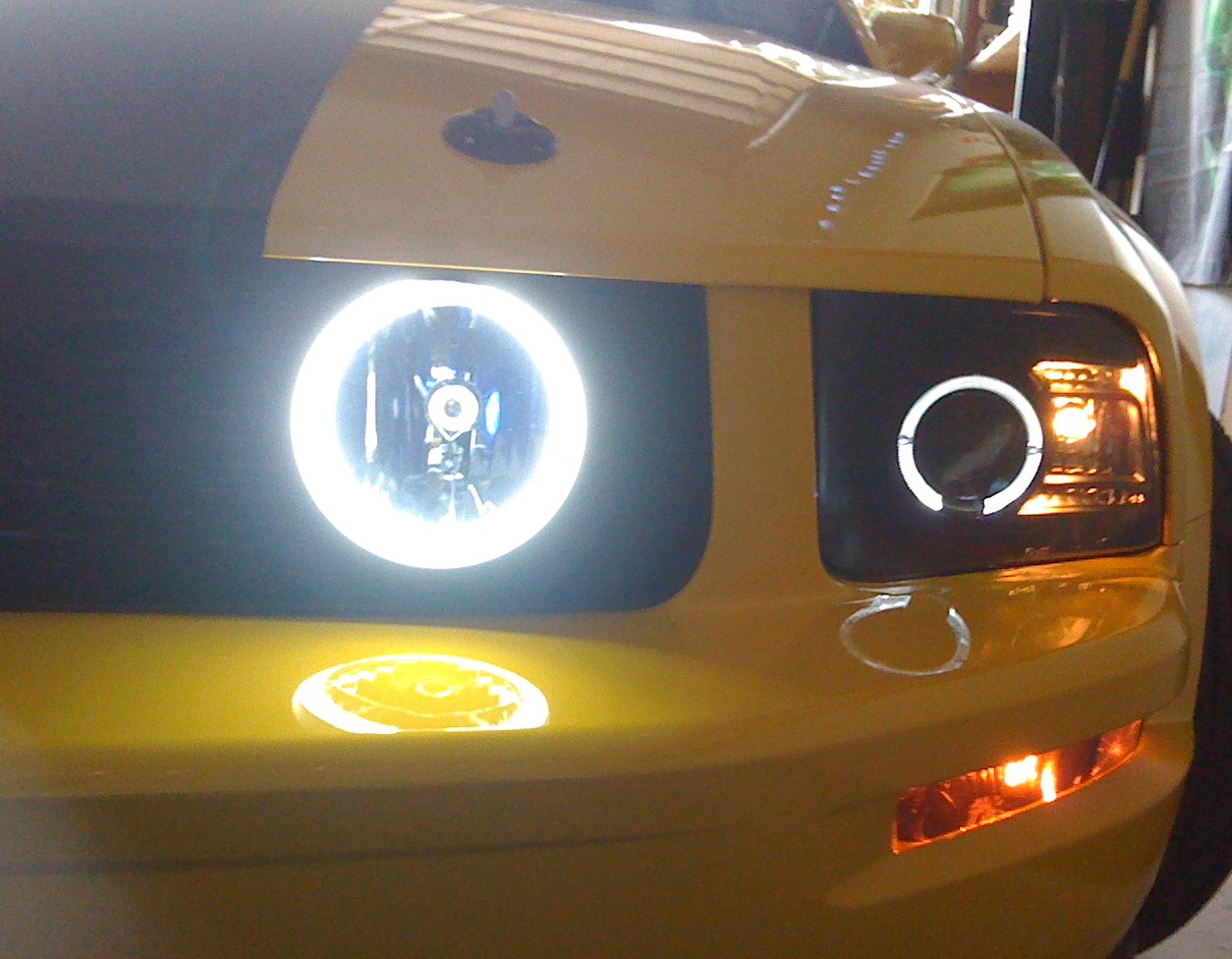

* headlight
* Taillights
Attached Thumbnails '10 upgrades for my '06-015.jpg   '10 upgrades for my '06-014.jpg

Where did you get those taillights from? They look pretty cool.
Old Aug 13, 2010 | 05:44 PM
ARBO's Avatar
Joined: August 25, 2004
Posts: 929
From: Tri-Cities, WA
Are the new tailights sequential?
Old Aug 13, 2010 | 09:53 PM
wallace's Avatar
Joined: July 28, 2007
Posts: 412
AMERICAN MUSCLE
No
lots of people seem to LUV the idea of these lights for the 5-09 car.
a much need improvement and REFRESH after a few yrs of ownership (4)
Just use the usual sequential kits...
Old Aug 14, 2010 | 09:18 AM
ARBO's Avatar
Posts: 929
I would like to know if that would work. I don't know what the light holders lok like in the new tailights.
I don't want to loose my sequential. I did see a black Stang with these and they looked awesome!
Old Aug 14, 2010 | 09:05 PM
wallace's Avatar
Posts: 412
you will NOT loose ur sequence lights, these are the same SET-UP as the '10 car and SEQ come standard on IT. PLUS i've just ordered a set myself, STAY TUNED!

I checked the the install info at American Muscle and see that a person just uses your on harness (stock or sequential). That's great.
Now a question, with only one back-up bulb only one of those two back-up lenses must llight up, right?
They are definitely plug and play! And yes you will only have one back-up lamp unless you modify like I did and cut a hole in the unused lens section and add a 194 bulb and socket spliced together with the original back up lamp bulb and socket.
Hard for me to capture sequentials in action unless I do video...

Thanks for the back-up lamp info. I will do that. I have the original/stock wire harness. So, just splice same wire colors together to match up for the second back up light? And, have you had no problems with fuses for the extra power used?
cool pics!
also thnks for the ideas on the reverse light.

I sooo thought about that but didnt know how I would get all the crap from drilling out of the tailight
when it fell through. lol
Looks awesome...I Put a set in the Mrs car last May -here

That raises a good question, how would we get all that "crap" out after drilling hole????????
Watchdevil, what did you do????????

I dunno.....when I blew it up using my special patented CSI software I see
all kinds of drilling debris in his light!!
J/K....I think I may do this...Looks awesome....but I may have to drill it upside down or put grease on the bit or something.

ok...I bought the pigtail sockets, wire connectors and 194 bulbs.
Im gonna try it. Ill let you know how I fare....

yep! thats the pic that SOLD me on the idea of THESE particular lights...
SO ahh! THNKS!

I ordered the taillights yesterday, so please let us know how you get that extra back-up light done without having it full of shavings. Then I can do mine right when that ups package arrives.
