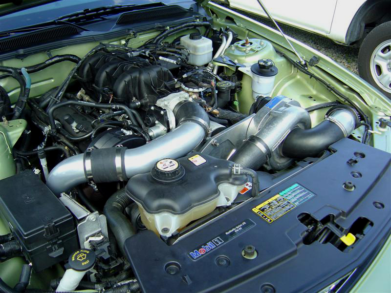

I finished installing a ProCharger yesterday. It took about 10 hours total between Sat afternoon and Sun.
Going to get it dyno tuned ASAP but my first impression is OMG! the V6 grew a pair .....and I didnt even go WOT.

Nice job man!!! looks good. I though the same thing when I drove off in mine after it was put on. lol Do you have the D1 or P1 unit? How much boost are you running, 10psi? Don't ya love the sound lol I love the BOV! I like when your going through a parkin lot in 1st, it sound like an airplane is landing on the strip! lol Everyone turns there heads

I have the P1 unit...10lb......39lb injectors.
Love the sound almost as much as the additional power.

Well I finally got the dyno done today.
310 horse and 297 torque.
I had it done at Steeda. Alot more responsive on the bottom end and all around better feel.
They didnt use the tune that came with my kit, they started with a different tune from SCT. They also seemed to have eliminated the wrench light I had coming on and going in fail-safe mode.
