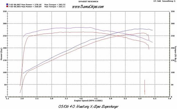

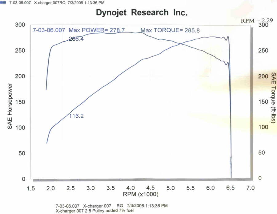

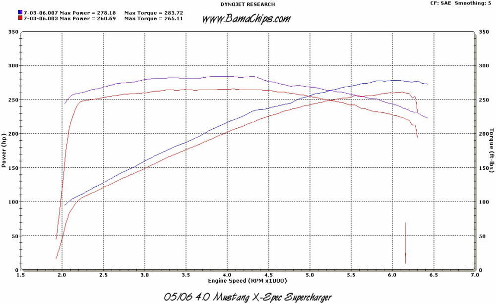

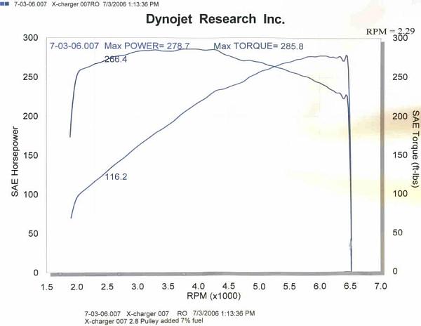

Hey guys,
Well I've done my first X-charger install and it took the better part of a day I had a mishap with a connector and we were working to help make the instruction manual. Either way it went well and we were using a new style air intake too, this is the Non-emissions kit or the 49 state kit.
That was on Sunday and then Monday we went to the dyno. We first started out with a 3" pulley and made 262 rwhp and 266 rwtq. The X-charger was in true Eaton style with the Torque starting and nearly maxing out when ever I started the dynopull, it did go up a little. Most pulls were started around 2000 rpms.
Next we pulled the 3.0 pulley using a puller and installed a 2.8. The numbers jumped to 278 rwhp and 285 rwtq. At 2300 rpm's it was making 266rwtq! We then backed it up with a pull at 277 rwhp and 282 rwtq within 2-3 minutes of this first pull.
The posted dynosheet doesn't show the line on the graph very well, my scanner isn't too good I guess, but the 266 number is on a line made at 2300 rpm's.
On the test drive we further confirmed this "Torque Shelf "as the tires off idle when floored would just light up in smoke. Also the IAT temps under normal driving hoovered around 125-135 degree's which is great for daily driving.
From there it was getting later on in the day and Mike was heading back to Maryland so we just installed the boost guage and we had a water injection kit there but the instructions were marginal at best and we didn't have enough tools to do the install. I dont recommend the Cooling Mist Water Injection setup, for the price go Snow Performance.
I will post up some more dynographs when I get the files from my laptop. For now here's a scanned in sheet from the dyno.
I must thank Mike for coming down for the install and dynotune and Larry for coming over and helping with both. We had a few questionable moments but other then that the install went pretty smooth and the dynotune was even easier, it took us longer to find a pulley puller then most of the tuning.
Thanks, Doug.

Very impressive! Looks like it makes power all the way up to 6500rpm and probably beyond. So to anyone who says the X-Charger won't do well in the 1/4, I say you're wrong!

Holy ****!!!!!!!!!!!!! Look at that TQ curve, this is very impressive. This setup can hit mid to low 13's with the right suspension, mabye even better.
Wow, most impressive, back to back pulls putting down nearly the same numbers.
****, I'm a believer now. This is good for the autos, that without a stall can only launch at 2000 to 2500 depending on DR's. This means auto guys can get their 60ft times down with that 266rwtq available at launch!!!!! I see more 6's at the track suprising people, not to mention the sound this kit makes, people in the stands won't know what to think.
And the operating temps on this thing is right on. I'm impressed!

These are great numbers! What a lovely dyno sheet!
Doug... was this install on an auto or manual? Any other mods on Mike's ride?

WOW!! That is awsome!! Nice job Doug.. Thats the kind of power I knew the Xcharger could make..
It is unbelievable its making all this power so low in the RPM band.. Your going to definatley need slicks at the track for this setup.. That is a tremendous amount of power off the line.. Way to go... I would have loved to see a dyno pull video..
Also Doug, I noticed you spun it to 6500RPM's... Are you saying you approve of the SOHC 4.0 of spinning up this high? Also the theory in regards to the SOHC is that it is able to actually spin faster.. Basically the SOHC design was built with high RPM's in mind.. In terms of the cams being on top..
Could you please explain for us your complete thoughts on the SOHC 4.0 and its true safe rev limit abilities..
In my wildest dreams I would have never thought we would see one spun that high.. However, I have read that the motor was designed for high RPM's... Thanks!
For the record, thats 1000RPM higher than my last dyno! LOL!! Jesus Christ I am blown away by this.. WOW WOW WOW!! Nuts I tell you... Incredible!! I have fallen and I cant get up!! Help me Doug! Explain this extraordinary dyno to us!

yeam im at about 9 lbs boost at 6300 rpm i put the 2,8 pully on for testing but didnt realy want to say anything untill doug finshed his install. the car is def more punchy with the smaller pully. i hope this install gets some off the fence and im interested to see how some other installs go.

The pulls went up to around 5200-6300 like before said but I have no problems taking the 4.0 SOHC upto 6500 even though it's not going to make anymore power. If you'll note on the dynosheet it made power up to around 6100-6200 rpm's but I wanted to see if it would go any higher as on most of the earlier runs I stopped at 6000.
The 4.0 SOHC has a built in stud girdle on the crankshaft and the heads are made to flow alot better then the earlier 4.0 OHV's, this is where they picked up the 47 hp over the OHV that used to be in the ranger's and explorer's, the heads. Still though they only made 5 ft/lbs more Torque.
With a set of improved camshafts and ported heads I would say the SOHC would make power well into the 6250-6700 rpm range. Of course you would also need the headers and decent exhaust to aid flow.
Also, I have some pictures of the intake used on the X-charger kit and it has a straight shot intake right down to the tip of the valve, you can actually see the intake valve looking down the port of the intake. With this improvement I would say that helps out the design flow as well.
One other thing that backs this theory is I've tuned a M112 on a SOHC and it stopped making power around 5600 rpm's but the intake design was nothing more then a flat peice of rectanglular metal so the flow rates were very different. Even though the M112 flowed more the poor intake design wasn't allowing it to make the best power.
The sound, it is very quite unit you either floor it or just get into the boost. With the open 9" air filter used on this kit you can hear it sucking more air but you can't hear the charger unit you are in it. At idle or just rolling though like a parking lot it is absolutly none exsistant.
With the 2.8 pulley it was making 5-7 psi upto around 3500 rpm's and then it would creap upto 9-10 psi. You would think it would make max boost at low rpm's but it is still a charger and builds boost as speeds increase, still it makes boost instantly at low RPM's so this is why the torque is so very high at low rpm's. 9-10 psi on a stock bottom end is absolutly fine as long as your tune is right. His tune is perfect and his timing is still so low that if he were to get his water injection on we could add another 2-3 degree's and I'm absolutly positive we could reach 300rwhp with no problem.

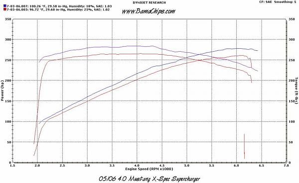

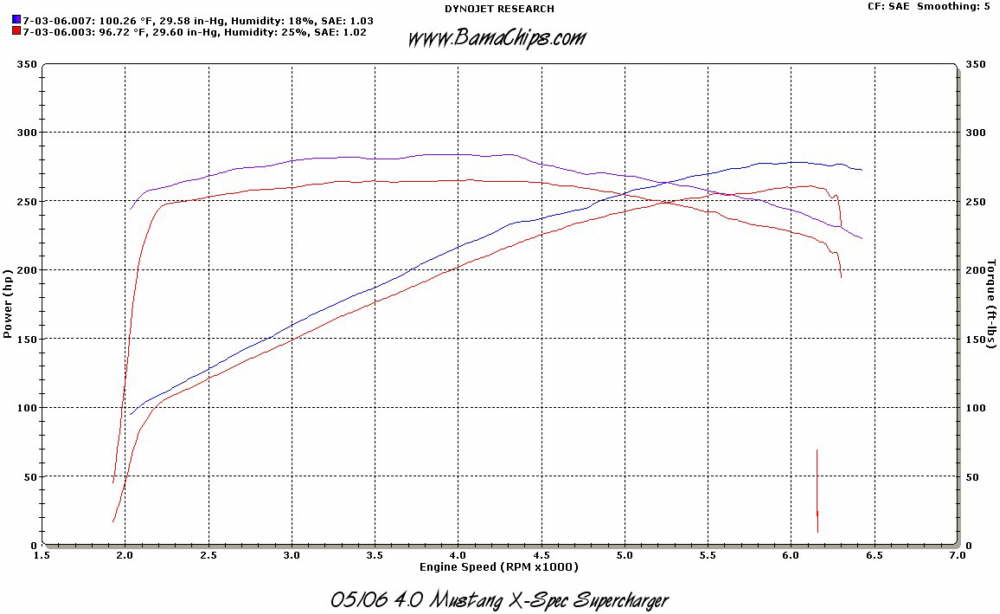

Hey guy,
The Paxton kit is quoting flywheel numbers and they are Hp, not Torque. Giving the manual transmission 15% of driveline loss at 278 rwhp x 15% = 320 flywheel hp and 328 Flywheel torque. They are using an intercooler as well.
I was reviewing a few things on the dynoruns and I found something else that was probably even making us loose a few Hp, it was 100.26 degree's inside the dyno!! I've made a comparison between the best run with the 3.0 inch pulley and the run with the 2.8 pulley. I've attached them both with the only difference being that one displays max values and the other displays conditions the runs were made in. Both are the same two runs as shown in the names run 003-3.0 pulley, run 007- 2.8 pulley.
Man what we could have made at around 65 degree's outside
Attached Thumbnails New X-charger numbers with a manual....-v6manualnumbers.jpg   New X-charger numbers with a manual....-v6manualtemps.jpg
