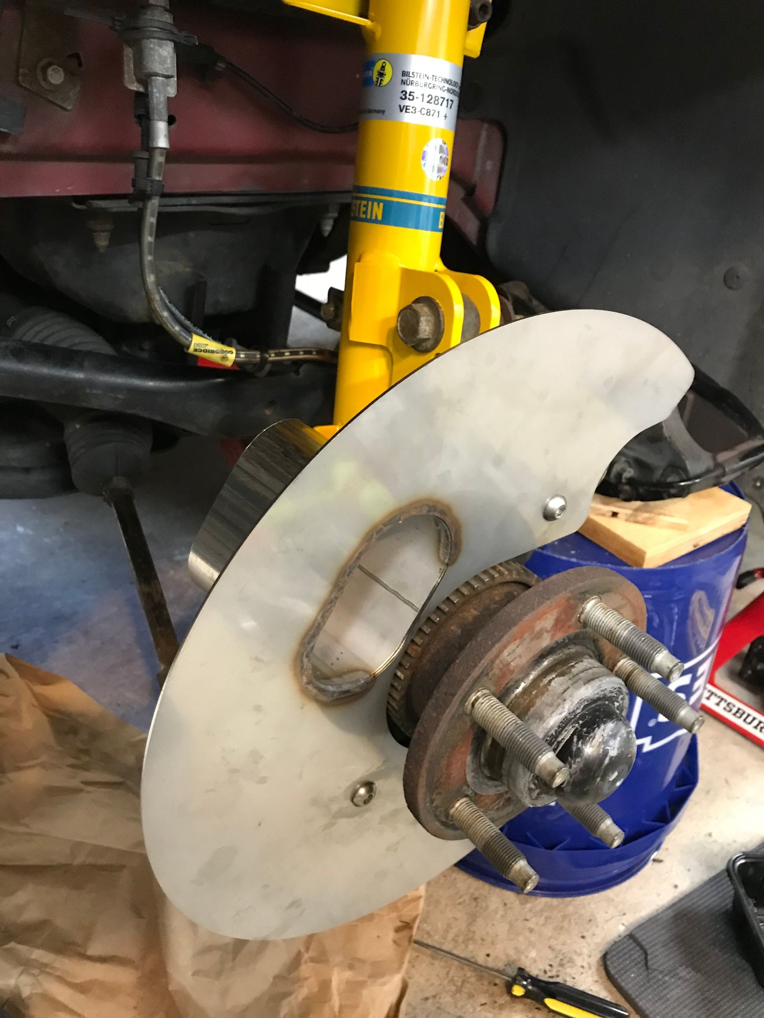

. . . . really curious as to what the part number is for your Bilstein front struts.. By any chance is the part number stamped on the front struts, part number 35-128717? If that is in fact the correct part number? this would be the same part number for Bilstein B6 HD front struts, according to the Bilstein website. Meanwhile, if you could find this info out for me? it would be really helpful and appreciated.
yep, I have been wondering about the great "shorter strut" mystery for a while too . . . would need to take a wheel off to look at the struts, but I might be able to read the part number in a picture, will take a look later
Same here about the shorter strut mystery too. From what I saw in the Vorshlag display images on their website, it does appear to have the Bilstein B6 HD part number 35-128717 stamped on the strut. If by chance the part number for the Bilstein struts aren't listed on your sales invoice? Then the only other way to find out for certain, would be to either take a wheel off or turn the wheel to full lock away from the strut to read the part number

I found a picture . . . . part number looks like 35-128717 but there is another number VE3-C871+ which could be some kind of custom variant or something, don't know.
So it sounds like the "shorter strut mystery" is a myth, or perhaps pure intentional BS, depending on how you look at it. I have seen some other posts that also say the part number the Vorschlag sells is the same normal part number that you get anywhere else for a Mustang GT. I think the price works out about the same; however Vorschlag will not sell their "special shorter struts" without the complete spring and mount kit, which is what I bought. I did it mainly for the mounts and the convenience, but it is a little annoying to know that I could have just bought the mounts and assembled with my own (new) struts and springs. Like I said before I might end up swapping the springs back to the Steeda Sports after all.
According to my research, the part number stamped below 35-128717 is part of the old one. The only difference is the old part number had F4- VE3-C871 H0 vs VE3-C871+ on the image you posted. Anyhow, I suppose the only way to find out for certain, is to contact Bilstein directly by providing the VE3-C871+ number to determine if this is in fact some kind of custom variant of the Bilstein B6 HD damper in regards to the shorter strut mystery or if it's the very same? I've also seen and participated in other Mustang forums which also state the Bilstein part number included with the Vorshlag pro/street kit, which is the same normal part number that you get anywhere else for a Mustang GT. At any rate, this was my main reason for contacting Vorshlag in regards to the shorter strut mystery claims. Needless to say, they also told me they do not sell their "special shorter struts" without the complete spring and mount kit, and then after requesting the part number for their supposed "special shorter struts" not only did they refuse to provide the part number, but they also refused to sell me their " special shorter struts" along with their shocks without the complete spring and mount kit as a stand-alone option, despite knowing full well that my car already has lowering springs, including GT500 strut mounts. Therefore, what's the point in having to buy a complete spring and mount kit, when it isn't necessary, to begin with, lol. As far as I'm concerned, this alone was more than enough reason for becoming suspicious in regards to the Vorshlag "shorter strut mystery claims" which also brings to mind the most important question, which is what other legitimate reason would they possibly have for refusing to provide or reveal a specific part number, unless they obviously have something to hide, in the first place lol.

I went through pretty much the exact same conversation and scenario. In the end I decided to go for it, knowing I might be paying extra for nothing.
Anyway it is a good setup, their upper strut mounts are gorgeous, and it was very convenient to have the strut/spring/mount pre-assembled; and I'll never know exactly how much I paid for that convenience, LOL.

I'm glad that it's a good setup and working well for you, however, after the conversation I had with the company owner, he failed miserably to earn my trust as a potential customer. Needless to say, if the vendor/owner is unable to provide excellent customer service in both a professional and respectful manner by addressing my questions and concerns in an adult, honest and straight-forward manner? IMHO, they're not worthy enough to deserve my business, to begin with, despite how good their products may happen to be. That being said, just my $.02

Just got off the phone with John from Bilstein tech support, located in California. After providing him with the VE3-C871+ number from the image you posted, he said all that is, is just the manufacturing number and confirmed is the very same Bilstein B6 HD damper you can purchase from any other vendor/distributor for the S197 Mustangs. He also fully addressed my questions by confirming that you do in fact have the Bilstein B6 HD dampers and not some "special custom variant" that doesn't exist which Vorshlag Motorsports claims are 1.25" shorter.
Meanwhile, for what it's worth, just wanted to follow up by providing you with an update.

Also spoke with Caleb from Summit Racing. He also confirmed the shorter strut mystery which in his exact words are "Bogus" So there you have it, from yet another reliable source.
