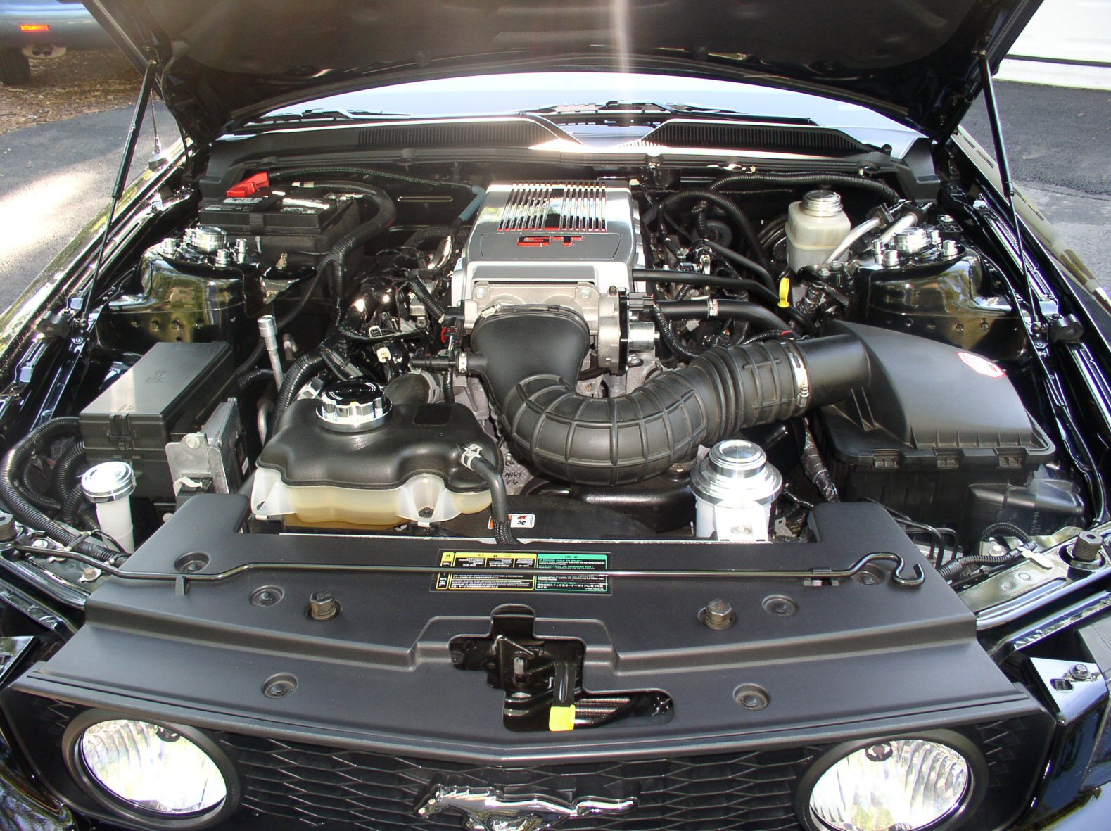

Pictures of before and after shots with the WMS system. Main reason I went to the WMs is the way it takes in the air flow. I improved onthat by taking out all the honeycombs in the upper grill. That should increase airflow to the system through the 3 access holes in the radiator cover. Can't wait for spring to get her on the road.

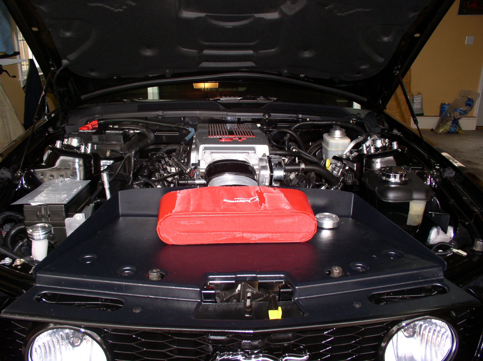

You really cant evaluate the performance of the WMS on a Dyno unless you can get the cooling fan to put out a 50 or 100 mph wind to the front of the car.

This is where you can get the ram hood sealer:
http://www.mustangsunlimited.com/ite...=&CatKey=74-01
I also heard a rumor that Shannon at WMS may have the stripping.
The color to match pre filters come from Outerware they are $24.
The oil breather comes from either Summit or Jegs..........cant remember I plugged the hole on the WMS intake silicone tube.
The Strut Tower Brace comes from: Blue Oval and clears the plenum very well. A good piece and I would buy it again. (not shown but similar to the GMS shown)
All of the chrome nut covers, something like 30 or 40 come from Auto Zone size 10mm.
I prefer the straight shot of air into the intake over other CAI methods.

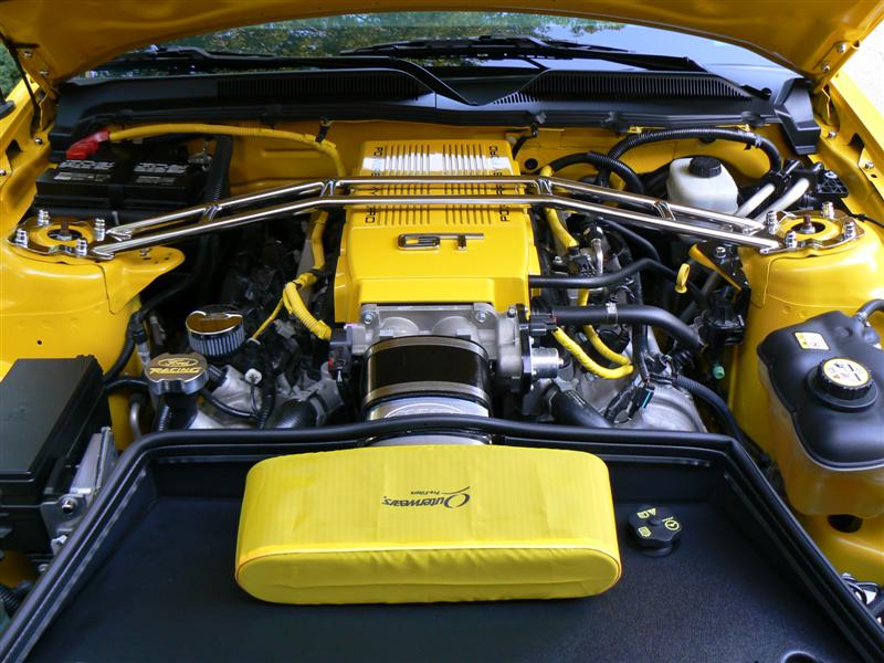

As you can be seen real well from your picture is the two 1-1/2" x 7" slots in the hood. These slots are directly above the fog lamps.
Next week my local body shop is removing the fog lamps and relocating a new set of fog lamps to each side of the lower grille. (where they will actually function as fog lamps).
The area of the old fog lamps will have a black wire mesh screen epoxied on the back of the openings. These will be used as additional air intakes for the ram hood.
Since the ram hood is sealed against the hood, with this mod I am hoping to increase the pressure in the ram hood area when the car is moving.
All filters exhibit what is call a differential pressure drop across them. I dont know what the "Delta P" is across the WMS filter but would guess that it may be close to .20"wg. (due to construction of the filter)
By increasing the air pressure in the ram hood area I hope to offset the pressure drop across the filter by some number. (all of this with the car moving)
I havent had a chance yet to hook up a manometer to the suction opening in the WMS silicone tube. (was where the other valve cover hose went to).
After the mod I will place a Magnehelic gauge inside the car and run a hose out to the WMS silicone tube so that I can see the effect the mod has had when the car is moving at hi-speed. (50 - 70mph )
There will have to be a test ran before the mod and then a test ran after the mod for any good data to be recorded.
