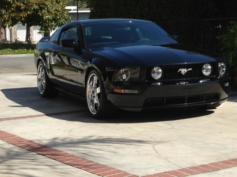

What else can I do for performance mods. I don't want nitrous, turbo or a supercharger. I don't want to spend too much as my wife keeps asking me to sell our mustang and purchase a gt500 or a new 5.0 mustang what a dilemma. lol But I want to wait to see what 2015 mustang is going to look like before deciding. But for now I just want to finish what I started. Here the performance list already done.
C and L street intake
Steeda underdrive pulleys
Steeda charge motion delete plates
Steeda throttle body spacer
Jba ceramic shorty headers
Bassani x crossover pipe
Bassani race muffler axle back kit
Coast driveline aluminum driveshaft
Frpp 3:73 gears
Autolite ht0 spark plugs
Royal purple oil engine and rear end
Predator tuner
295 hp 292 tq custom dyno 91 octane tune by gtr high performance
