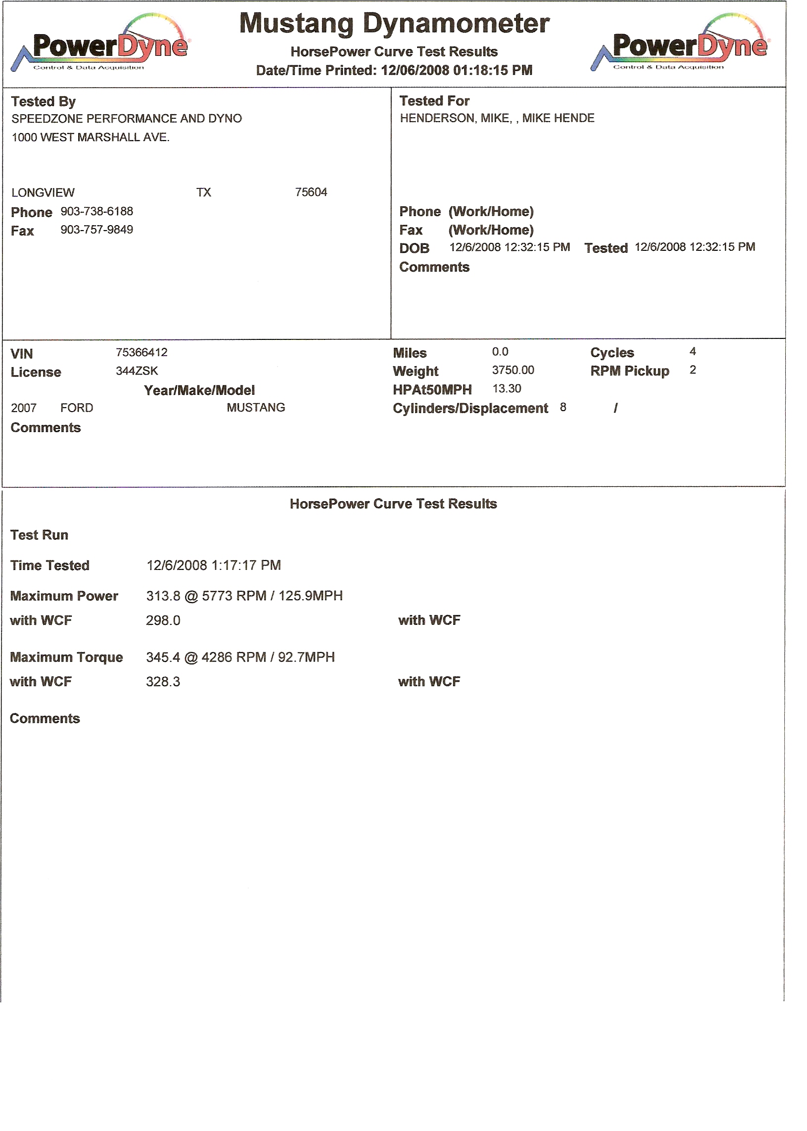

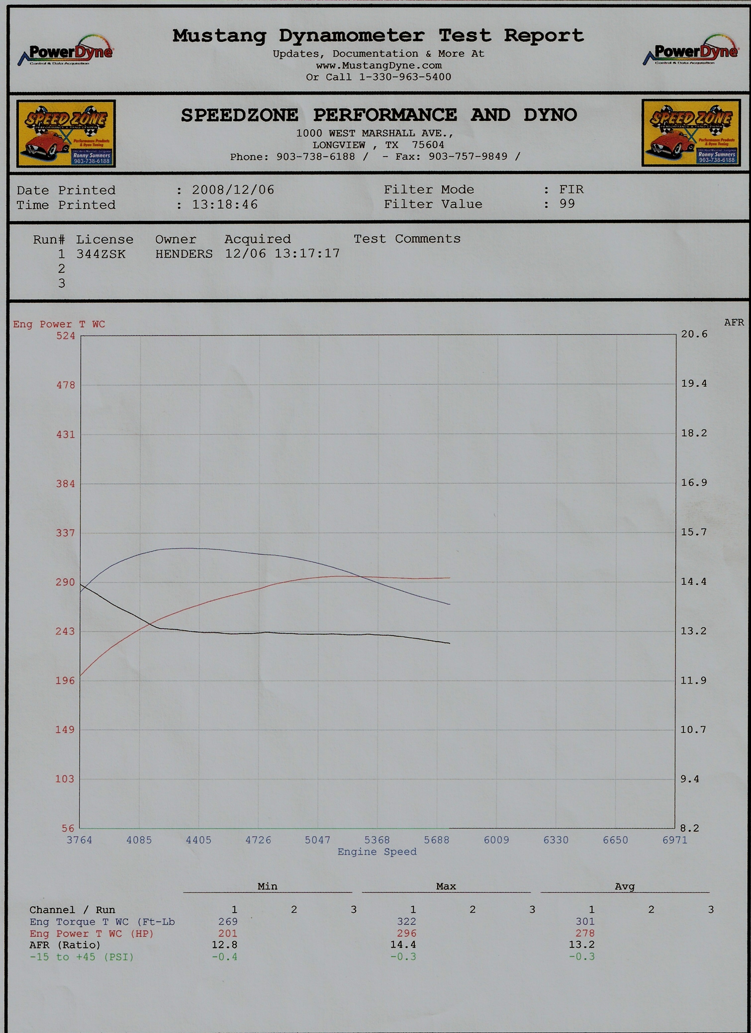

Had the mustang dynoed today and the correction factor used was WCF?

If I remember correctly it means "weather correction factor".
What matters is that if you do another run after modding, make sure that it is WCF also.
SAE correction kinda corrects for the weather too.
The important thing is to compare numbers done with the same correction factor on the same type of dyno.
Apples to apples.
