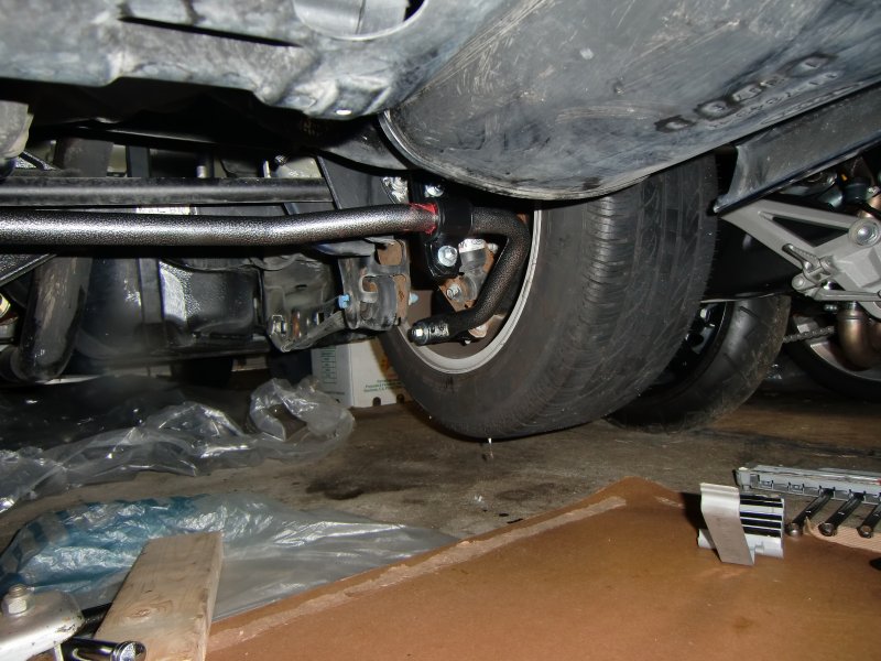

I purchased a BMR adjustable front bar and a Hellwig adjustable rear bar for my GT several months ago. I finally got around to installing them today.
I actually have not finished the rear bar, but the Hellwig is a 1" hollow adjustable bar. The instructions say to flip the panhard bolt so that the bolt head faces the sway bar for extra clearance. Sam Strano's bar looks almost exactly like the Hellwig setup, but I am not sure if Sam recommends flipping the bolt.
What I did was not touch the panhard bolt and use the mildest setting for the rear bar. Hellwig states that this is the nominal setting and to use this as a starting point. A YouTube video indicated that each hole produces a 10% difference in roll bar stiffness, but I kept the mildest setting to retain a similar geometry as the stock sway bar.
I noticed that it is very difficult to tighten the axle bracket bolts because the bars aren't perfectly parallel with the bushings. It is a hodge podge of bolts, brackets, and linkages. The hollow rear bar may be lighter than the stock bar, but all the steel brackets and bolts needed to link together the aftermarket bar more than offsets the weight savings.
The BMR front bar looks simpler, but I will have to install the new replacement OEM end links at the same time. These newer OEM end links seem beefier and lighter (aluminum versus factory steel).
If I had to do this again, I'd avoid purchasing the bars and keep it stock. I'd just ride my Ducati on the good days, even being the smallest entry-level Ducati, it is still faster than the new 2012 Boss 302.

I am going to start the BMR front bar install, but noticed that there are no instructions for the front bar. I have no idea which part of the bar faces forward/up/bottom as there is a curve in the center part. I guess I'll find out when I crawl underneath the car.
BTW the rear Hellwig bar install progressed smoothly. Once I torqued down all the bolts, it seemed like a solid kit. I just wish they made it a little better. The non-adjustable bars are like 22mm while my stock bar is 20mm. The Hellwig is 25.4mm, and is inherently shorter than the non-adjustable bars.
My plan is to use the setting on the front bar that retains the original end link geometries. Since the holes only yield 10% changes in stiffness, I am not going to play with those settings and just pick one (softest or middle probably).

The stock rear bar was a solid 22mm bar, the Hellwig adjustable rear bar is tubular spring chrome-moly steel (4140 or 4130, don't remember) of 25.4mm in outer diameter.
I am using the "softest" setting, which makes the bar the "longest" at the pivot point. I watched a Youtube video that explained each setting differed by about 10% in stiffness, it's not a huge difference in length.
I chose the softest setting to keep the bracket geometry the same. I could tighten it up by another setting, but I'd have to flip the Panhard bar bolt around and I didn't want to mess with that at the moment. From what I gather, the softest setting improves upon the stock bar mainly with the change in diameter. The stock bar came with what appears to be black poly bushings, so Ford did a decent job in the chassis department (versus the old craptastic rubber parts they used on older Fords).
