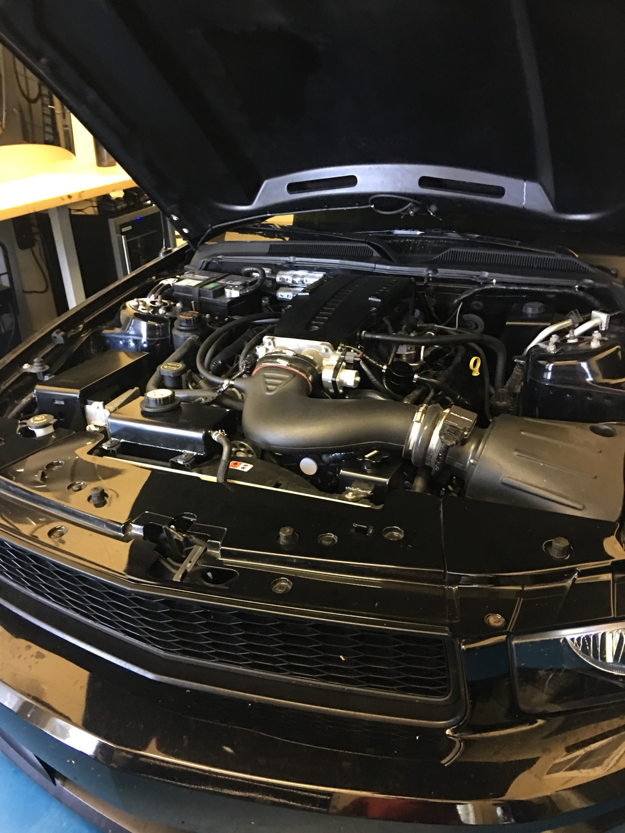

I've got the other one with the open box and just the cover piece over the filter.
Attachment 183207
You definitely have the Saleen Ultimate 95mm MAF cold air intake which has an open airbox bottom with a conical air filter.. This was actually my first choice, however none of them could be found anywhere until they became available through saleencars84 within just the past year.. So I settled for the Saleen 98mm airbox lid with hard plastic tube instead..
Old Apr 4, 2017 | 03:02 PM
It has a different MAF sensor. I believe it's from the Lightning. I had to splice it in. All this was done so many years ago. Like early 2009 I think.
I definitely noticed your MAF sensor.. They came with an upgraded MAF sensor option for supporting higher HP applications and also with non-upgraded sensor options that allow re-using the stock drop in sensors..
Looks like you got yours from Brenspeed, as they used to carry them in stock until Saleen discontinued production.. I noticed that saleencars84 has only 1 left in stock with the non-MAF sensor upgrade option and I'm debating as to whether or not I should place an order.. As I don't know if I would see a noticeable difference in airflow or performance over the Saleen airbox I have now

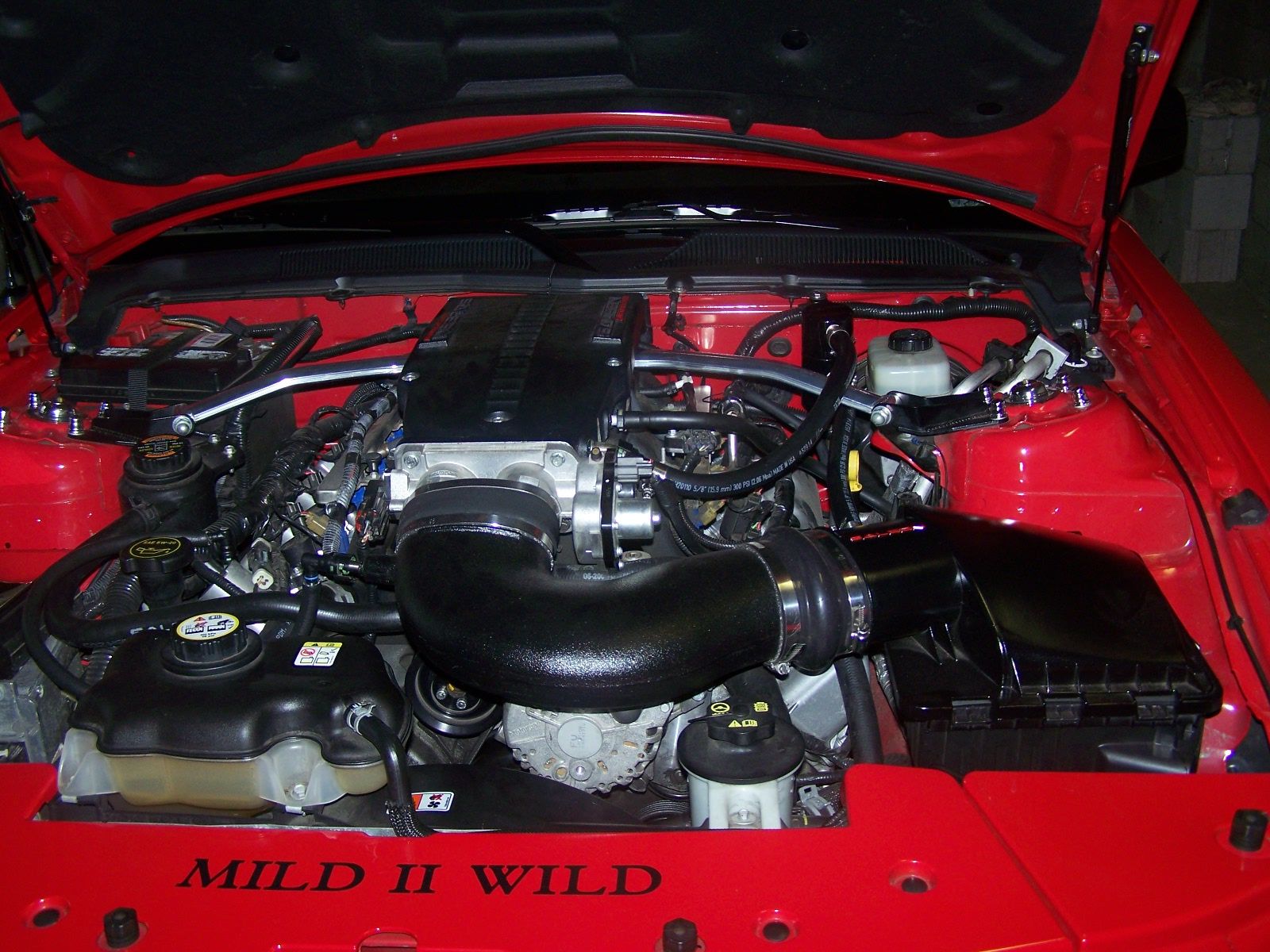

Originally Posted by 06 Screamer
Did you run into clearance issues with the hard plastic intake tube ? After reading this thread, I'm seriously thinking about getting this and a tune.
Just realize your going to have to get a custom dyno tune to run the Saleen intake.. As there are no e-mail tunes for N/A applications, unless you know how to tune yourself.. Here's an image of my Saleen VI blower with the Saleen airbox cover and hard plastic intake tube which is a direct replacement for the Saleen stock rubber inlet tube.. Therefore there are no clearance issues whatsoever..
Attached Thumbnails Steeda/Shelby CAI vs Airaid vs Stock paper/box-000_0530_831abb36fe67964e1e0c758720c67d40a4fdef64.jpg
