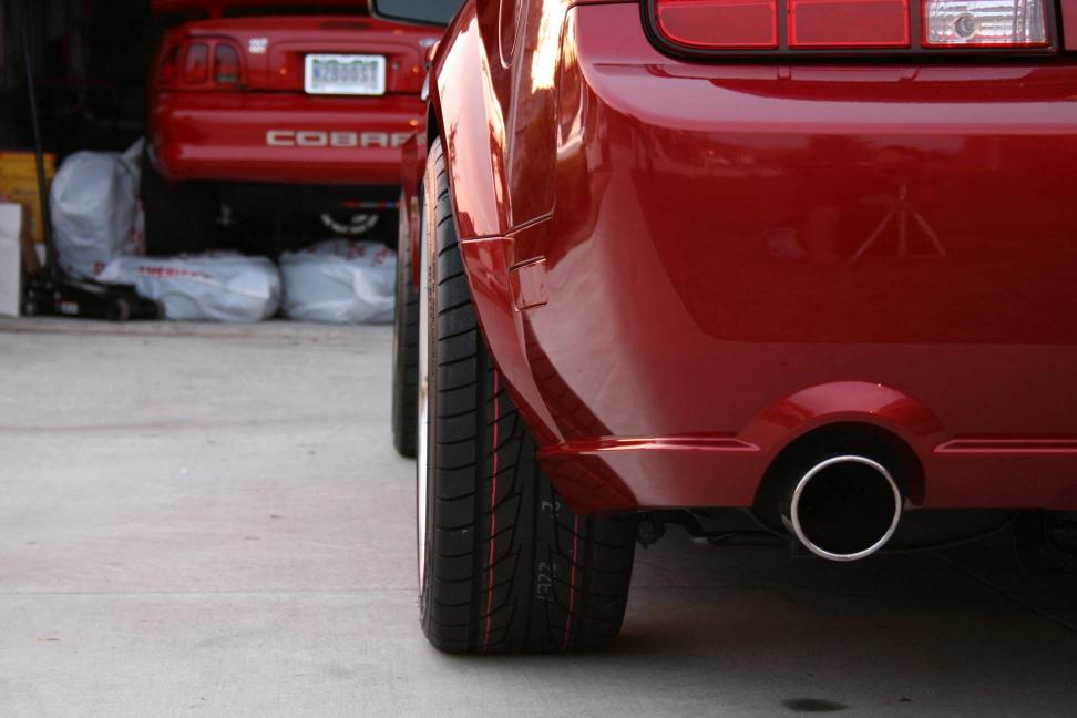

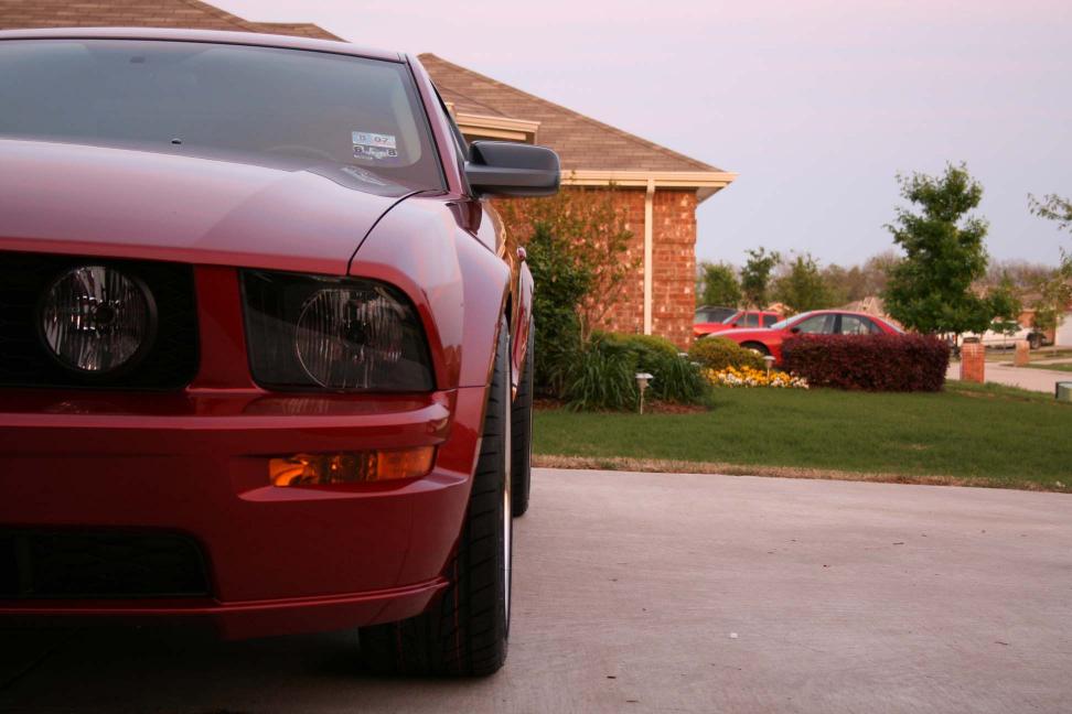

These are very informative pictures from another TMS member that runs 24mm offset and 255's on all four corners. See how close to the edge it is out back already. While it looks flush up front, it looks like the back could take a tad more width... like with 265's (43/100th inch wider). Wider it may very well rub on bad roads. Hence my setup. Now if you ran the Sportslines instead of the Pro-Kit, I would not even consider the 24mm offset. I do get that you have no rubbing issues with 40mm offset out back though. It makes perfect sense.

I think those just about look perfect.
