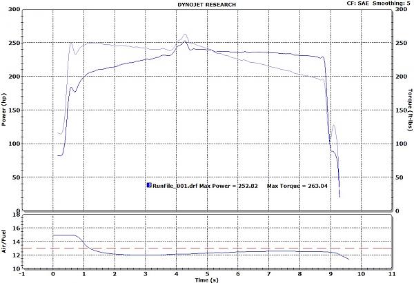

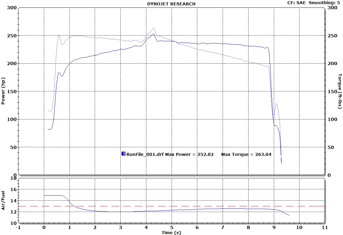

There's a way to stop it from doing it in the SCT software for a dyno pull as I had to figure it out myself on my own car. I lock the converter in manually so it's locked in as soon as the car is put in 1st all the way through 4th and then I return the settings to stock when I'm through. This makes for a nice dyno curve as you can see in one of my other posts, like K&N vs Stock pull.
The major problem with the converter flash is it gives false numbers. For example the dyno run may be at 270 and then the converter will flash up to 280 because it unlocks and causes a false load and then immediately return to 270 but the dyno reads the MAX hp and that spike would be the max number. So when you add a tuner and get a true 280 all the way across the board if you only read the MAx numbers then you dont gain anything.
Thanks, Doug.
http://forums.bradbarnett.net/showpo...87&postcount=5
Why Doug chose not to with these runs, you would have to ask him.
Addtional....
The reason it looks so weird is that the bottom axis is RPM. When the converter unlocks and them relocks you get a quick drop in RPM and the plot moves backwards. As the rpm rise, it moves forward again. If you change the bottom axis from RPM to Time it looks like this.
I get what the graph is showing now, but like on the first dyno graph for sodaman, with the GMS base run, definitely see the lock/unlock thing, but not on the run after the tune. Is it the tune that locks the converter? Is this second run that doesn't show any unlocking set up differently? Is the converter locked in that run? Also, I take it not every car will lock or unlock at same time or something? I'm just trying to find out why my dyno graph doesn't have a spike like that, did they do something to the dyno or my car?
They were probably aware of what was going on with the Automatics and locked down your tranny so they could do your pull.

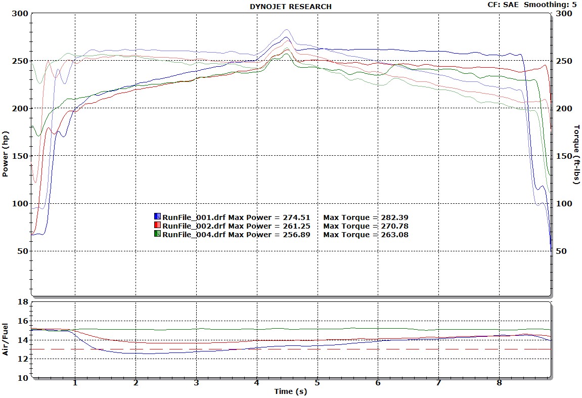

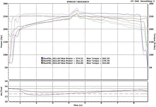

I may get yelled at for this but comparing all three stock GMS pulls, it looks to me that sodaman's (004) A/F plot is nowhere similar to the other two, I would consider that to be suspect, in that there may have been something outside the norm on that pull that caused a misread by the probe. JMHO.

This is the base stock file information. It mainly shows that without a tune there are very many different configurations that the a/f can take. I've seen them goto 5500 rpm's and then drop like a rock, the a/f that is, because of the cat temp sensors. Each UNTUNED run may have a differenet a/f ratio.
Now, on my tunes the reason the a/f is at a perfect flat line is because I commaned the PCM to go into Open loop when the TPS reaches a certain parameter. As you'll see on some stock runs sometimes it does go instantly but other times it goes into Open loop slowly, hence the drop off. There are TPS position delays and even time delays in the stock programming, this is mainly for emission reasons. On a supercharged car this can be a very bad thing in that it may goto WOT and not be in Open loop and then have a dangerous a/f ratio for a small amount of time.
The probe was never moved in any of the tests, it was always taken from the driver's exhaust tip and was securely attached.
When the cars are returned to stock using the SCT X-calibrator it will clear the Keep-Alive memory on the PCM. This will cause the P1000 code. This is the same thing as removing the battery cable for a period of time as doing so will give you the same code.
If you need me to go into detail on the converter spike as it is called then just let me know. All Automatic cars do it, if you put the dynoruns over MPH instead of RPM you'll get a bump instead of a Loop-de-loop but it does the same thing. On a naturally aspirated car it does it around 4800-5000 rpm's, on a S/C car it can do it as low as 4100-4200 rpms due to the increased power.
In my tunes I lock the converter fully and command this in the software and this is why my tunes don't allow for this spike. This is the proper way to do it. You MUST use a tuner of sometype to do this, the dyno operator cannot do this without one. There is one way around it and that is to dyno the car in a lower gear, such as 3rd, but the numbers maybe a bit off but not much. Still it is best to do your dyno pulls in 4th which is the 1-1 gear.
