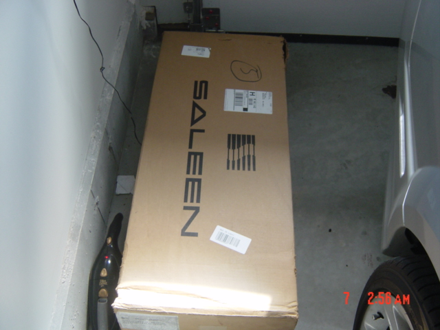

Part Arrived
The part arrived on time. As you can see it came in an authentic Saleen Box. You have to be careful since there are places selling fake Saleen suspension systems. I will do the install job on Monday since I got to take the kids easter egg hunting all weekend!
