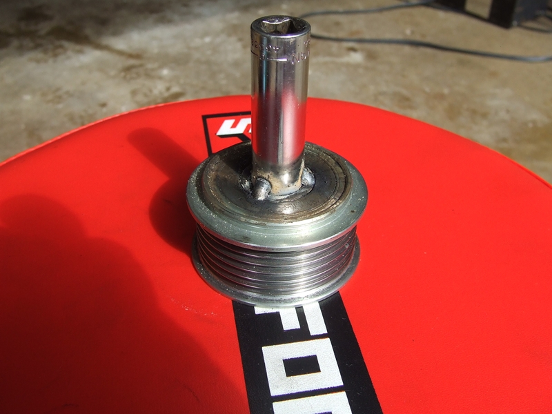

My major problem was Saleen forgot to include the tool to take off the stock pulley off the alt. yon need to turn the alt. 180 degrees and the stock pulley has a bearing that allows it to spin backwards with out engaging.
How did you ultimately get the pulley off? Is this something you could rent at autozone or buy cheap?
Attachment 34760
I used a deep wall 1/2 socket and tack welded it to the pulley, It came off easy. nobody have a tool, not even my Ford (Saleen) dealer.
