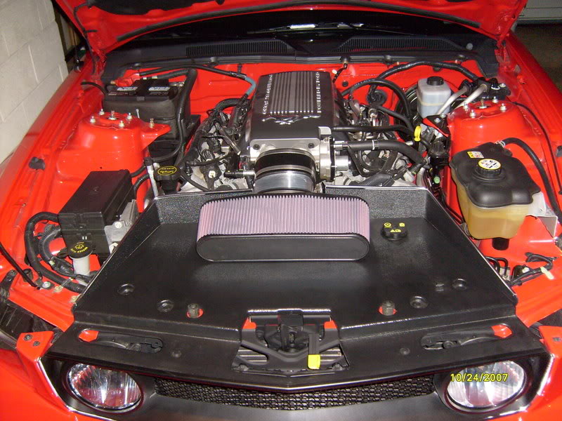

I don't see any benefit to trying to rig something up. The 2nd pic is the WMS air intake, which I have on my car. The WMS intake sits on a black plastic tray which does two things; 1) it creates a 'ram box' where air is brought in through the grille and 3 openings in the front of the box which is somewhat sealed against the hood insulator when the hood is down. 2) it protects against hot air from being brought in at the bottom of the intake filter. I took some adhesive backed heat shielding and trimmed it to fit the bottom of the WMS plastic tray to help even further.
As many of us are aware, a ton of air is brought in under the hoods of these cars. I don't think you need something special to bring the air in from underneath the car. You're creating a lot of extra work, then obstructing airflow to the radiator, and providing a pathway for the air to be warmed in while it's on it's way to the filter. The WMS design brings in a high volume of the coolest air and puts it directly to the filter. I'd stick with that, or get a blower if I truly wanted to 'ram' the air in.

A magazine did a comparo on them a few years ago. They were all pretty similar. The WMS intake took 2nd place if I recall correctly, but it lost points due to the install being more complicated than the others. I went w/ the 95mm intake on mine, and I can only say that from my experience, it outperforms the other ones.
