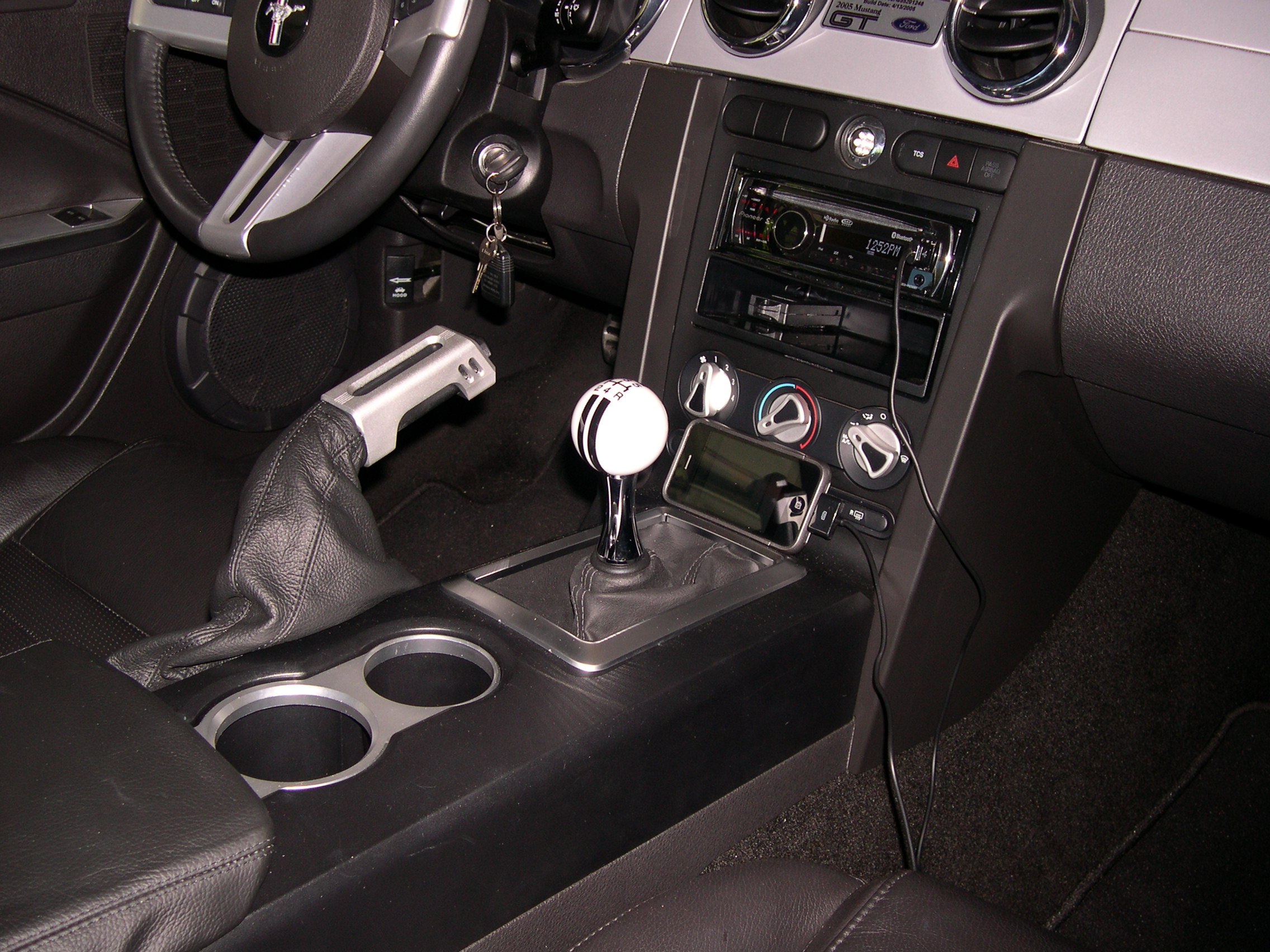

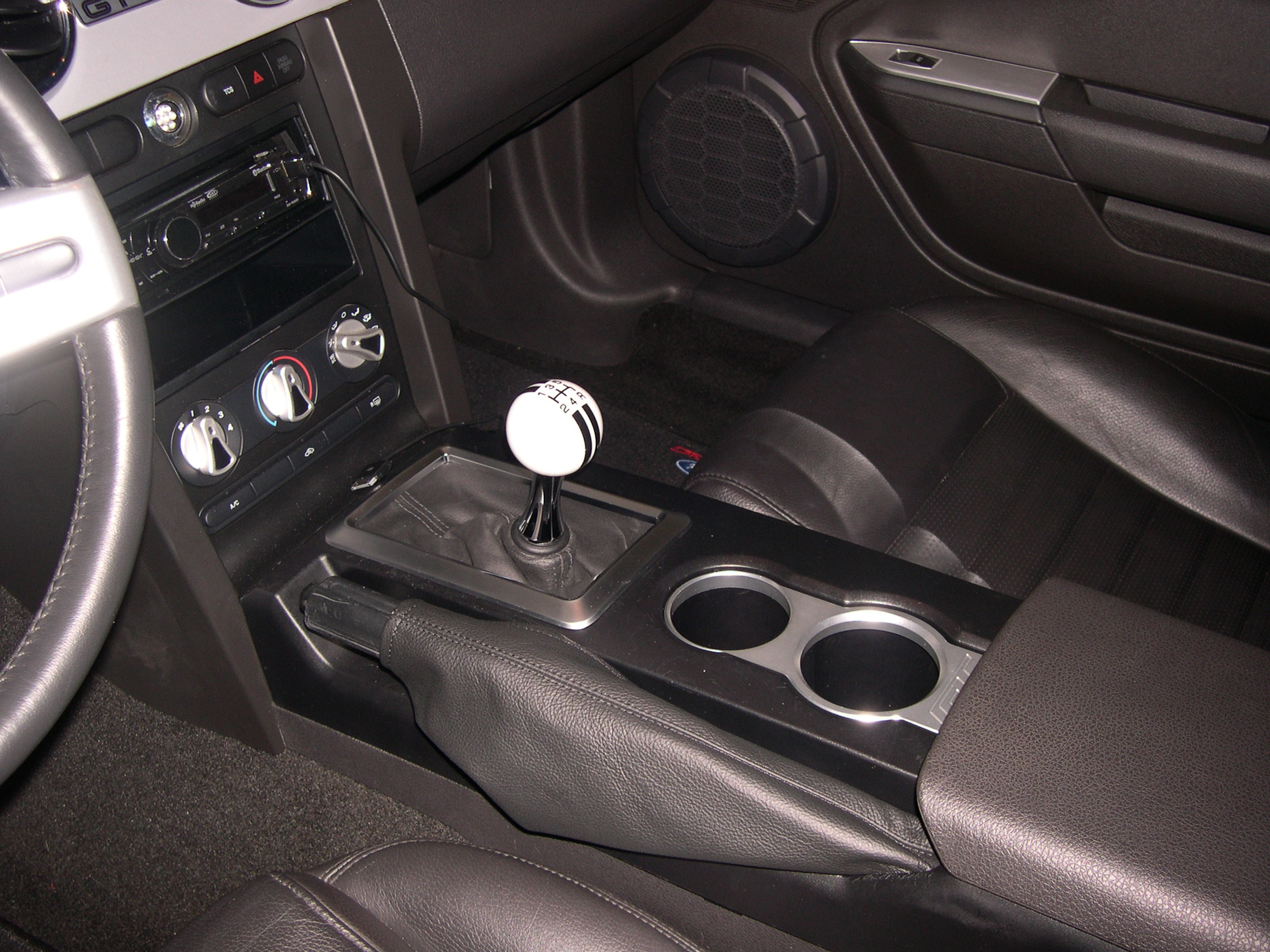

Well I took out the Pro5.0 today and put in the new MGW shifter that I bought acouple of weeks ago.
This is a very high quality piece. Kudos to George and MGW.
IMPRESSIONS:
Is it better than the Pro5.0, yes. The thing I think I like the best about it that it isn't notchy and the shifts are very smooth. I turned the shifter 4 turns out and the throw is about the same as the Pro5.0. You do have to lower the transmission brace so you can lower the transmission about an inch to get the trans bolt in. I had to take the hoop off my CHE drive shaft loop so I could get to the linkage. I also had to loosen the torque limiters to get the full inch drop on the transmission.
It took about an hour on a hoist not counting the time it takes to remove the console and attach the shifter handle and boot. The shifter comes with a CD and I wrote down all the tools that I needed prior to starting the install. I would suggest that to anyone before you do it.
Rich

Looks great Rich as I really like the new style handle and shaft
How is the NVH as compared to the 5.0??
I might just need to add this to my future mod list!

I really didn't get a chance to drive it much today but I'm betting that the NVH will be nil with the newly designed tail section.
BTW Pro5.0 shifter with Hurst handle and ball for sale $160 shipped. Nothing wrong with it.

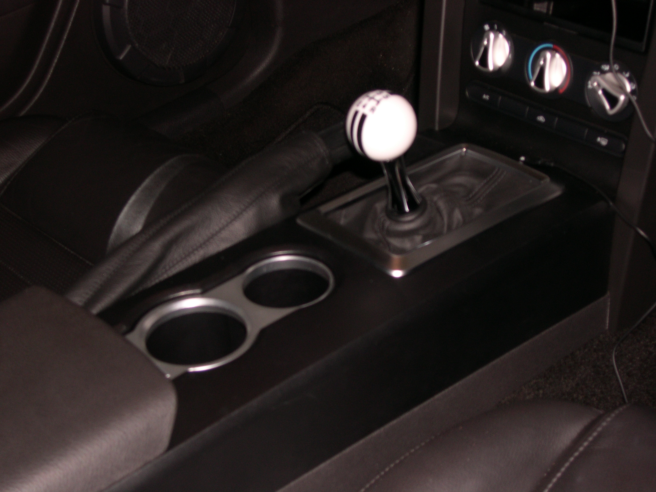

Now that I have had it in for a couple of weeks I like it even more. Zero NVH and it shifts smoother than the Pro 5.0. The only thing I don't like is that the ball is alittle too big for my liking. I ordered the OEM handle and will run my OEM **** for awhile. IMO this is the BEST shifter on the market! Better picture than the cell phone earlier ones.
OK George, you know where to send my royality.
