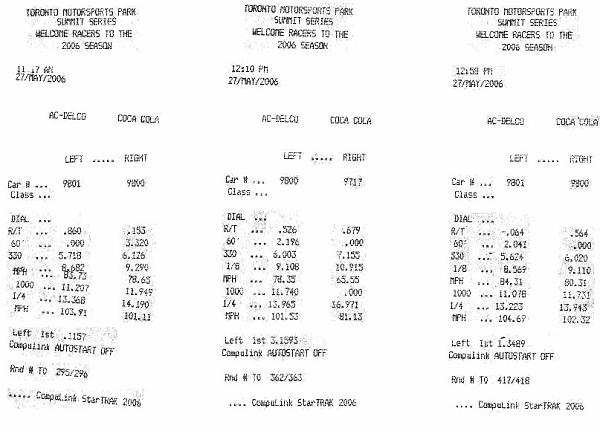

Guys,
This past saturday I got to take my car to the track. I got to do 2 or 3 runs on a cold night in september, but these were the first ones i've done during the day.
It was really hot and humid, so that would help to explain why my times were on the high side. A couple of other guys with '05's were running similar times due to the heat. We were racing from 11:30 to 1:30.. the hottest time of the day
I'll probably hit the track on June 16th in the evening, hopefully with some cooler air, i'll knock my times down quite a bit
I ran stock tire pressure and a 93 octane performance tune
Any comments, suggestions, criticism is welcomed
I am car 9800, my best time was 13.943 @ 102.32

Steve,
First thing I would suggest is your tire pressure. I run 22-24 psi's of air in the rear tires and pump the fronts up to 50. That will help your 60ft times. I saw you cut a 2.1. On a near perfect run with your mods, you should be able to cut a 1.9X short time. Also try shallow staging in the lane. This will help a smidge with both your ET and trap. Other than that, you could remove the front sway bar and spare tire to pick up a little time.
Also, what elevation are you at? When I had similar mods as you I was able to cut a 13.208 @ 106. My local track is at 600ft.

Nice runs. It looks to me that the slips didn't record your 60' (if you are #9800). What are you shifting at?

I turned a 13.678 @ 103.3 in my stock 2006 GT with manual trans and stock tires (18 inch wheels). What are your launching RPMs and where are you shifting? Also, did you go through the traps in 3rd or 4th gear?
I've been launching at right around 2000 and shifting at 6000, ending the 1/4 mile in 3rd gear. At launch, I need to feather on tha gas slightly or risk too much tire spin. DRs would help.

I was launching at a little higher than you, at about 2500 rpm. The track was pretty sticky and hot with the sun, at lower RPM's I was bogging it.
I was shifting about about 6 grand as well... I tried to shift into 4th by the end of the track.
I think the very high humidity that day contributed to lower e-t's
